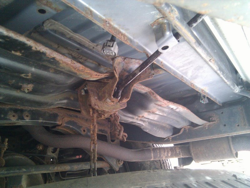

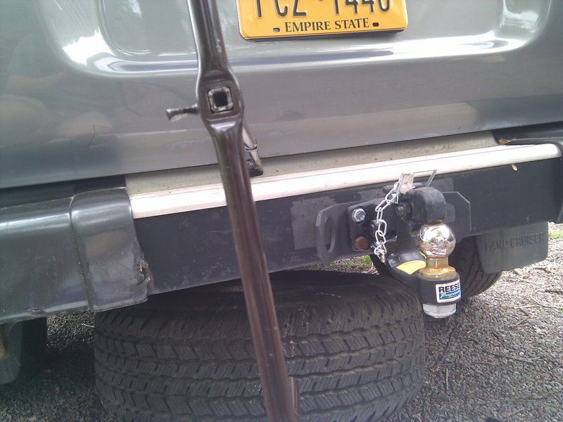

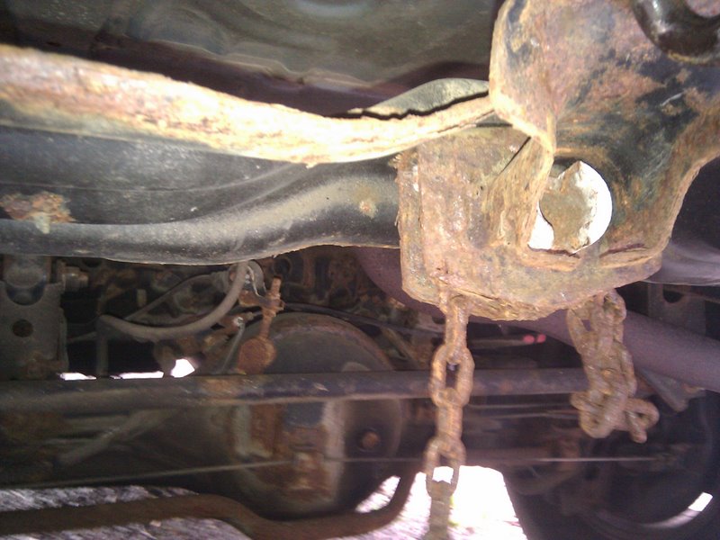

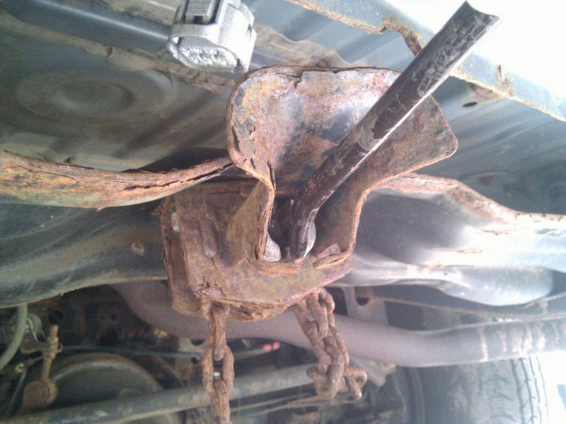

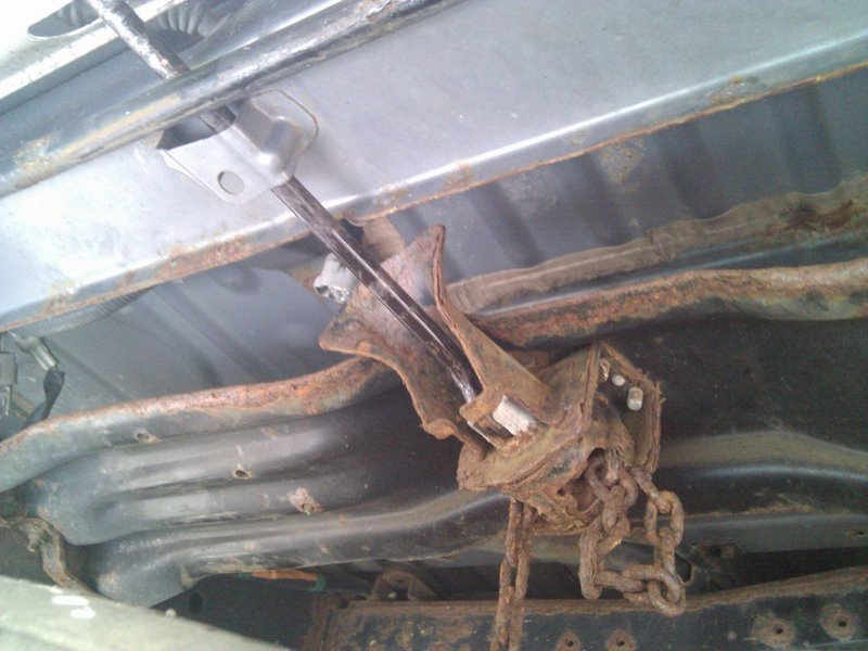

Was scratching my head about this one, I couldn't see the keyhole from the slot in the bumper, but with the recommendation to "keep right" it worked out OK. I don't think the PO ever lowered the tire, lots of creaky sounds. Any comments on the rust are welcome. :)
Here are some pics to help the next guy, note that the tool mechanism is at a pretty good angle to the bumper.
Yeah, I don't miss NY for that reason alone!
If you're up to it, I'd try taking a wire brush and some grease to it, just to see if you could get it moving a bit smoother.
Lots of members (especially those that go to above a 33" tire or get rear tire carriers) get rid of these, I'm sure you could snag up a used one from a non-rust belt state.
