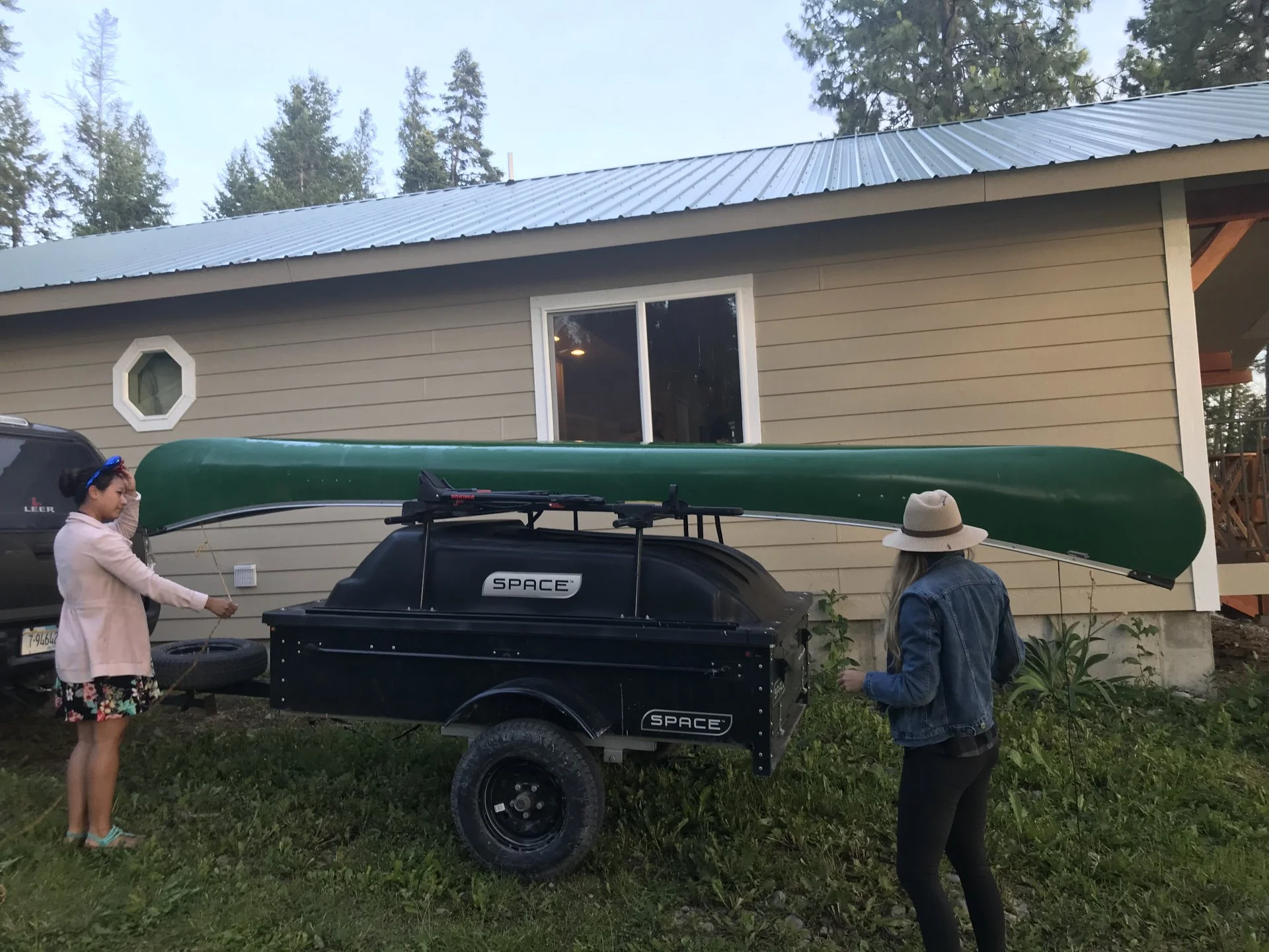

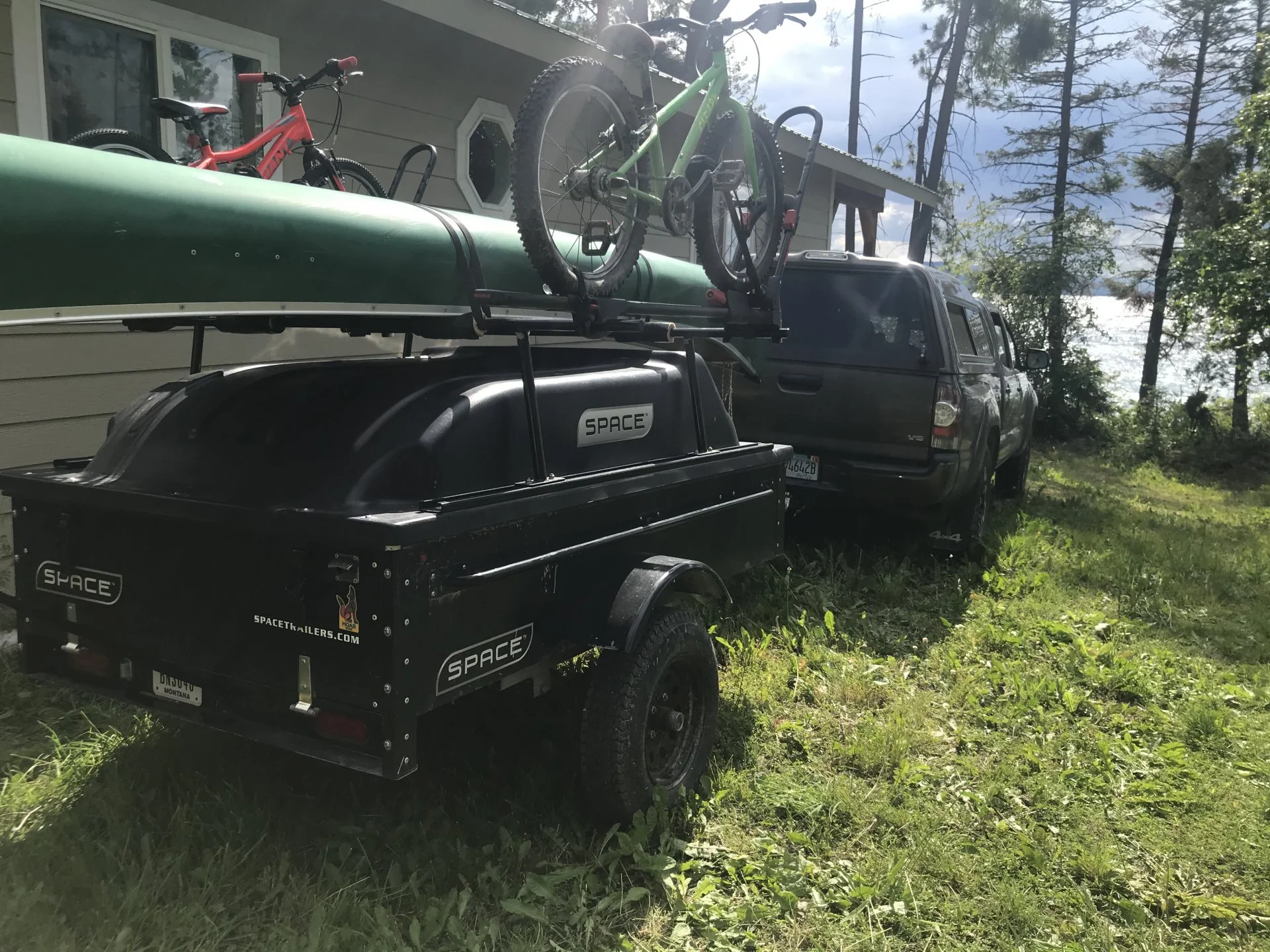

haven't seen a whole lot of references to SPACE Trailers and even fewer actual owners on mud, so I thought I'd share my experience. We purchased ours back in 2016 when we were rocking a Subaru Outback and needed more room to haul stuff on extended road trips that we like to take. We bought the "LowRider" model since we had the Outback, with the extended tongue, luv handles, and space bars. Here it is shortly after we got it embarking on a month-long road trip around the Western U.S. to bike, hike, camp, and visit friends and family along the way.
The trailer served us well on that first road trip and several shorter trips in 2016 before we bought a 2012 Tacoma in 2017. The LowRider model is exactly the same as the HighRider, the axle is just on top of the leaf springs to make it lower. When we got the Taco I flipped it to below the leaf springs to level it out a bit. Super easy conversion.

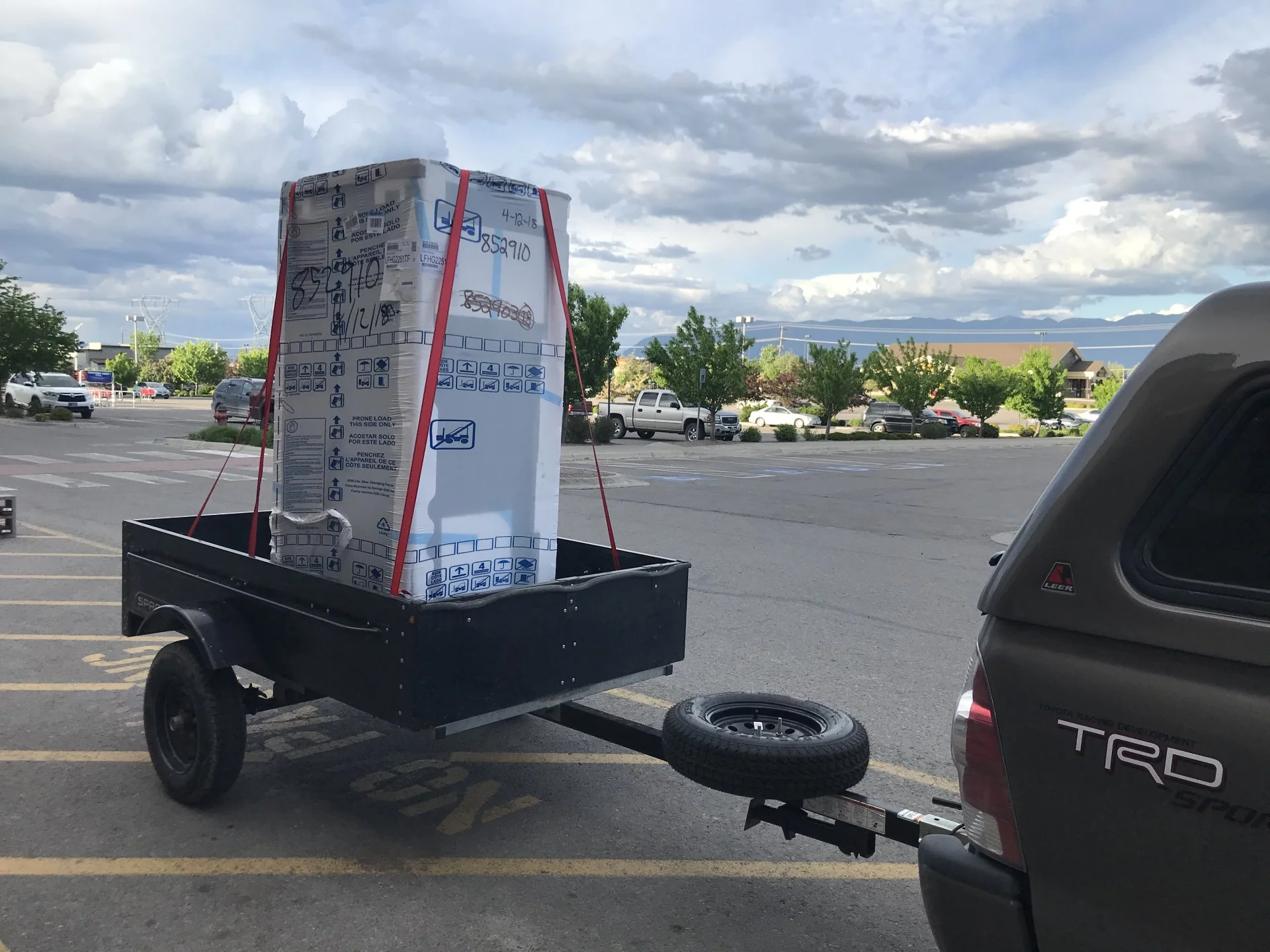

I said it holds a ton of stuff... not literally though. One time I took the top off and went to get a load of gravel. I didn't really think it through and bought a yard. As soon as the loader dumped the gravel in I realized I may have overdone it for my little trailer. These trailers have a 1,000 lb load capacity. Turns out a yard of gravel is 2,500 to 3,000 lbs. I kept it under 55 mph on the way back home and made it.

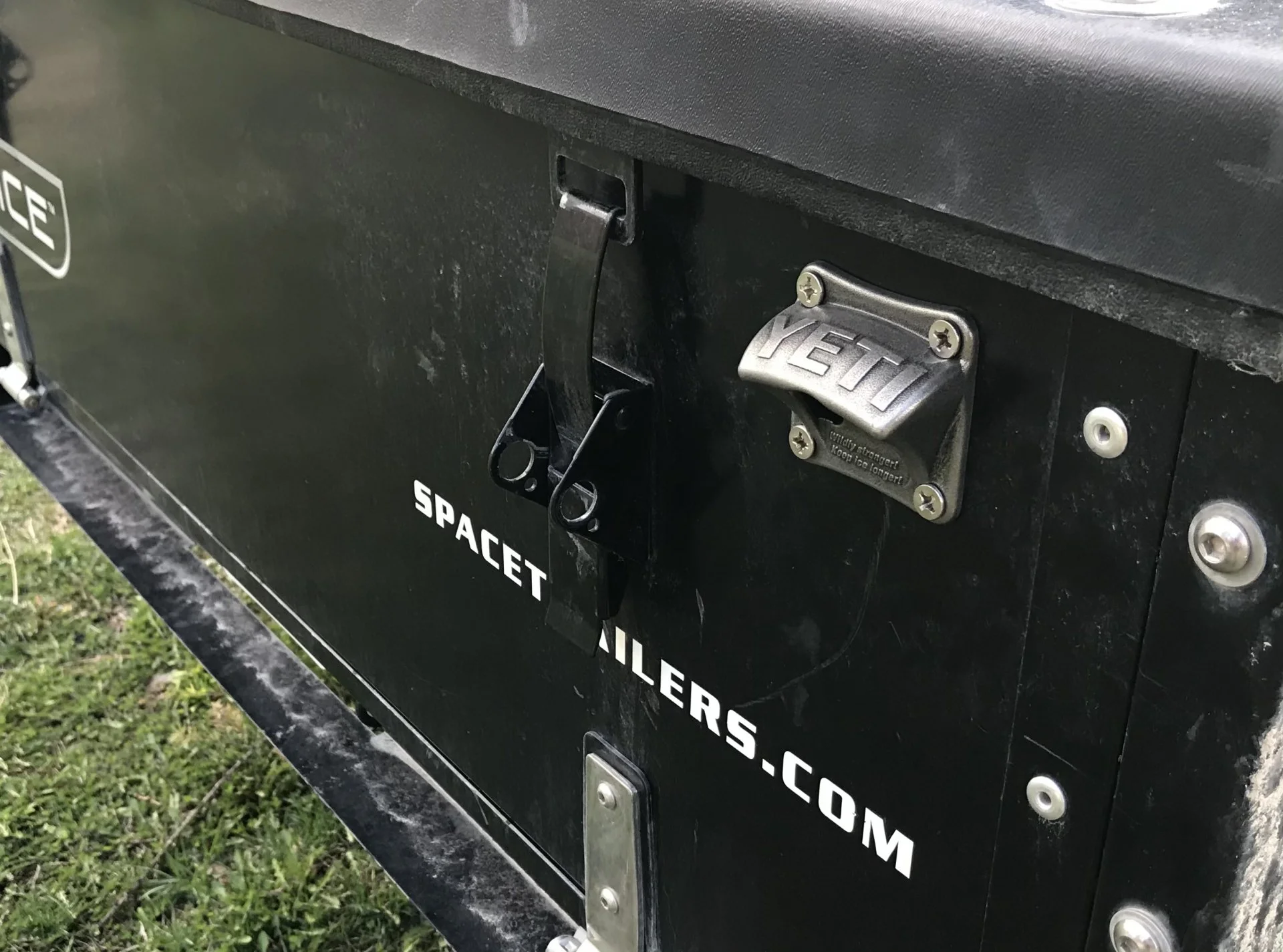

With the love handles, is there some kind of structure on the inside of the trailer that reinforces the attachment? I see them as a place to attach ratchet straps or whatnot, but I was suspicious that they can't actually resist much bending if they're just riveted to the sheet metal. But maybe the sheet metal is very thick, too?

On the luv handles, they are bolted to the sheet metal at four locations, four bolts in each mounting point. No internal reinforcement, but the structure makes them plenty stable. I've used them to strap stuff on. I would note that they are too big around for the hooks on most ratchet straps, so you have to run the strap around them. You can also use them to lift the trailer and move it around by hand a little bit if needed.
I have found that the load bars themselves are more convenient for strapping stuff down because you can still open the trailer up if you strap there. With the top off there are tie down points on the floor of the trailer that you can use. I would say I could live without the luv handles tbh.

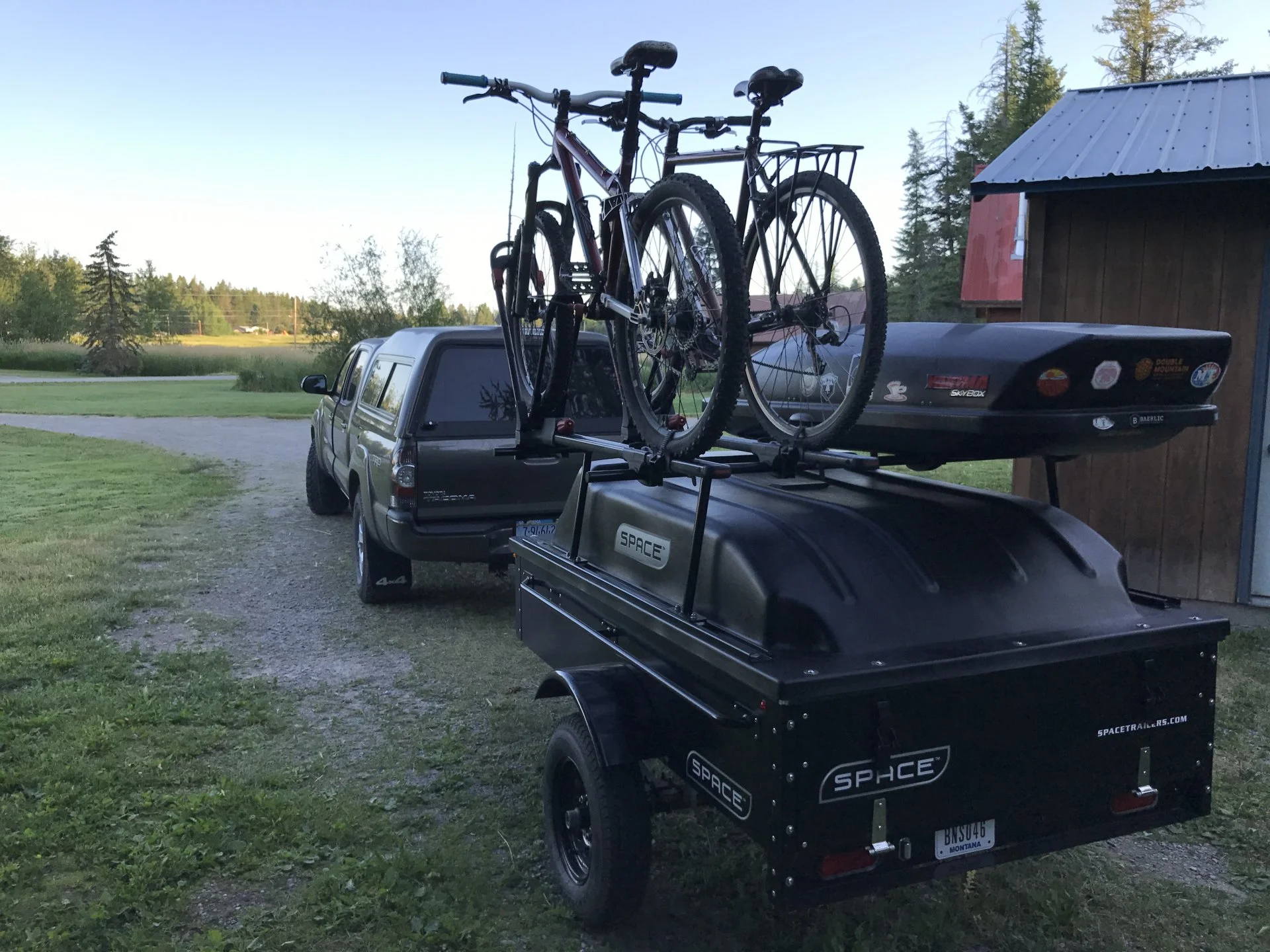

It tows great at 65 to 70 mph. I've even towed it at 85 or 90 on our 80 mph freeways here in MT with no issues. I have the standard 13" wheels and tires, but I see these days there's an option for 15" wheels and tires. I'd probably go that route just for better clearance and even more confidence at speed.
I get about 19 mpg on the highway without the space and about 17 mpg with it loaded up with camping gear and bikes on top.
I did get the 12.5' long neck. The tongue on it sticks out about 5.5 feet from the front of the trailer. Turning is no problem and the longer tongue makes it easier to back up.
