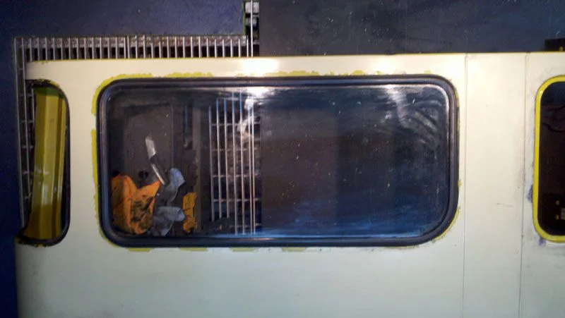

Starting to work on the troopy hard top and removed one of the sliders to take measurments. According to SOR, their replacement slider windows measure 16" x 34 3/4" vs. the troopy window which measures 16 1/8 x 35 7/8". It would be helpful to have one of their units in hand to see if it were possible to make them work. The additional 1/8” in height may fit into the recessed opening. The extra space in length could potentially be filled with sheet metal.
Also looking into window manufacturers in the boating and RV industries for window quotes. So far, everything well exceeds what SOR charges. I asked SOR for their supplier but they would not give it out.

The troopy window opening is 1/16" bigger on each side if you center the window in the opening. How about wrapping a piece of wire or plastic strip (hobby shops sell plastic in sizes that would work perfect) around the window to keep it centered in the opening. I'm pretty sure the gasket will still seal that small of a difference... Heck, the SOR window will probably work as is. Pull a window out of your 40 hard top and measure that opening; bet they are the same.

Remember that the sliding windows don't fit inside the opening as the pre-'76 glass windows do, but rather sit on the outside of the window channel. This could explain the sliders seeming larger, but I bet the opening itself is exactly the same.

I was able to install a '76 style hard top window into the troopy hard top window opening.
Next step is to order a set of SOR sliders to see if they will fit. SOR says they will not fit properly and will be too loose based on their measurements, but maybe a little fab work will do the trick. We'll see...
