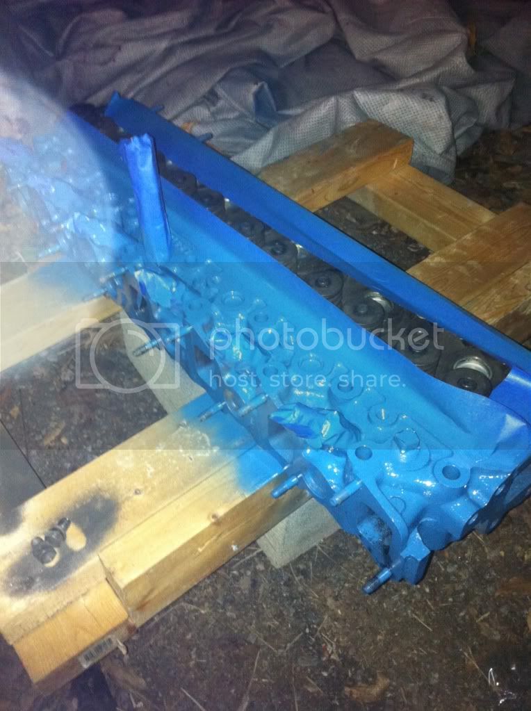

Sunday Update.
I pulled the head this weekend.
And here is what I found. The number 2 compression ring is worthless. The ring lands don't look too bad but they are out of spec. The other pistons look much better but the cyclinders are still in spec so that saves some trouble. The bearings look great too.
I did the seafoam treatment twice and I guess it just couldnt break this up.

How many miles has it done, knowing how badly the top rings wear on these, I would be suprised if the wear at the turn around point wouldnt neccesitate at least a first size overbore. Having said that, I did do a cheap and cheerful 12HT build where I honed all the marks out (was over max spec on piston to bore clearance), fit new std alfin pistons and filed back oversize rings (another real no no). Actually, this engine is terrific much to my suprise. Not bad for a 1 day and $600 excercise.
Supposedly the engine should only have around 170,000 KM on it. Seems low for worn ring lands. PM inbound.
