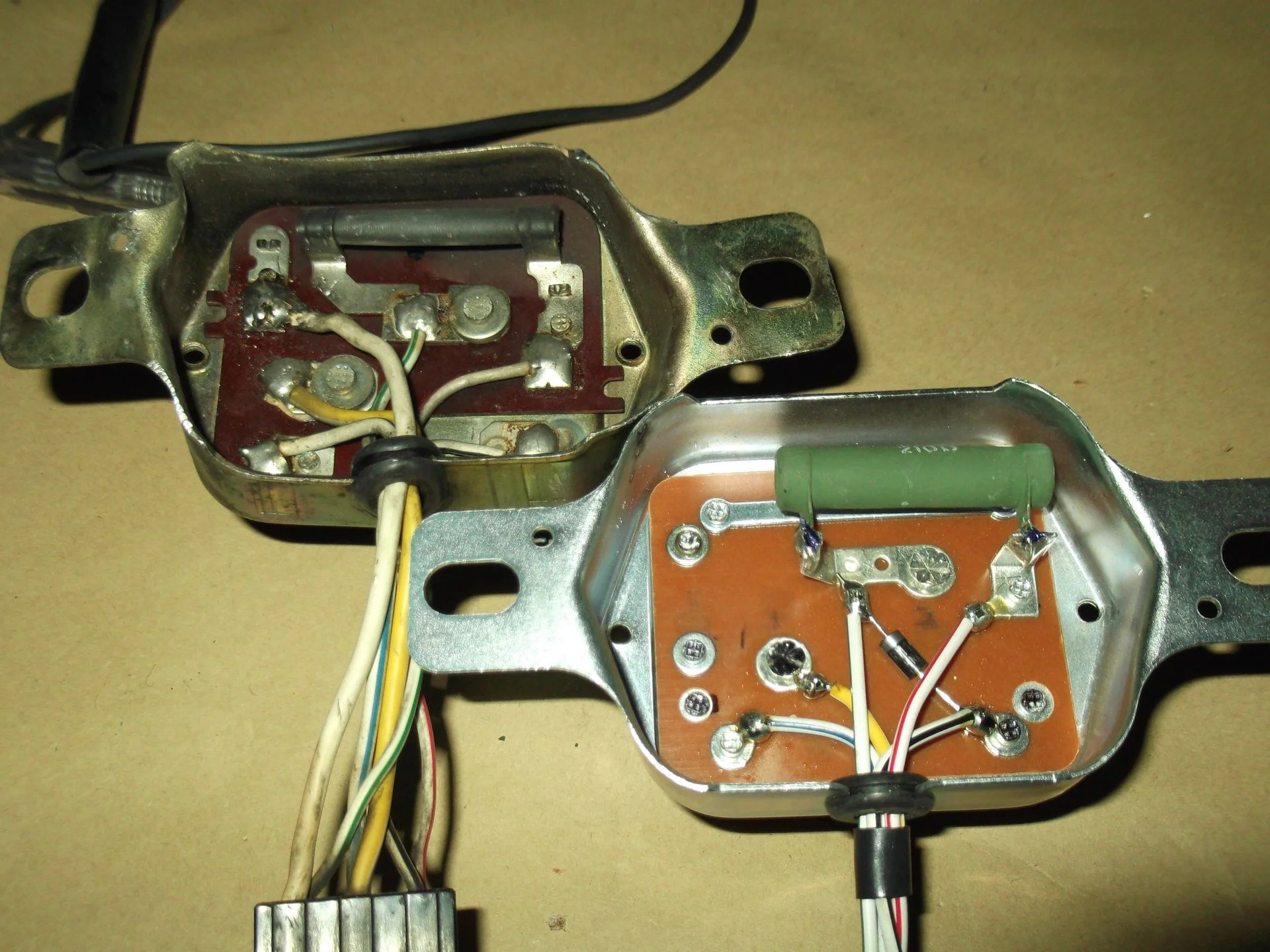

I posted earlier that my ammeter is suddenly way in the plus side...and bouncing around. I opened up my regulator and it LOOKS fine. Not gummed up and the bar moves freely. No signs of any burning. It's not particularly old but perhaps it got fried internally. I read all Rudi's stuff but in the field it's not so easy to test. Cleaned all the contacts and ground. In testing the alternator, I put my voltmeter to the B connector and voltage is fluctuating ALL over the place from 16 to 4 to 8 to 13 to 15 to 14 to 7 etc.... All in the matter of 5 seconds. What the hell does THAT mean? Variety is the spice of life? I'm assuming it means it's fried in some way, and this also makes sense that the ammeter is bouncing all over.

Thank you, Rudi. I have cleaned all the contacts on the fuse block and VR and have taken apart the VR and run a little 1000 grit paper over those contacts inside though they were super clean (VR is only a few years old and has seen very little use). I tried my best to clean on the alternator, too. How can I clean the contacts both on the harness plug and on the alt for the F and...is it E? input? They are a little crusty. I will say my fuse block is pretty gnarly looking after near 50 years. It's sort of coming apart. I wonder if that's an issue though checking the voltage there did not reveal any jumping or fading out.

Well I don't know what happened..... I cleaned as many contacts as I could. All VR contacts, NEW alternator, cut new battery cables and cleaned all the contacts. Sanded fuse block contacts. Opened up VR again and saw nothing, dropped some screws on the ground. Closed it back up. DId some other crazy stuff I can't really remember. Voltage was still all over the place and would slowly climb at idle (reading from B) from 12 slowly to 16.

So, Rudi, what do you think was going on? The only thing I can conjure is that even though I had taken apart the VR and all the wires off and polished all the wire fittings and connection posts, somehow there was still not a good connection. When I took it apart a second time and reattached everything, perhaps that time it DID get a good connection. The second time I had it open I did spin back and forth a bit the paper wrapped cylinder (dynamo?) noting with surprise that it spun and was not firmly anchored. Is there something to this?
