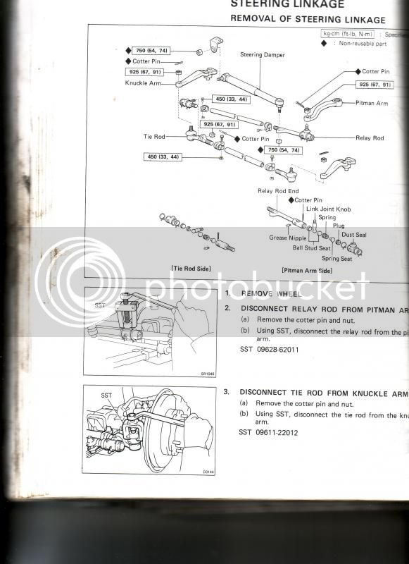

If that part was broken on my HJ75 I would have no steering at all [however I could be misinterpreting the part from the pictures. Most Toyota systems on 4WD have the bar with a tie rod at each end connecting the wheels and the secondary steering rod coming of this shaft goes to the steering box on the chassie or to a steering idler [when mostly power steering is not used. I will scan a 75 series as it may help you get a better understanding. cheers
This will not be the same as your set up however you should get the idea of what part does performs each function and how the wheels are coupled together with an intermediate rod and tie rods. And are then are moved by the steering box [or idler] rotating a pitman arm or similar and the other end of the relay rod which is connected to the longest tie rod with a hole section where the relay rod connects to the tie rod and at the other end to the pitman arm.
The steering damper usually connects to the relay rod and a point on the chassie. The dampers function is only to reduce shock in the steering and this reduces kick back in the steering wheel LOL ask blokes who have had a death grip on a hj/fj45 on rough rocky trails= dislocated thumb LOL.
