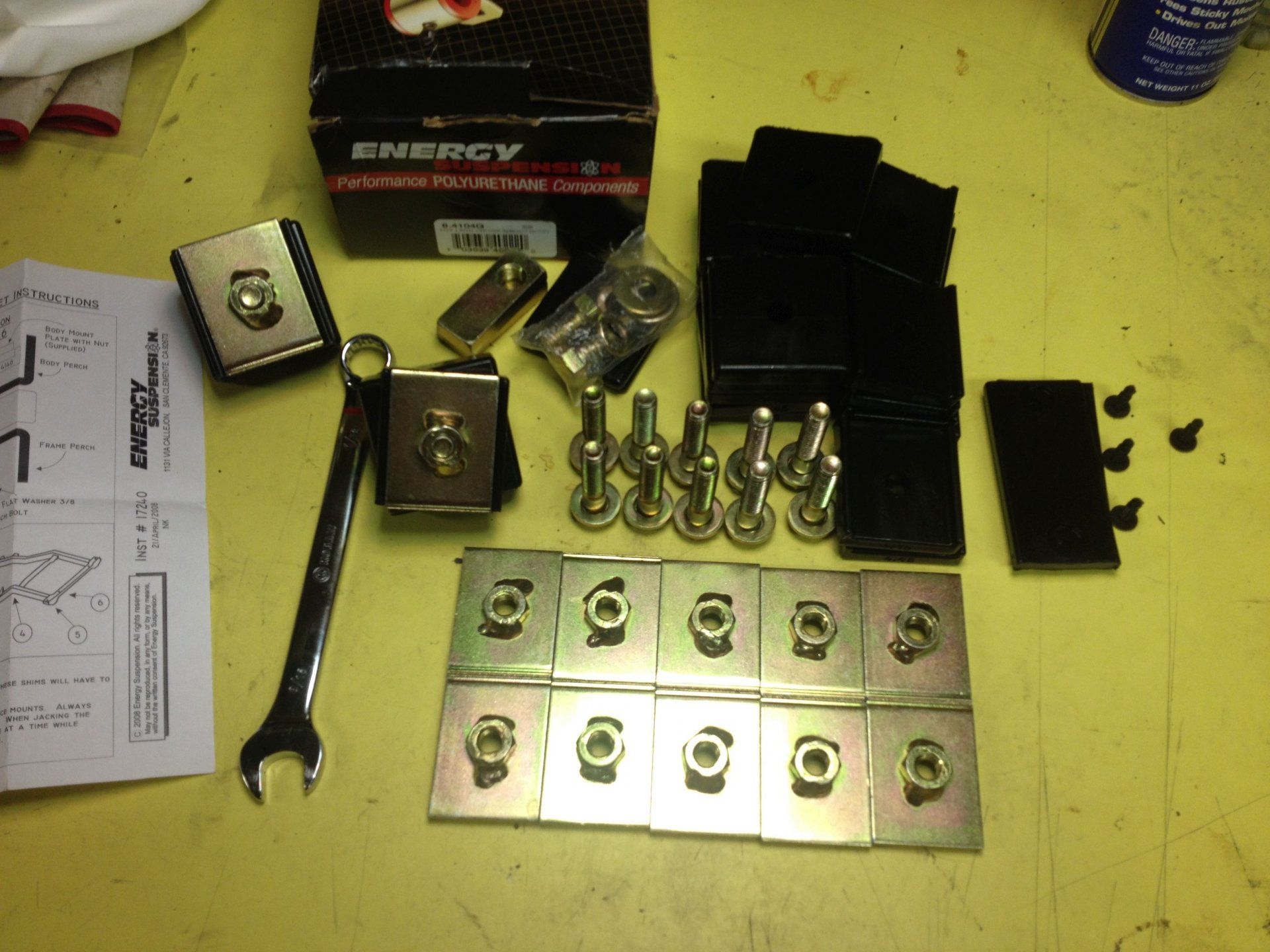

found what looks to be a great option for body mounts boat roller stock cut down thanks to @lowtideride

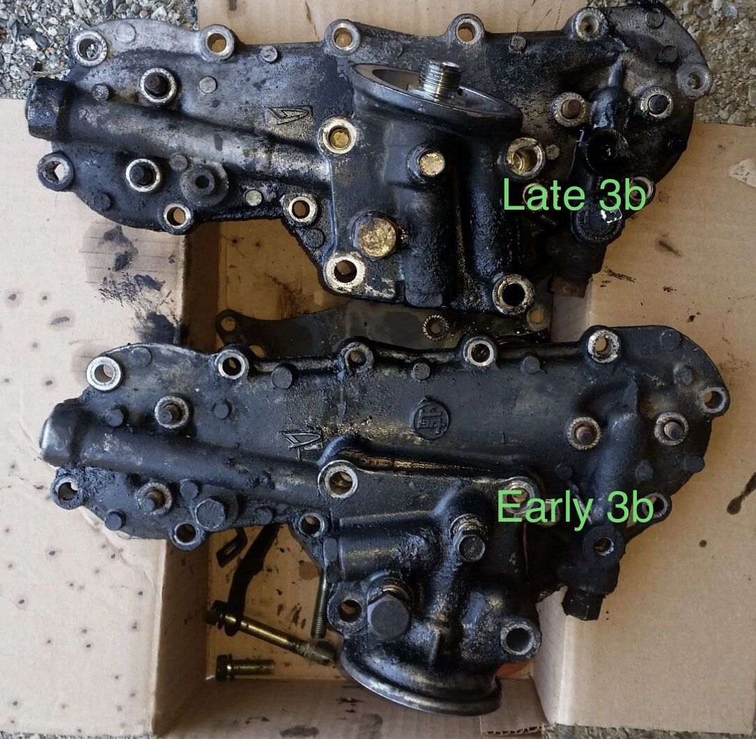

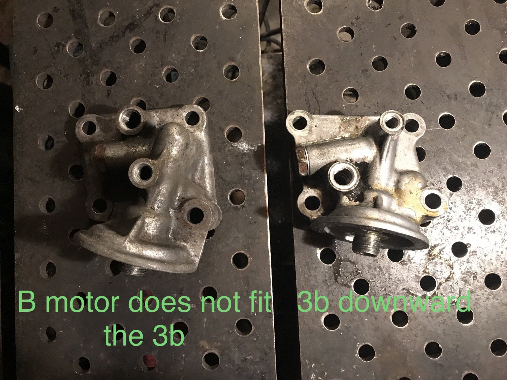

Oil filter housing gasket for the 3b 15691-56031
Swapping my oil filter orientation on my 85 3b form point up to pointing down the way the early 3b filters were more clearance for the turbo.
If anyone else also wonders if a b motor oil filter housing will fit the 3b I checked and it won’t.

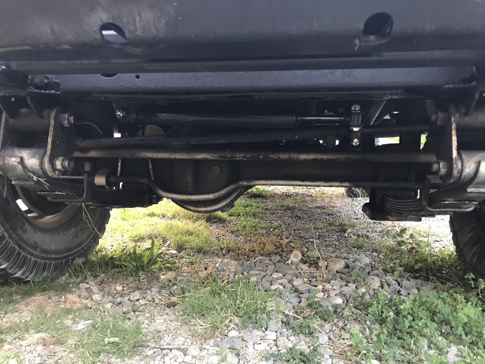

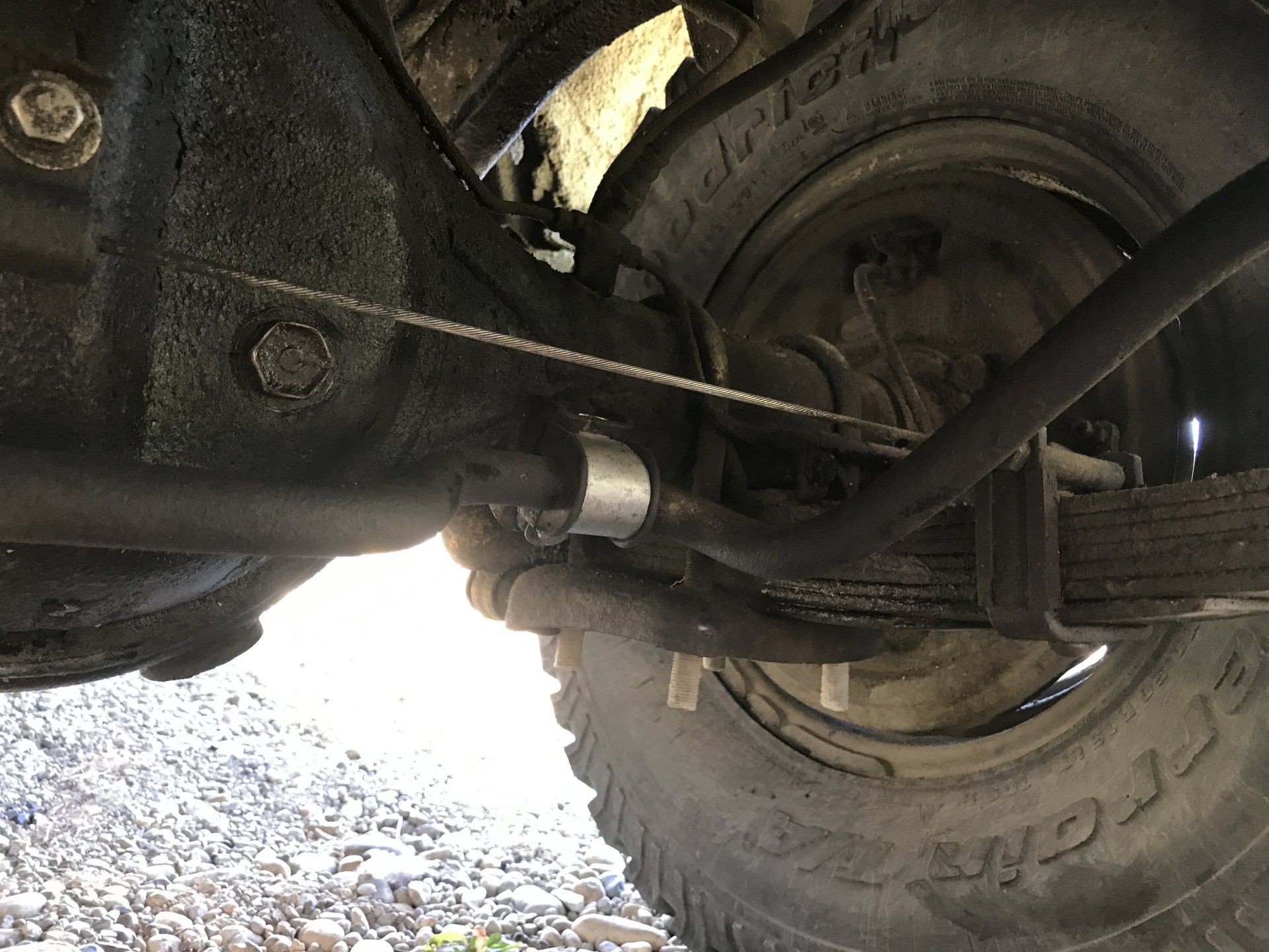

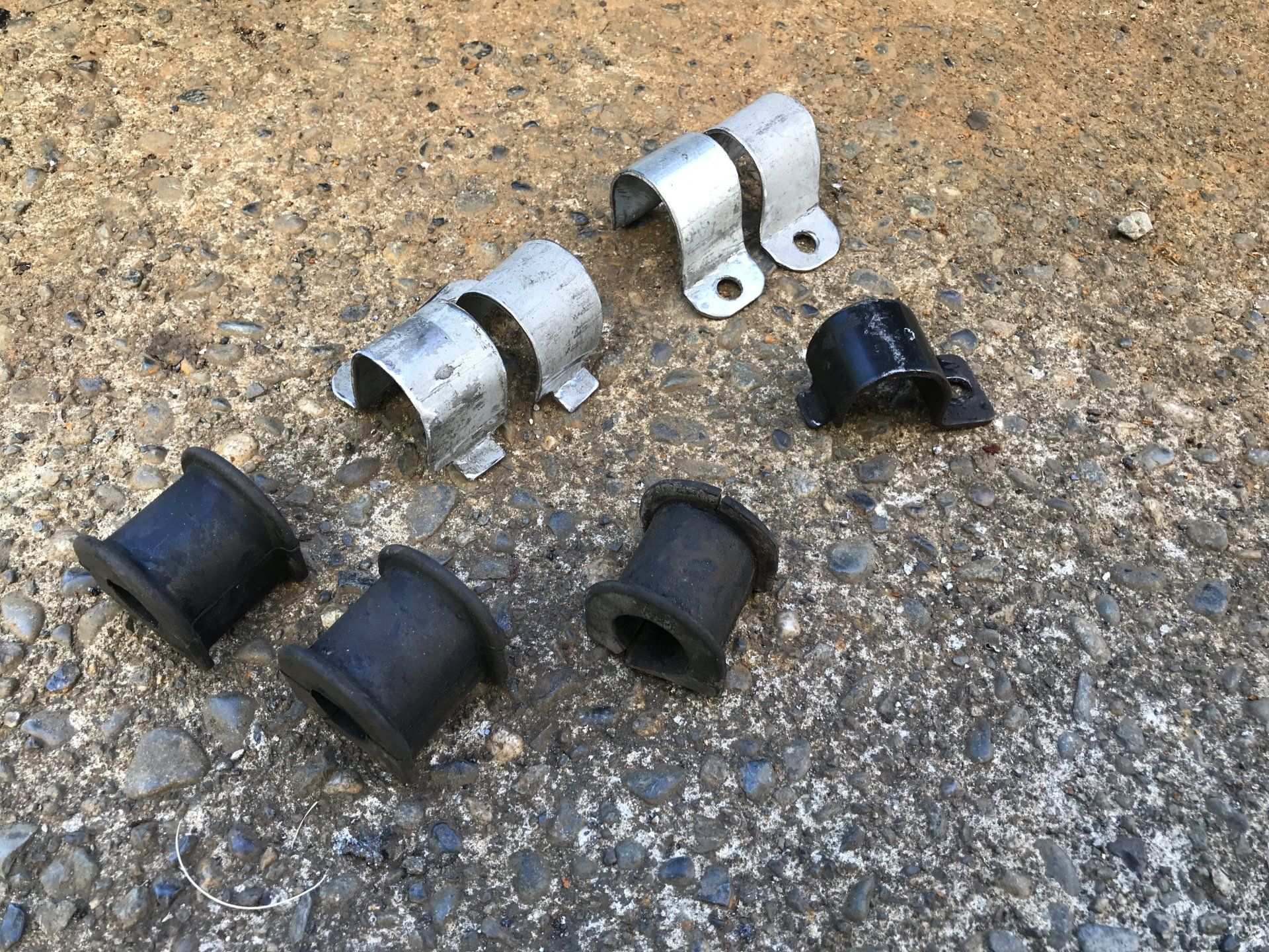

Last winter I ripped one of my rusted sway bar axle clamps. The new replacement bushings I ordered part number 48815-10090 ended up being slightly more rotund than the original. The original clamps were about 1/4 inch too short to fit over the new bushings. That’s is ok because I couldn’t find the clamps anyway. This left me with no choice but to make new clamps.
