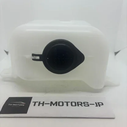

A skinnier version with the same mounting tabs that is currently available from a variety of sites for anywhere from $50 to $80.

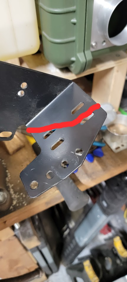

I pulled out my old Delta VS relocation bracket and found it was very close to fitting. I cut it up a bit and while I could make the bracket slot into place, the washer bottle is going to be tight. The original fat washer bottle fits with some heavy persuasion.
I've cut across the bracket where the red line is. I will have to move the diag port to another location.
I successfully installed a Toyota windshield washer fluid reservoir using the Delta VS relocation bracket.
The bracket had to be modified to fit in the cramped location and I couldn't use the OE Fat fluid reservoir.
The part of the bracket that holds the diag port and the main engine harness prevented the bracket from mounting.
I continued to cut the bracket down until it finally fit in the space. The final cut look more like this.
I purchased this from Amazon
Toyota Tacoma Windshield Washer Reservoir 1995 96 97 98 99 2000 | Small tank | 2.5L | TO1288134 | 8531504040
www.amazon.com/dp/B08GM75CKP

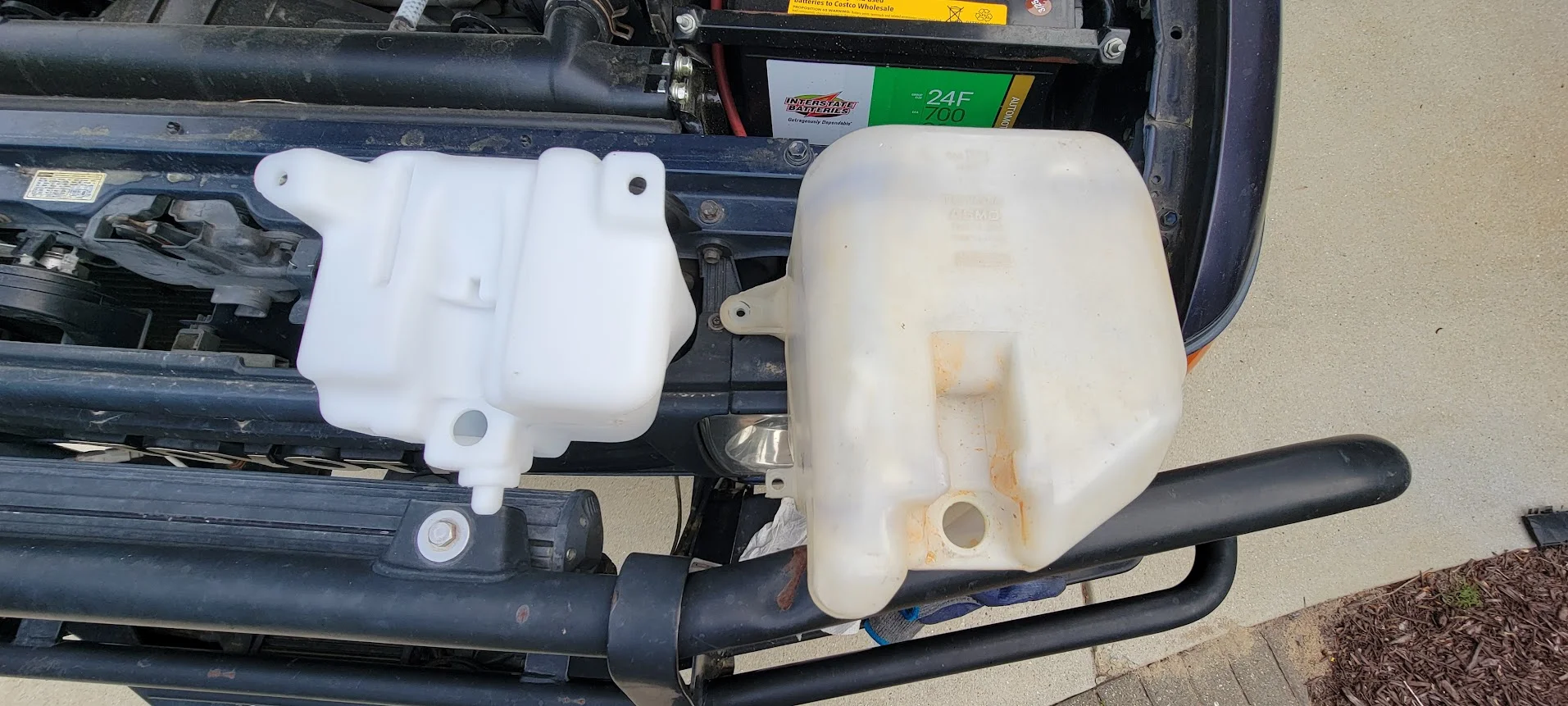

Compared to OE Fat reservoir

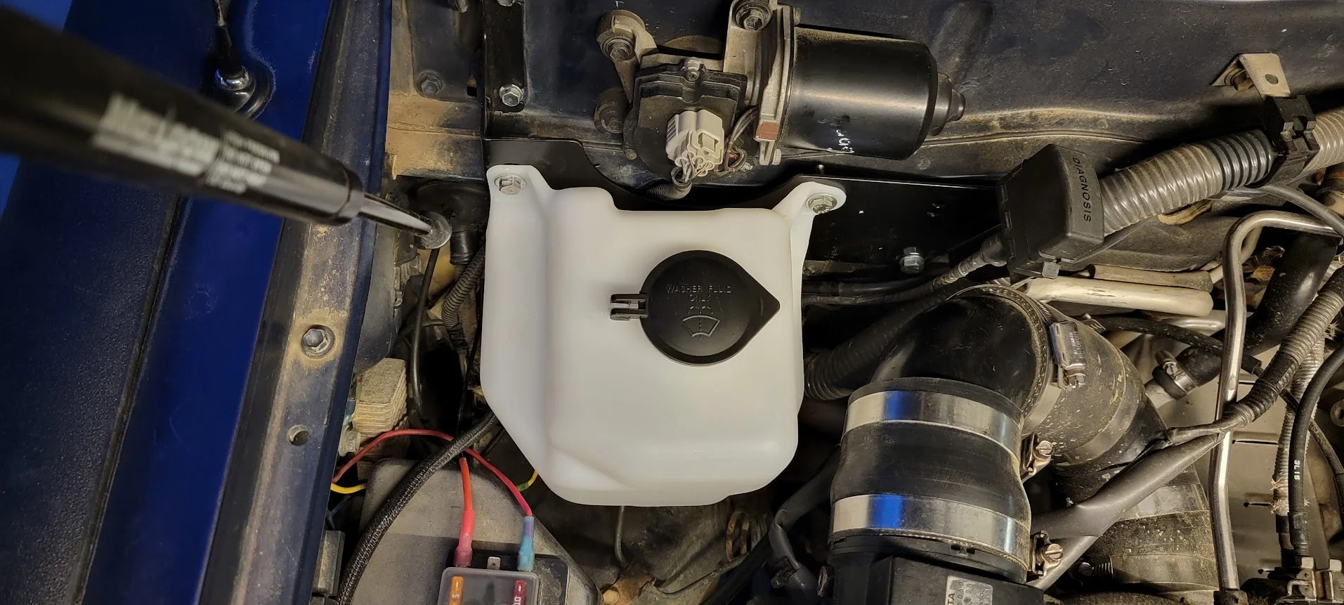

I moved the original pump from my fluid reservoir to the Tacoma reservoir. The rubber seal has the same external diameter but a different internal diameter for the pump.

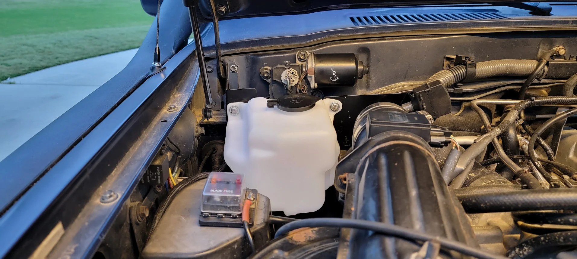

With the Delta bracket clearanced and finally installed, I made electrical and water connections to the pump and mounted the Tacoma reservoir to one side of the bracket utilizing the original mounting hole on the passenger side. I drilled a second hole in the bracket on the drivers side of the reservoir.
I drilled out the bottom of the slot on the Delta bracket to fit and M8 bolt to mount the Diag port. In this photo there is a 1/4" clearance between the Delta bracket and the intake pipe. The Diag port bracket needs to be trimmed as well.
Final image shows 3/4" of clearance around the washer fluid reservoir.
