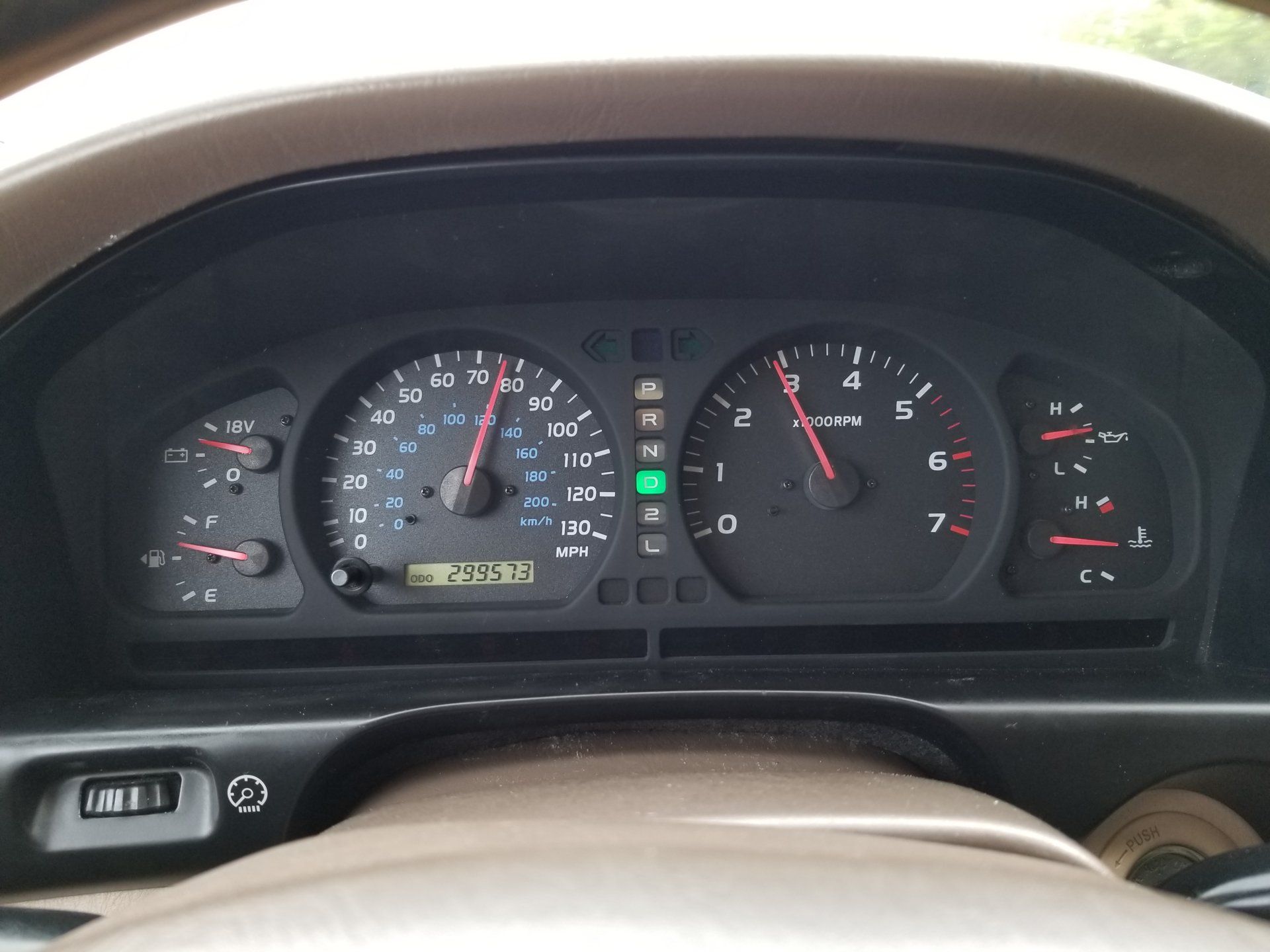

Photo of VSS that was replaced and photo of fully operational gauge cluster (now fully functional alternator not shown)

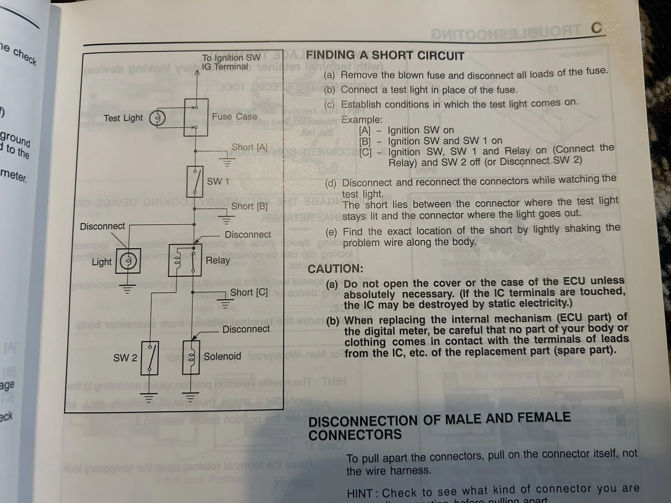

Homemade test light that greatly helped troubleshooting shown for anyone not familiar

You’d plug the light into the 15 amp gauge fuse slot. It should be lit. Start unplugging electrical connectors and when the light goes out indicates you’re on the trail on the shorted circuit. Your alternator may not be bad as it will not charge the battery when the 15 amp gauge fuse is blown. For the light to diagnose the alternator you would need to be able to unplug the alternator with the light connected to the fuse holder

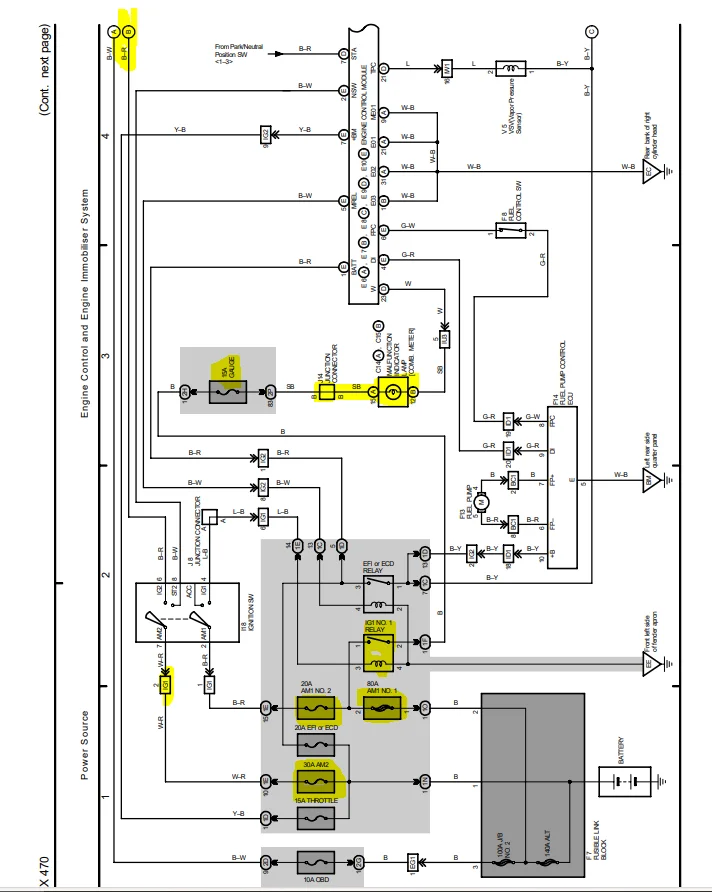

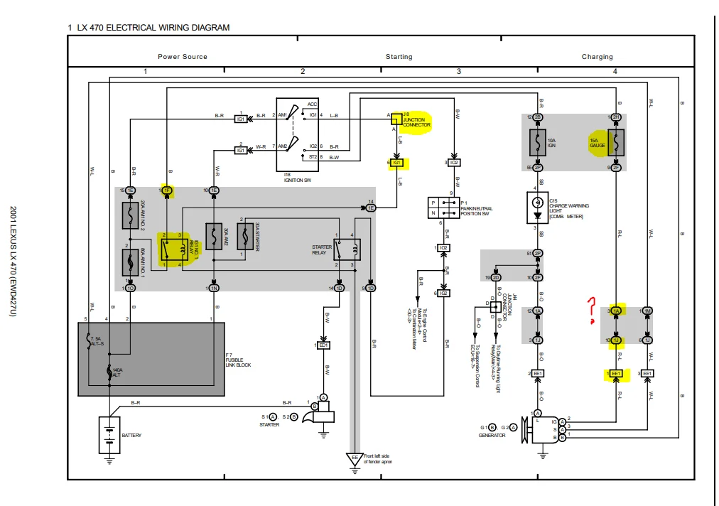

This is from the electrical wiring diagram for 2001 LC.
Replaced the alternator with a Toyota reman. Got a few miles from the house and the fuse blew again. Replaced the fuse and got home. It blew within a mile on my way home. I drove home on the battery. I replaced the fuse again to try to troubleshoot, but now the fuse blows the instant the key goes to ON. ACC is fine, but the second the key turns to ON it blows. I made the test light connected to the fuse to try to troubleshoot, but I have no idea what is connected to the gauge fuse. I don't know if I have the right schematic. But even if I do, I don't know where things are located to start unplugging. How did you guys know where to start? The VSS seems to be the culprit of the gauge fuse for a lot of folks, but I'm not getting any codes. I unplugged it and the test light stayed on. I also unplugged the trailer wires thinking that might be low hanging fruit to check, but the light still stayed on. Does anyone have a list of things to start unplugging to test? I'm mechanically inclined, but not very electrically inclined. I don't know what half of these thigns are... Any help would be greatly appreciated.
