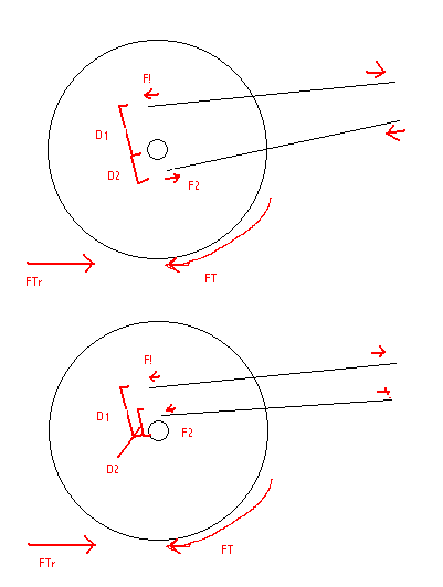

I drew a quick pic to in paint for illustration.
Basically the leverage is created by the distance (D1 and D2) from the axle center rotational point. The further the distance the links are from axle centerline the less force (F1 and F2) required to hold the axle in place to transfer the power to the ground.
The top pic shows traditional links, the bottom with lowers above center rotation.
Now I drew the up and typed quick and don't have my chassis books in front of me so I could have all wrong :D , and there are many other forces involved not pictured (equal opposing forces, and the angles of acting forces on the angles of links, etc...). I also don't know for certain if the force in the bottom pic is full rotation about the axle centerpoint or if some of it is split due to the axle trying to rotate about the upper link frame mounting point. Hard to say without testing, but changing the location of the lower link from below axle centerline to above does change the force effects on the lower link, amounts I am not certain of.

Reuben, you have the general forces correct.
Toyoland has it exactly backwards ;)
The forces are created from the axle center by the tires. not from the link mounts. no matter what the orientation or the mounting points the forces seen by the link mounts where they mount to the axle remain the same (with similar traction and skinny pedal) the location of the links in relation to the axle centerline will only vary the force seen byt the links. Not the forces generated by the axle.
So I ask. Why can't 3" of vertical seperation sufficiently control axle wrap (given the links are strong enough to hold and the frame mounts are strong enough)

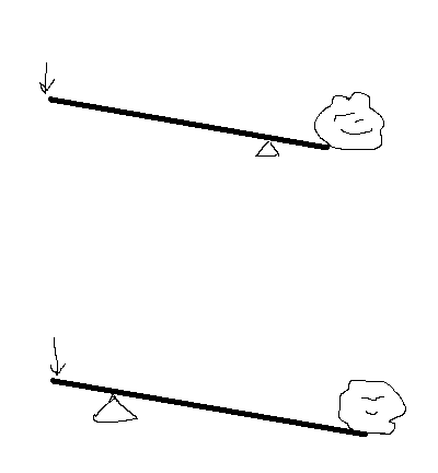

Here is a perfect illustration, thes are the exact same forces that would be on an axle trying to control wrap.
Tell me, which scenario would exert more force on the boulder

You are correct to say that you could build a system to be reliable with a small amount of verticle seperation, but everything would have to be built stronger to reliably contain the extra force exerted
And having those forces in this case traveling into a link mount that is basically a lever on the frame......
And yeah, both setups will control axle wrap, but for how long, especially when in this case the components arent exactly very "heavy duty"

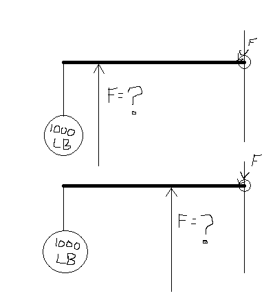

I'd like to hear the discussion of link seperation in terms of the picture I made above. If the distance from axle center of both setups is identical, what difference in the force is seen by the links that one would fail more than the other?

I was holding back this setup, if axle seperation is the same with the above/below and the above/above they should react the same, direction of force on the links changes between the setups. Now this is assumeing that there is one axle mount per link, not two links to one axle mount.
