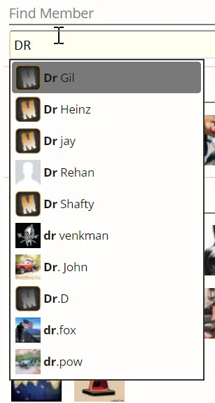

Thanks! I will check him out. I did a member search for Dr. Smash but didn't get any hits...

Did he change his username?
