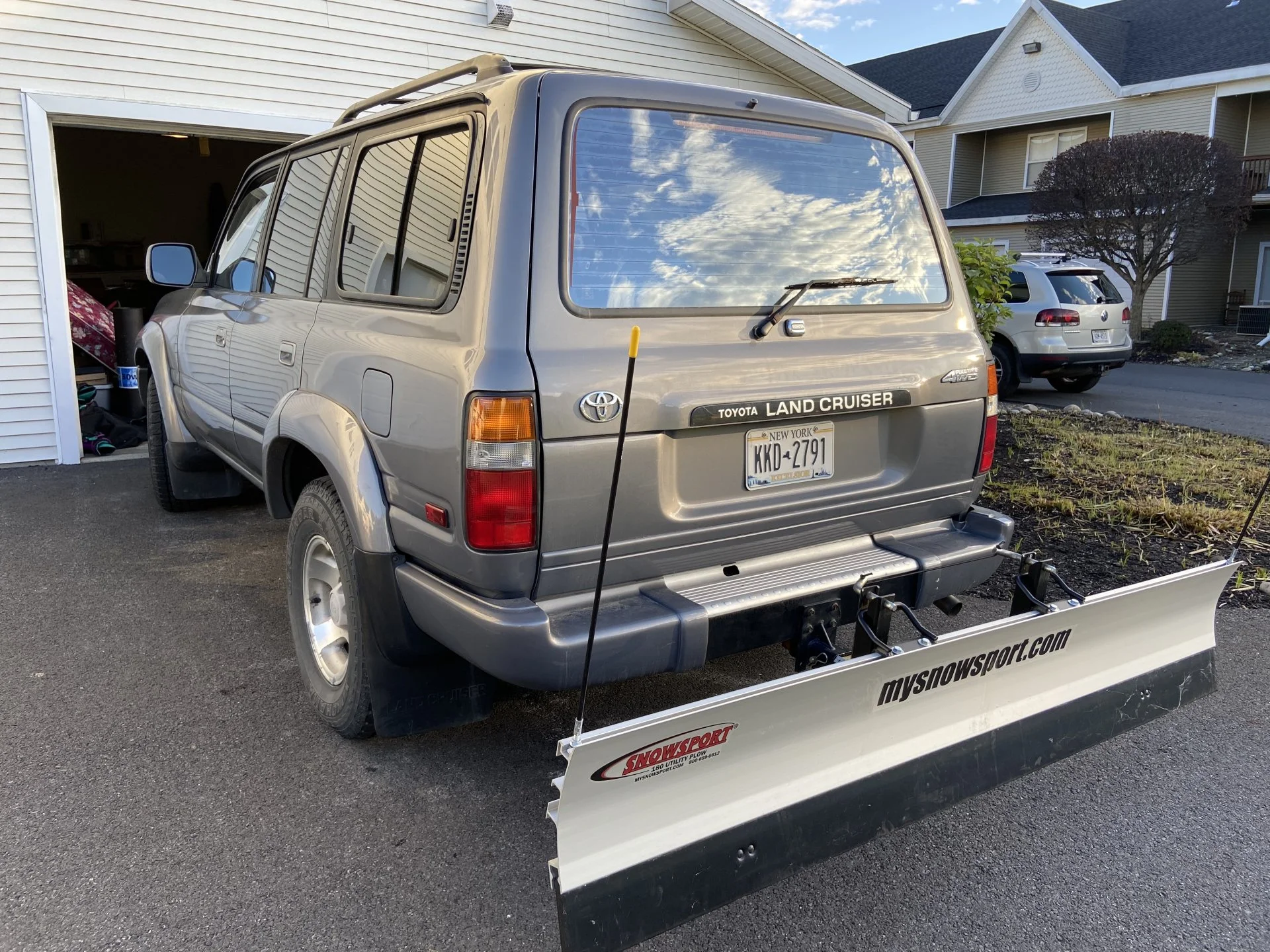

Hi. I just purchased a house with a very long driveway. So I also purchase an aluminum plow, the kind you can connect to the 2" hitch receiver. Before I start improvising, has anyone purchased or fabricated a front mount for a hitch receiver? Thanks in advance.
Cleanest way would prob be a new front bumper with a receiver.
But if you can weld/fab, bump that and improvise.
Just grab a cold one and run that thing in reverse!!!!!
Curt 13900 could be made to fit. You would just need to drill holes in the mount itself for the width. The bumper receiver hitches will need a significant drop receiver to work with most plows.
