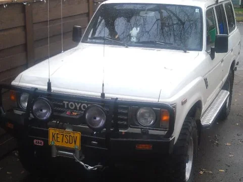

This is slightly a different set up, but I just installed a stainless whip for the cb and a stainless whip for the HAM on the front ARB tabs. I like the look. That is what the tabs are for at the top. Both my antennas stick up over the roof line a ways.
I will try to get a picture later today. However, I use Larsen NMO mounts with Larsen antennas for each appropriate use. I went to HRO and they set me up.
Picture of my set up.
