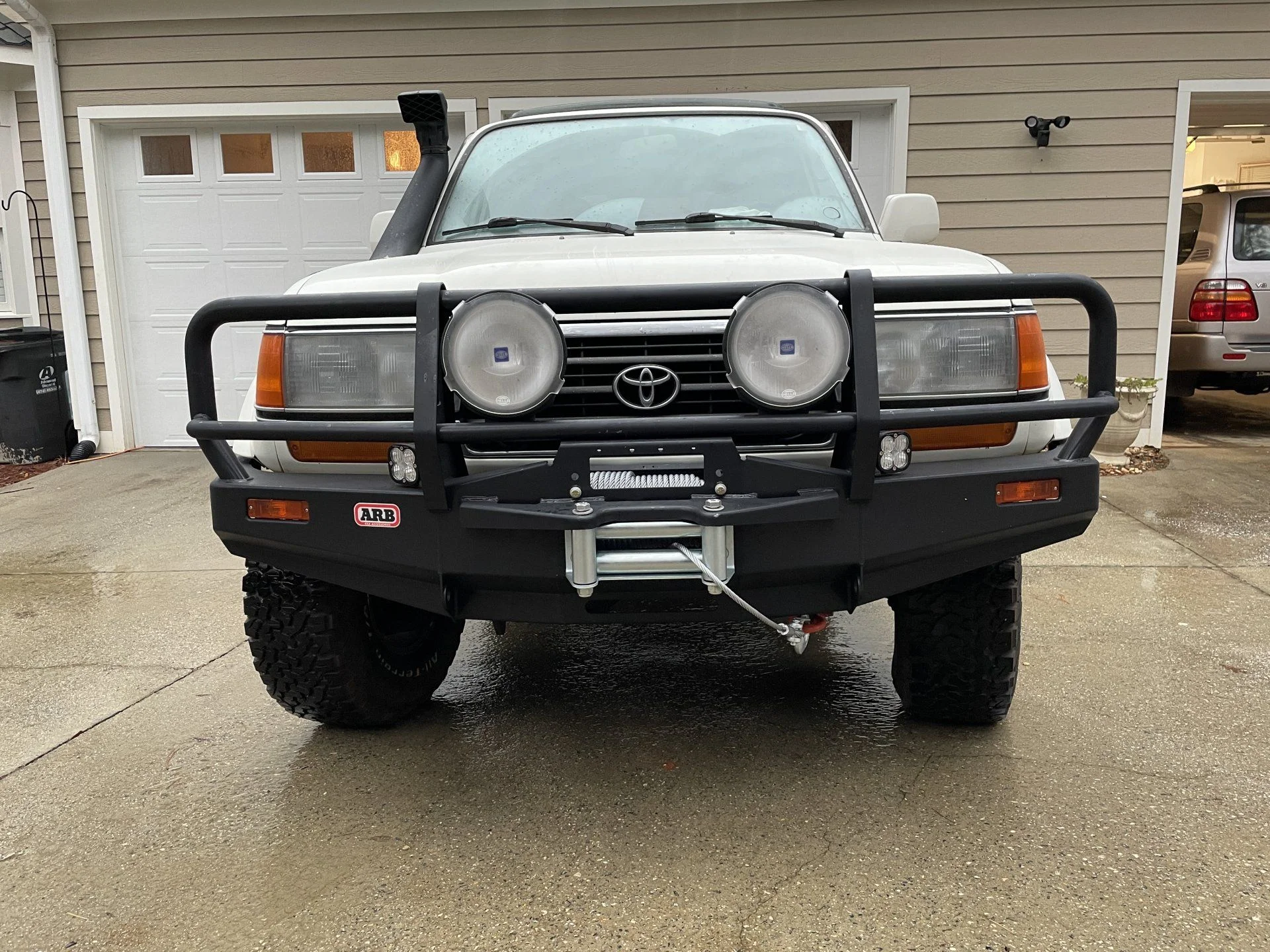

Thanks @greentruck for the write up. Your notes on modding the roller fairlead worked well for me. I was able to get a Smittybilt X20 10k into my ARB using your fairlead mods, the ARB bolts, and new holes in the fairlead plate.
I ended up not clocking the clutch, and mounted the solenoid on top of the spool between spool and lower grill.
