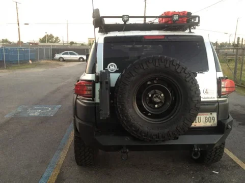

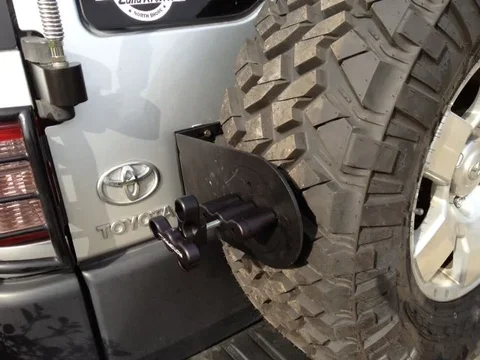

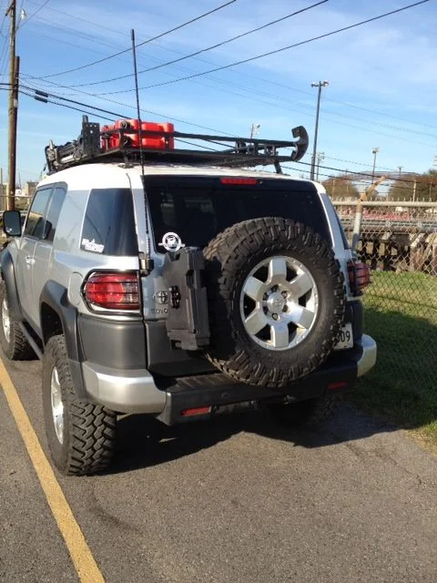

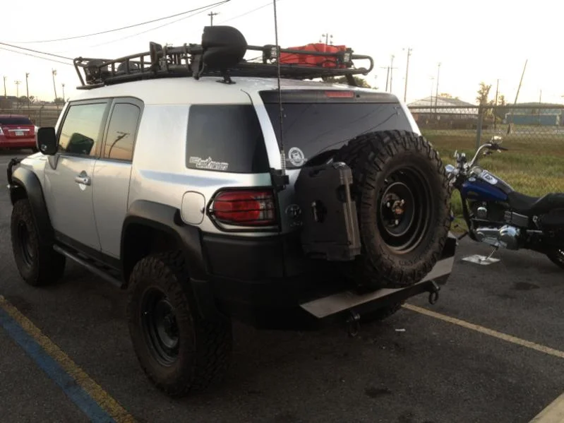

I believe that I am one of the guys Trab is refering to. The picture shown in the link above is dockbox and his cans are actually attached to a swingout not the back door. I had my mount fabbed up and attached to my rear door tire carrier. It can hold one 3 gallon or two 2 gallon Rotopax. I currently only use it to hold my Rotopax storage box with some recovery gear so the weight gain is not substantial, 10lbs max maybe. I am not having any rear door issues yet but I have only been running this set up for about 8 months.
