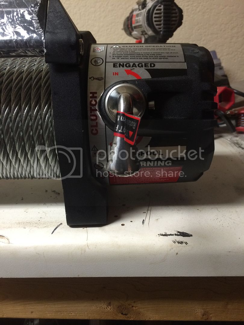

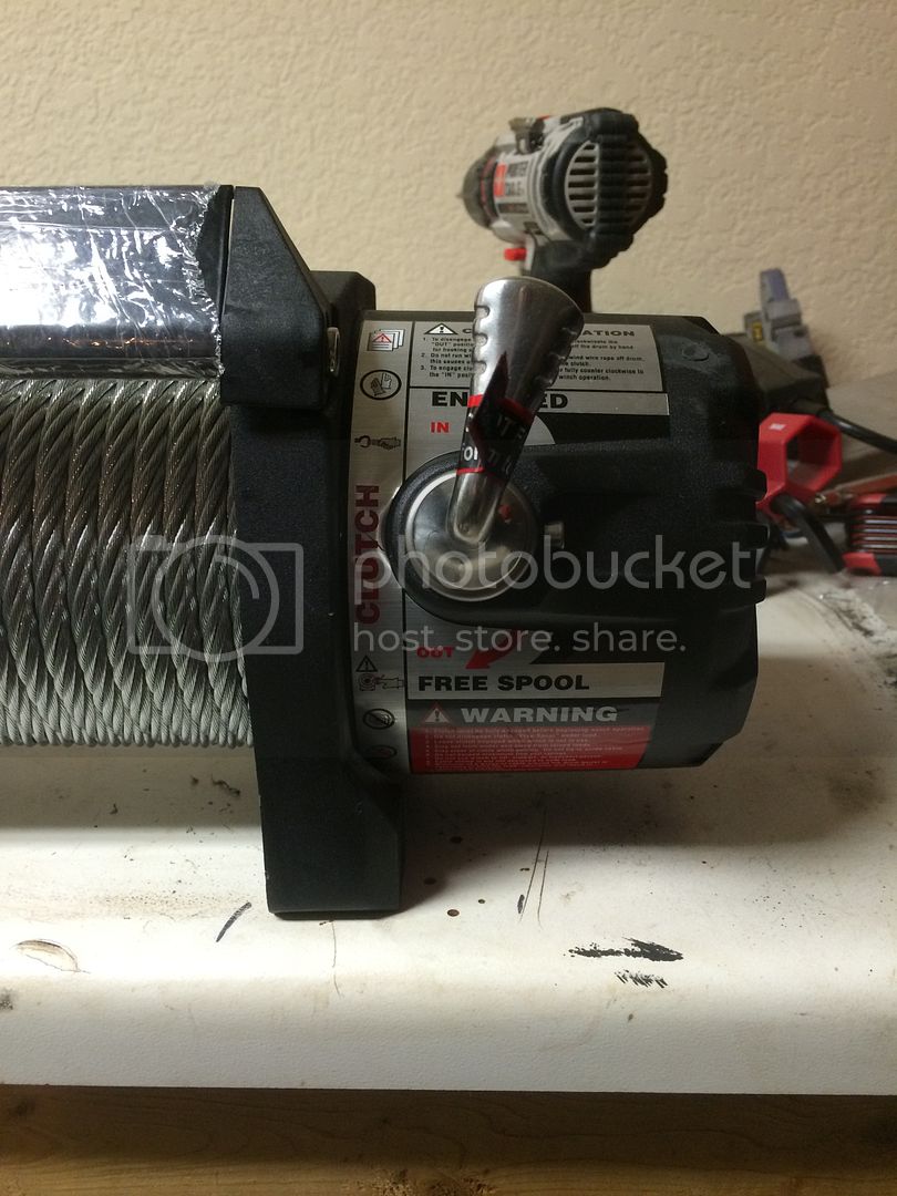

Does your lever go fully counterclockwise to engage or just most of the way? I don't think mine is going far enough. Here's a pic of it all the way clockwise (freespool) and a pic of as far as it will go counterclockwise (engage).
Try spinning the drum a little. I think mine goes a touch further but not absolutely sure. Mine did bind a little and I just spun the drum and it popped in.
Can you turn the cable spool either direction, allowing the lever to turn to fully engaged? It looks like it's between teeth and needs to rotate a degree or two to allow full engagement. That's normal if that's the case.

I've spun the drum both ways 15+ times each direction. This is absolutely as far as I can rotate the lever counterclockwise to engage. I sent them an email but I'm installing it tomorrow & I'm sure they won't reply until Monday.

It's not 'locking' into engage like it's 'locking' into freespool. I'm worried it'll disengage under a load.
You rule! There's no way I messed it up. I removed the handle while it was rotated as far as I could towards engage. W/the handle out I can use a screwdriver & easily slide the gear the rest of the way. It's almost like the casting of the little nipple on the end of the handle is wrong. Hard to explain if you've never taken that little handle off before. It's just a slotted shaft with a nipple that, on an arc, pushes the gear into engage. If I can put a screwdriver down in it & easily move it into the correct position then it has to be the handle is casted wrong, yes? I didn't try it before clocking it but I took pictures, had the diagram AND the directions on clocking it so I'm 99.9% it's not me.
Fixed it, I think. I took the handle out again, worked the clutch back & forth with a screwdriver to make sure it would do what it's supposed to do (& it was) & then reinstalled handle. After applying what felt like was way too much pressure it finally went to full engaged. It appears either
