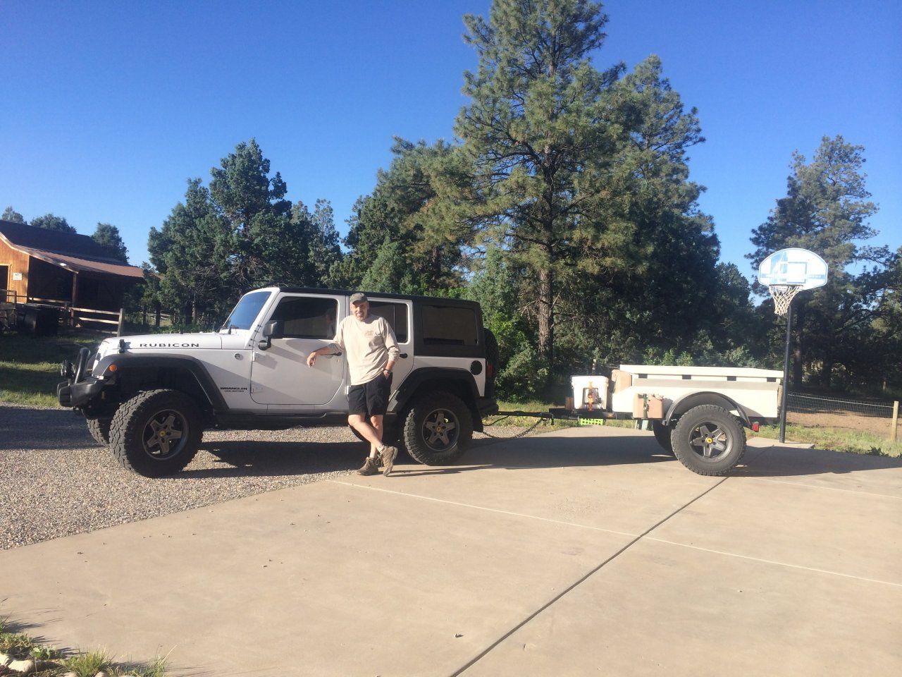

I have a home build, no trailer brakes, but the trailer loaded is only 1200lbs. I build my trailer track to be about 2" narrower than the JK for going around switchbacks or tight corners. I used a 3500b axle, so that I could match bolt pattern of my JK
Hub face to hub face is about 52". Correction, 53".
I am also using 1.5 or 2" spacer for the wheels to clear.
Center of tire to center of tire 55"
Also I used 700lbs springs to try and help with the ride of the trailer, it's better than 1000lbs+ springs, but it still bounces a lot. Estimate you weight before you get the springs.
