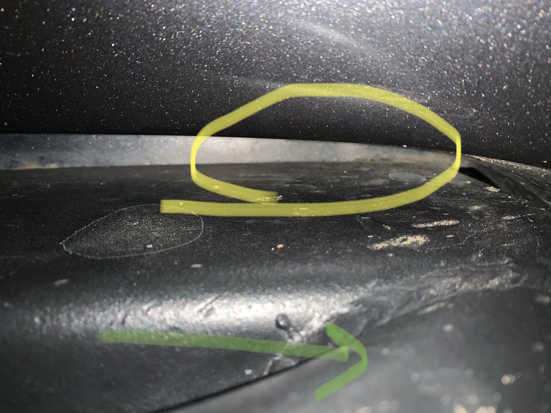

Here is a picture of where the noise is coming from on the passenger side front mount. The plastic trim on the rocker panel is the culprit, but I can't seem to get enough separation from it to prevent the squeak.

Here is a picture of where the noise is coming from on the passenger side front mount. The plastic trim on the rocker panel is the culprit, but I can't seem to get enough separation from it to prevent the squeak.View attachment 2324068
-Wider shot for context...
-View of full slider underneath and external...
There are people here willing to help, but ya gotta give folks waaaay more visual clues. ;)
I don't know the mounting mechanism of these sliders, but could you loosen the mounts and insert a metal shim in the upper portion to angle the tubes down a little? A little bit of shim could result in a fair amount of space that far out from the pivot point.
Is thereSomething that makes you certain the squeak is definitely coming from the slider? If so, what assures you of this? Not doubting. TryingTohelp you troubleshoot
Sorry for the lack of detail. Pulling single dad ops all day today haha. I added a couple more pics for clarity on mounting. The noise is only coming from the passenger side front where the slider rubs the plastic when the vehicle flexes.

@Markuson it's definitely coming from the plastic / slider interface. The video I took shows that. Wish I could upload.

**PS. Nothing under there should be able to move as freely as what you move in the video to produce the squeak. Is there a chance trim piece itself is its own problem? It shouldn't really be moving at all. Could be it’s own anchors are screwy and contributing to the contact.
Those sliders do mount really close to the rocker panel!! ARB mounts much farther away.
