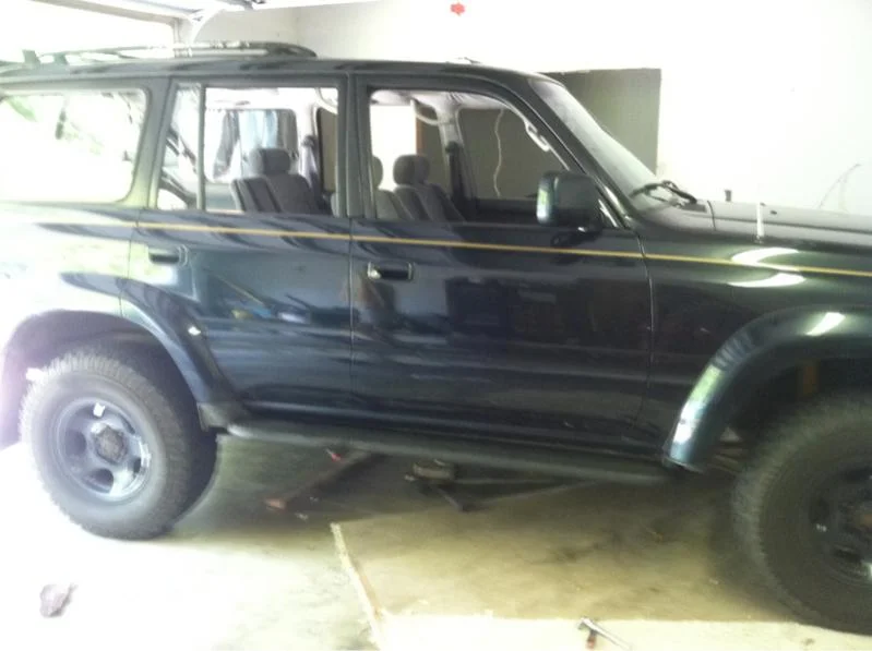

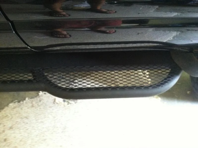

I don't, I am really happy with the fit on the driver side, very nice and tight. The passenger side rubs that bottom bit of rubber on the back door just a little bit. I might gap that side or just shave a little off that rubber for now though it's not enough to bother me.
The only thing I am not happy about is the paint. I sanded scuffed cleaned prepped and primered and the duplicolor extreme truck armor stuff still didn't stick well. I would not recommend that paint.
You may be too close to the pinch weld without the gap and they may rattle a little bit. The good news is that they should be easier to take on and off after they have been on the truck for a little while. I even drilled the holes in the frame plate larger on yours because Eric's were hard to get lined up. I guess you forgot the bottle jack trick too? you can easily lift them into place and, as we learned with Bamaheel's, move them a little bit forward or backward.
That sucks about the paint, did you use the duplicolor primer too?
I'm really excited about getting mine, Can't wait! Should I go on and romove my factory step rails or just do that when I come up for final fitting!!!
Either way. If you can live without them it will speed things up. If not, it is no big deal to take them off. We took Bamaheel's off when we fitted the sliders.

I haven't noticed a rattle. I used a bottle jack on the outside bar to tweak the frame plate I had been trying to jack it straight up and that wasn't working. All my problems were because o my inexperience not anything wrong with the sliders/design.
I used generic primer.
I don't know what I'll do with/about the paint. For now I'm just going to ignore it.
