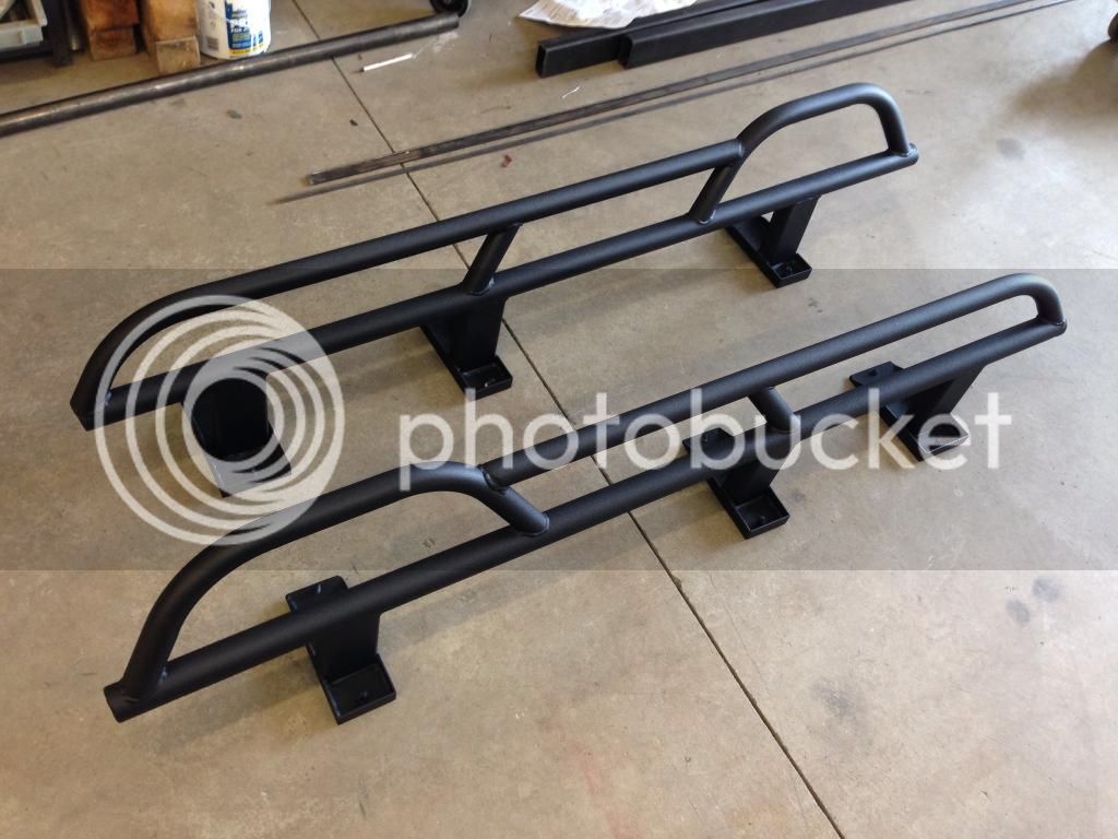

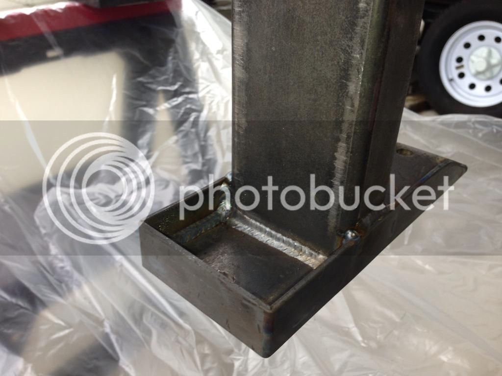

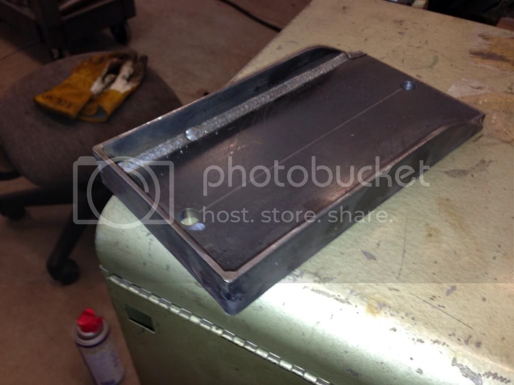

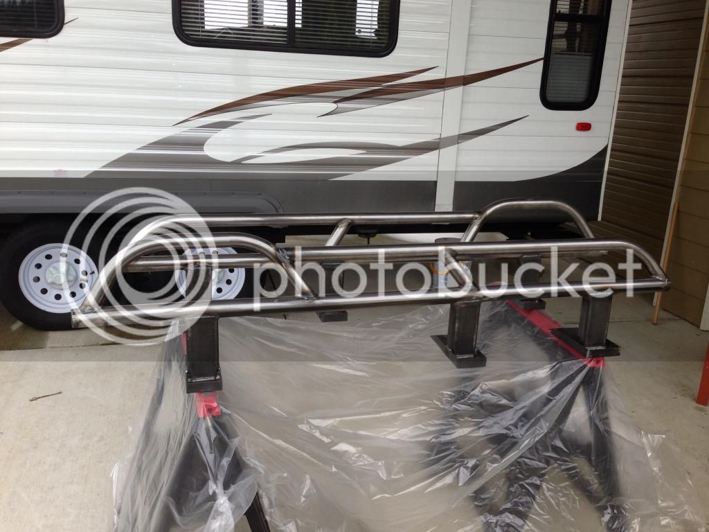

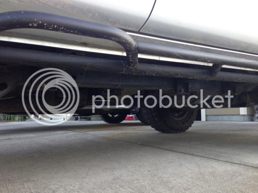

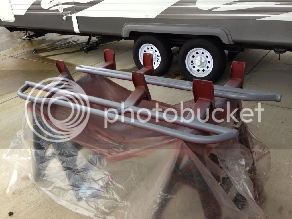

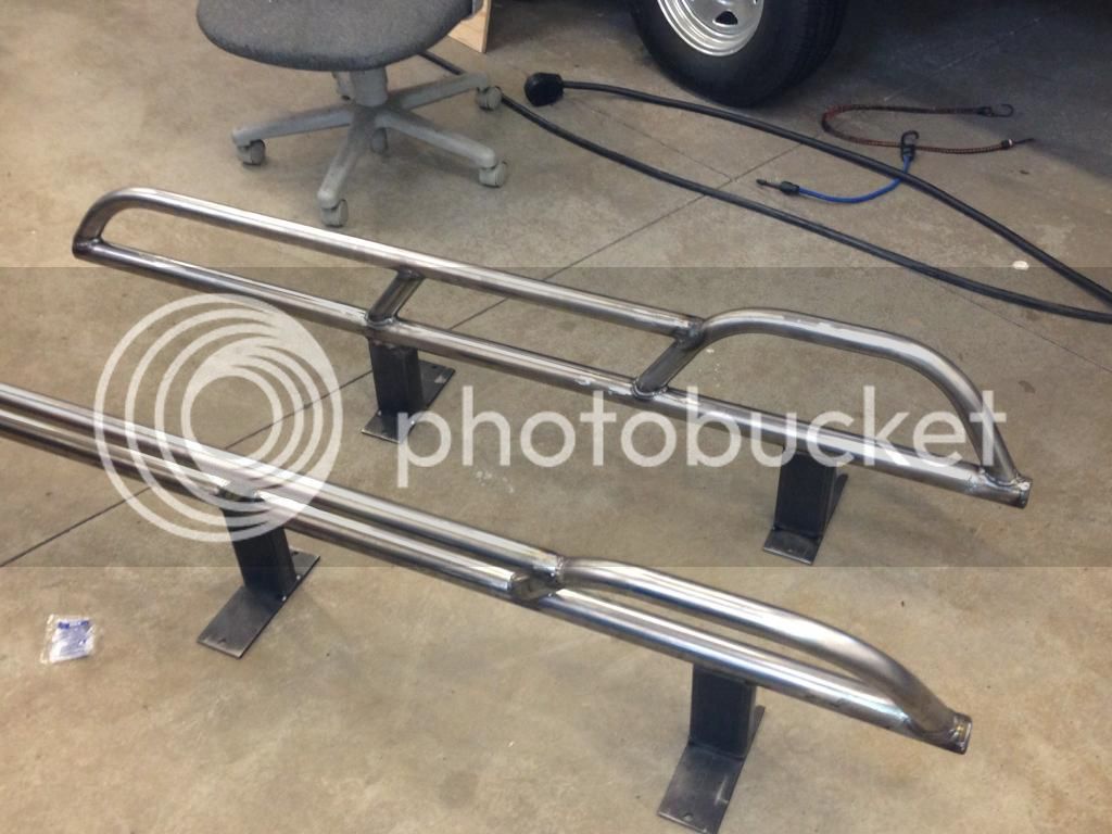

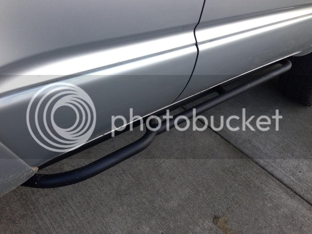

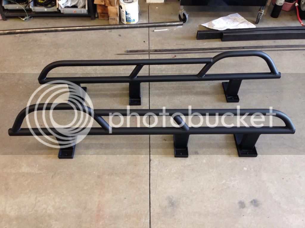

Finally built some sliders for the runner the other weekend. They're pretty simple in design. I had u bolts bent up that fit around my frame which allowed me to easily bolt the sliders instead of weld them to my frame. Main tube is inch and three quater .120 wall, and outer tube is inch and one half, also 120 wall. The mounting plates are 1/4" thick with 1/8" flat stock wrapped around them to keep them from flexing when being tightened down. 1x3 tubing was used to connect the mounting plates to main tube. Well anyways heres some pics.
Mounts:
getting closer:
ready for paint:
primed:
all done:
Nice welds and design. Looks great on your truck.

I had custom u bolts bent about a month ago but I have yet to get this project finished. One thing I'll probably take from your mounts is adding that lip around the plate that mounts to the frame.

I hadn't either til I started looking at armor for my 80, they are much more common than you think.
I think the u-bolts that came with my 80 sliders were 1/2" or 5/8" diameter. Took 3/4" wrench to tighten the bolts.
i wanna say that the bolts were either 3/8" or 1/2" not sure of the top of my head, i had them made by oregon auto spring in portland. And the lip i feel really beefed up the mounting plates, and gave it a more finished look.
