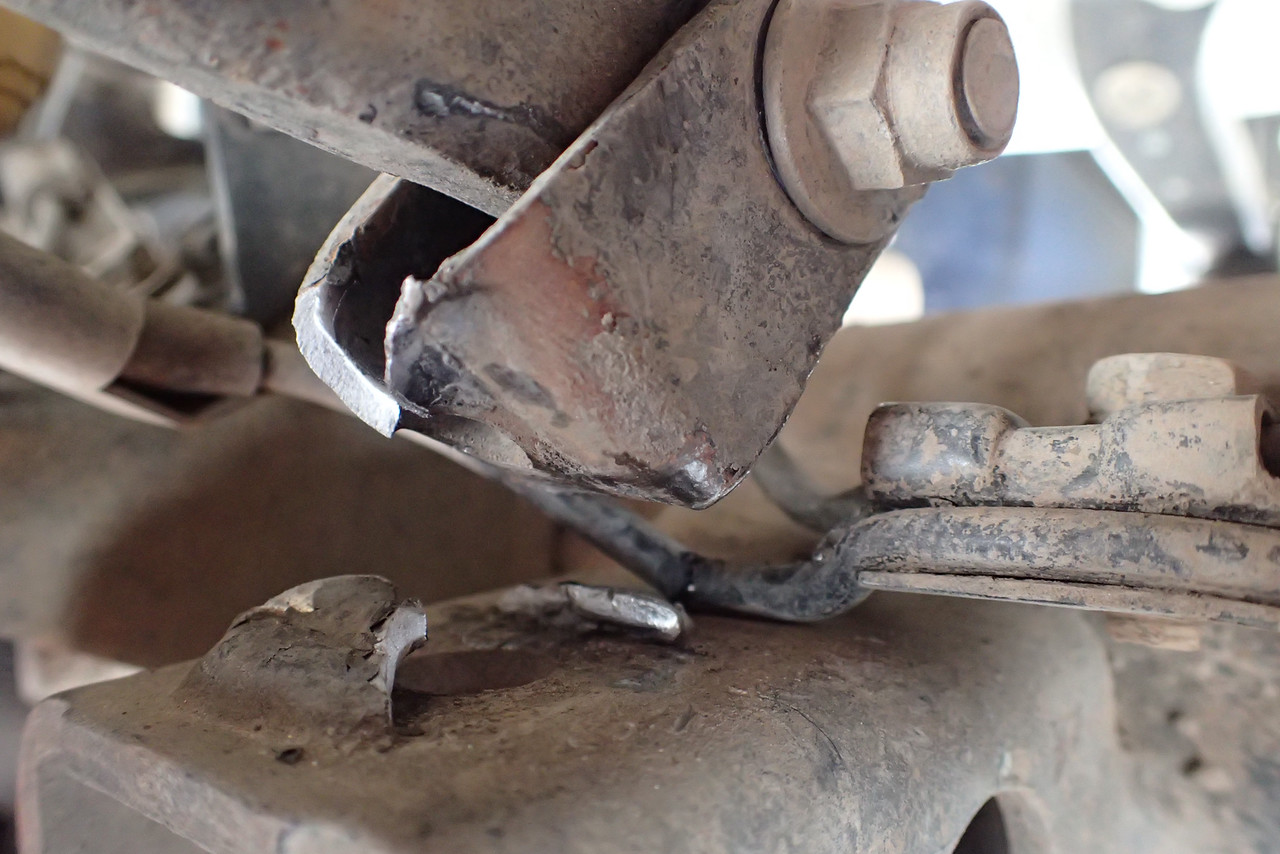

Not long after the trip the ABS light came on, open circuit on the front right. The first couple of times I looked I didn't see the problem.
Turns out I tore the front left sway bar bracket off the axle, which then cut the ABS wire.
I may have to drive her without a sway bar for a while...and I will definitely need help with the welding when I fix it.

Dang, I will almost always be taking off the front and rear sway bars for any wheeling now, after what I have learned on the Rubicon. Sometimes that front sway bar takes out the break line on the passenger side when it goes. So always take it off for real wheeling.
