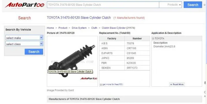

Toyota dealer
31470-60110 (10/1981 - 10/1984)
31470-60120 (11/1984 - 09/1985
