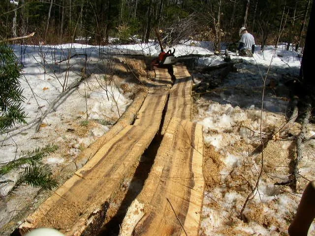

Tree down & split up. Stripped the bark and over with the others.

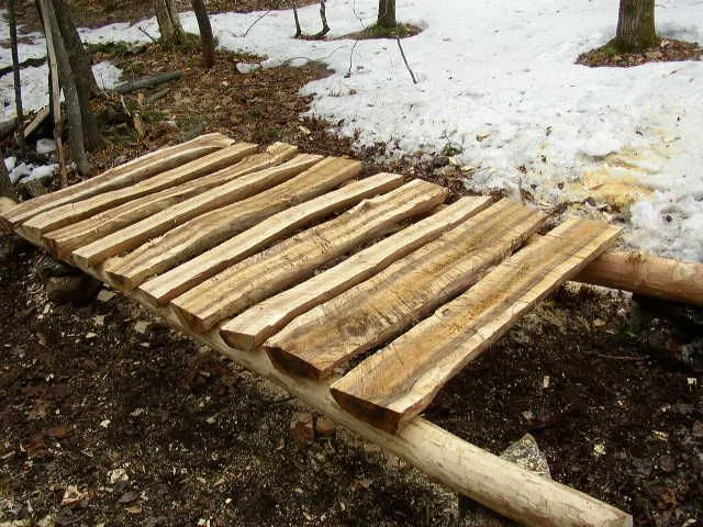

Notched the logs, planted some rocks.
Used some oak for pegs to draw them together.

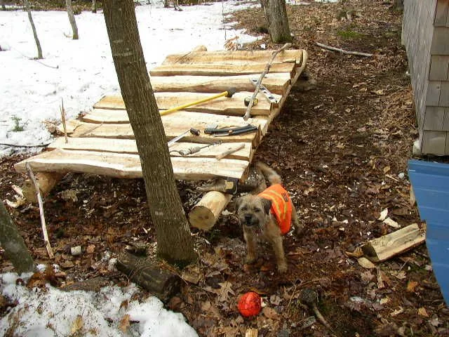

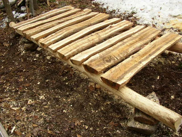

Now we have a platform....12ft long x 5ft wide.

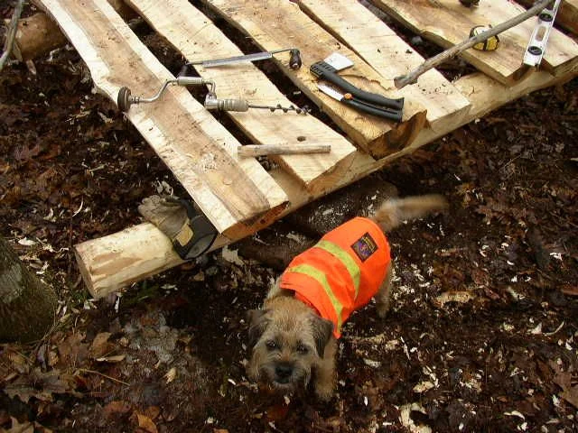

I like your little helper ;)
That is Bean...
He loves to have his ball thrown. He is getting a bit too possessive about it though.
That is Bean...
He's got that happy dog smile :D
Hope he doesn't get possesive about your project (if you know what I mean).

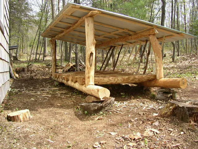

I plan to put up some uprights, and then span those with horizontal pieces to support a small roof.
I am not going to seal it with anything. I believe the logs will last a good long time, up off the ground, stripped of bark and with a roof. If it rots away in 10/15 yrs, I will make something new. But, I dont want to spend money on this and I dont like the chemicals ya know.

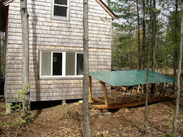

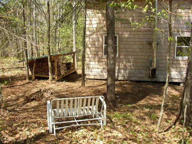

Finished it up...
Spent $101 on some metal rood with the green to match the house and shed.

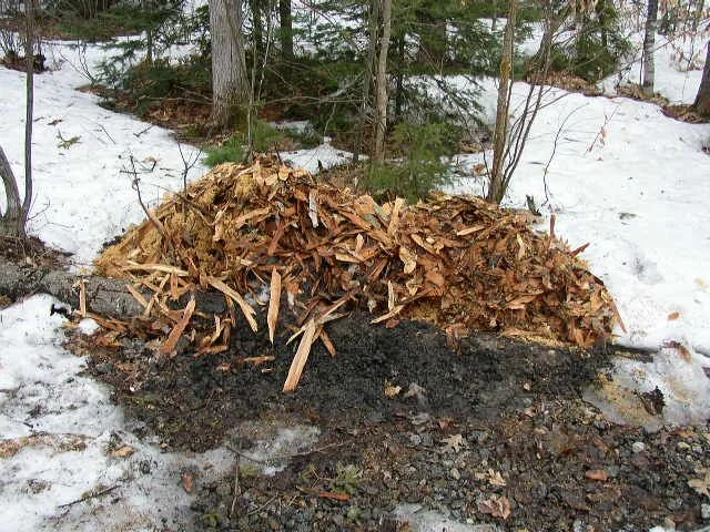

Cleaned up the old crapola pile from the side.

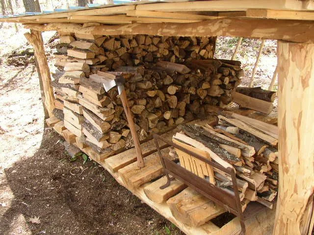

Storage is now closer to the house, capacity should be enough to get through a full season. And, being at the back, it is out of range from the snow coming off the roof.

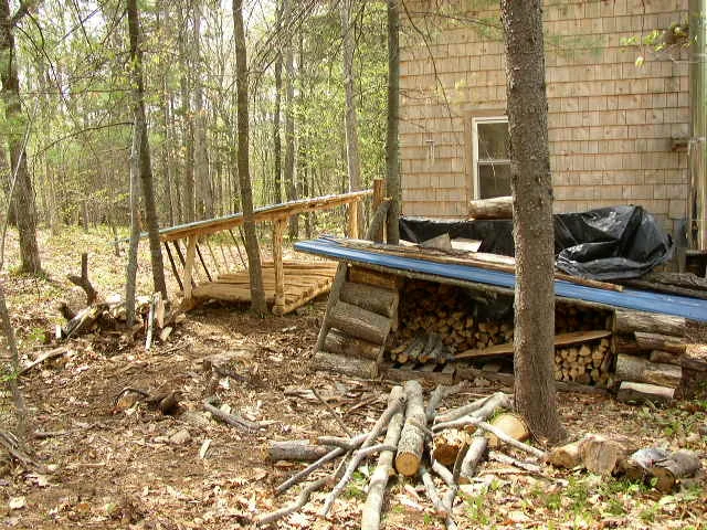

Before, notice the original wood storage...
And, yes that is a Gransfors Bruks splitting axe. It is awesome...
I should mention that I had a goal of making this without "store bought" hardware. Well, I used wooden pegs and drilled with a hand auger to fasten most things. I used a few pieces of 1/2 inch rebar for nails and again, I did purchase some metal roof and used roof screws that I had leftover.
nicely done and very pleasing to the eye..................
