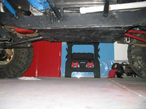

i went wimpy with mine at only 1/8" with major gusseting.. I finaly got to test it out on a a couple of hard landings a couple of weeks ago on eagle rock and its dented a bit
If it is taut like a trampoline and supported from all side with cross bracing it will be ok. If you are relying on it by itself, no go. The stock fj40 skids are 1/8, a 1/16 more is not enough. Pulling mangled skids from under my truck was humorous.
My skid is 3/16.. it's supported by 2 crossmembers, and the frame rails. it bent badly when I had it unsupported (initially had it hanging down at the back 1.5".
Once I tucked it up tight to th frame rails, it's holding up well, and it's something like 30x36"..
