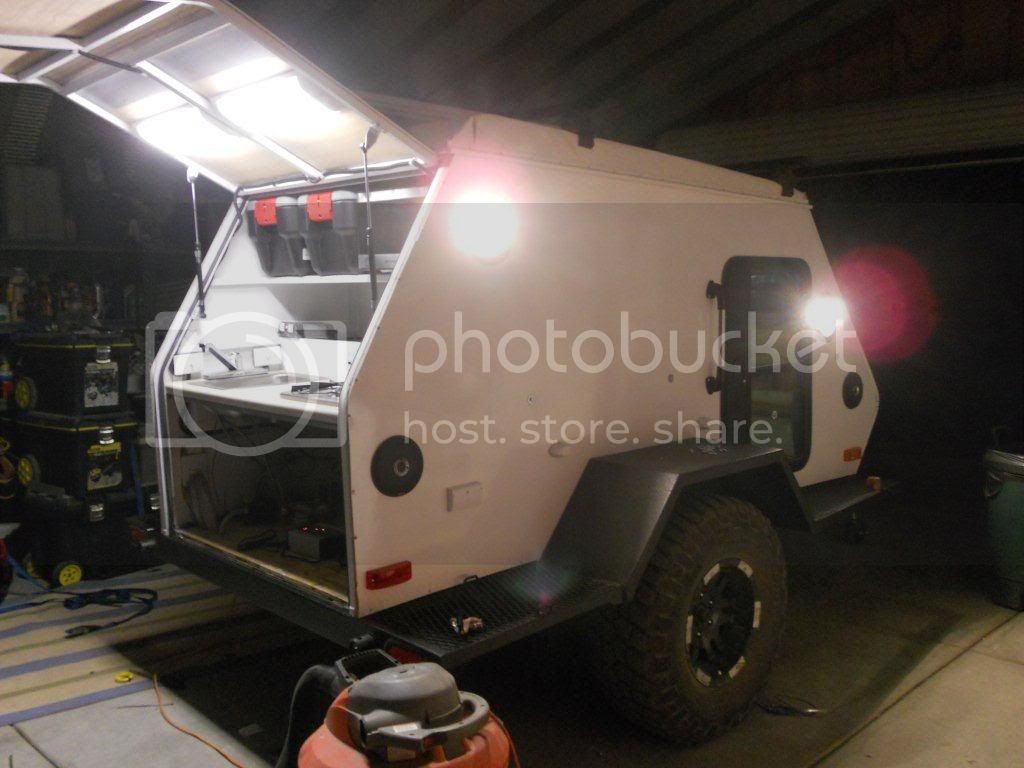

Setting up a temporary battery system for it to test everything. Setting the solar panel on the inside against the wall. A safe place for it at all times. If I go with a larger one I will mount it on the roof.
Have most of the electrical done and in looms, still have to add 12 volt boxes for fridge and other items to be used later. I am putting two 750 inverters in. One in the kitchen and one in the sleeping compartment.

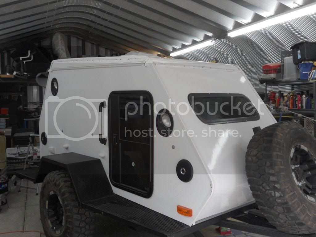

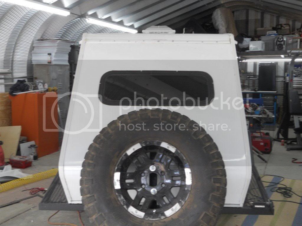

Picked up the new fiberglass for the top and put it on this afternoon and evening. Put on the passenger side drip rail, and temporary roof vent, will replace when I can afford AC.
I am not a trim person that is for sure. It looks like crap, need a bender, but can not afford one yet. I never did it when I was building off road fifth wheels, just welded the frames and designed how I wanted them. I had a guy that could do the trim in half the time and it always came out perfect with silicone. Not gonna happen with mee doing it for sure.

The fiberglass was made by Eclipse RV. It is bonded, laminated prior to me getting it.
I gorrilla glued it to the sides, but do not think that was necessary. I have screws all around the out side, around the door, and the windows, not to mention all the boxes for shower, hot water heater. I also have three bolts through the main frame to the side walls. This one was built with out jigs, so there are some errors that I will correct. Which will make the build much easier and quicker.

Time will tell on the seal, right now it fits very snug. My seams/edges are like any current RV. I only have one problem area and that is between the fenders and the walls. I am filling the bottowm with high end silicone to prevent any damage there. I did not rhino line the trailer until after the wood was on. I knew that would be a problem, but had to get the design up and working. Did not know if it would be a go or start over, so therefore decided not do the rhino lining until I was sure.

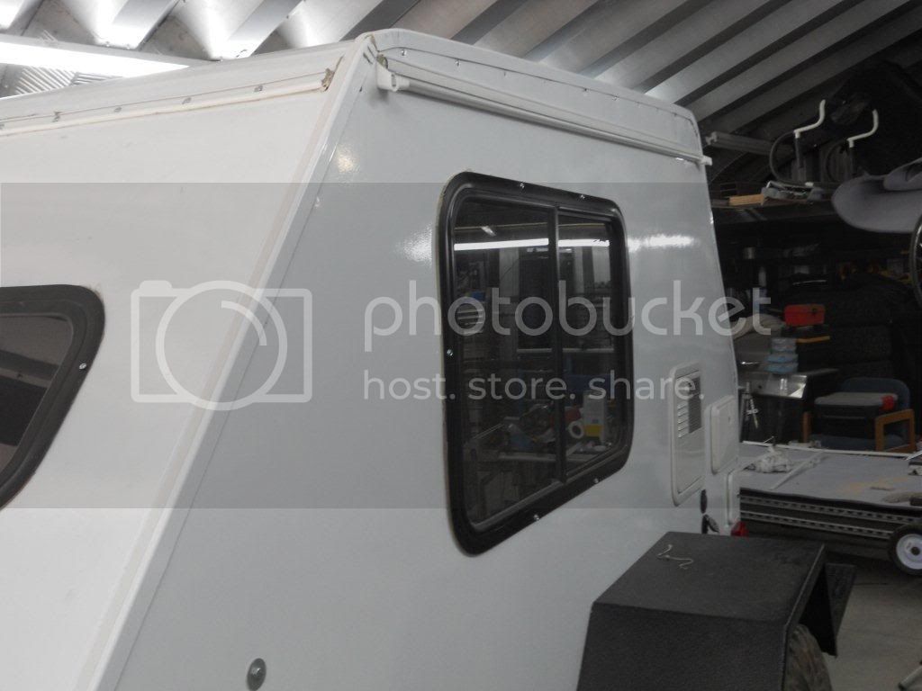

Some additional photos.

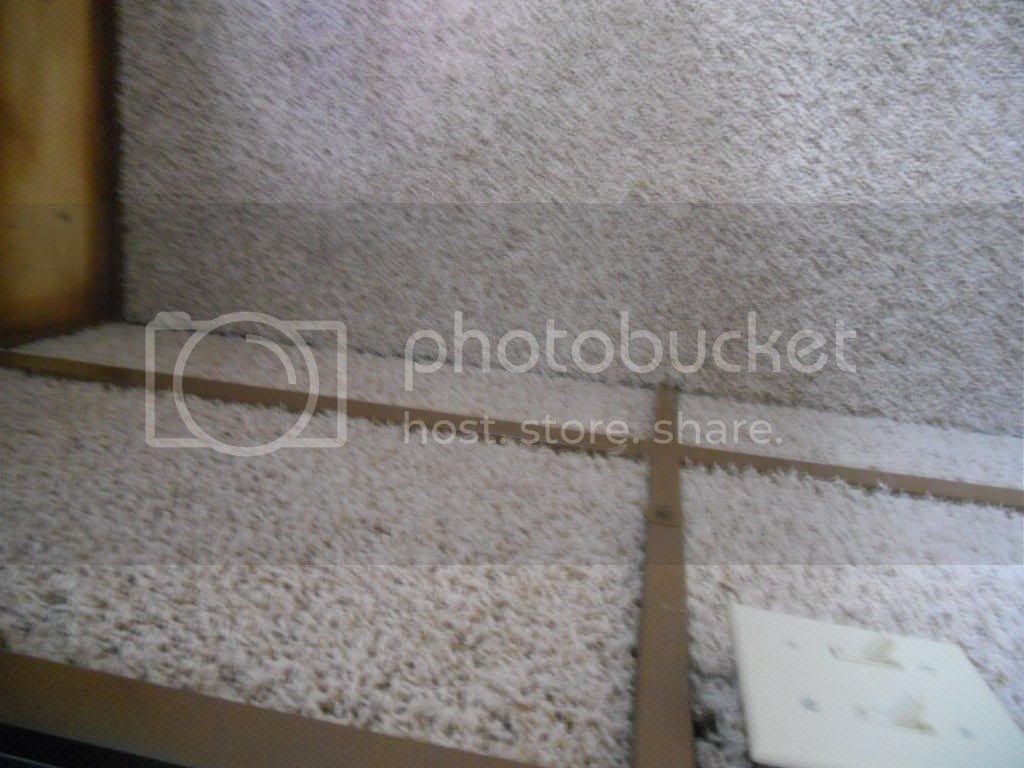

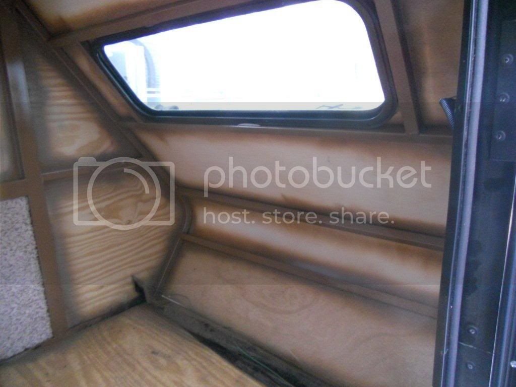

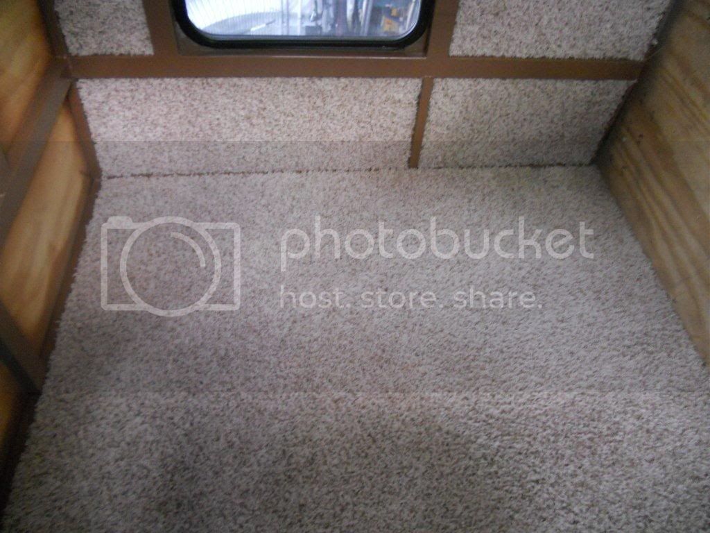

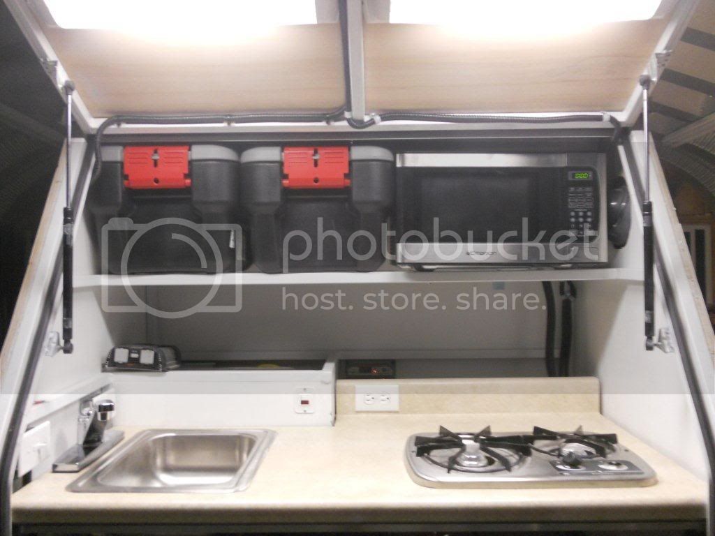

Interior work...

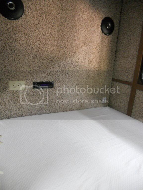

The stereo, electrical outlets, and tempurpedic mattress...
Drip rails...

kitchen looks good, and with that carpeting on the walls...it's going to be a regular "loveshack"..

Interrior
I was looking for something to keep it warm and deaden the nosise. It is very quiet inside.
I still have work to do to design storage. I may put a lift lid under the bed. I could do about 6 inches there.

I have the ends of the trim to put on and then do the silicone.

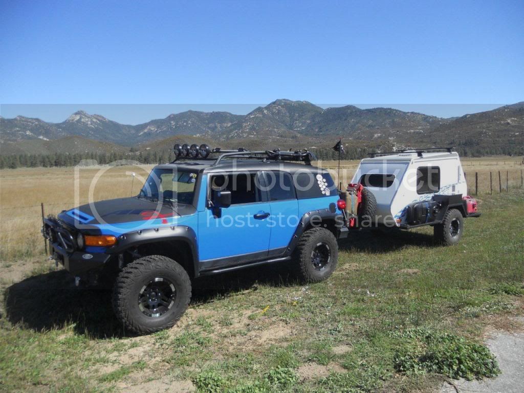

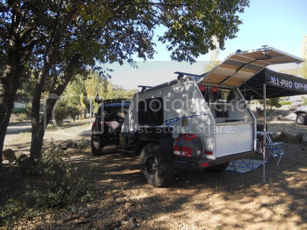

Maiden voyage
The trailer maid her maiden voyage this weekend. A 250 mile round trip to Juliam for Expoberfest.

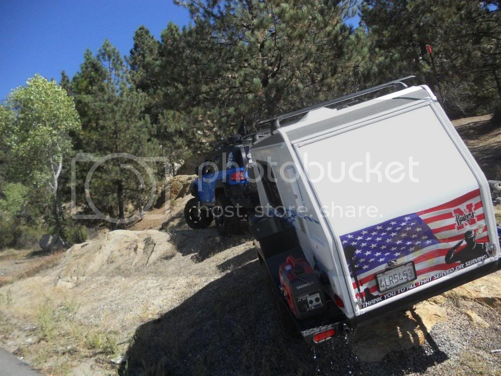

Trailer performed perfectly other than a small water leak from the air vent on very steep inclines. Will be fixed on this one with a plug and by moving the fill door above the water heater on the production ones.
I spoke with Phil Duckworth of Dexter Axles this morning. They have a new air ride/torsion axle. It is quite expensive, but I am looking at mounting one on the trailer. It is top of the line and used on the U.S. Military trailers. There question is do they have one light enough for the trailer. I am sending pictures of the frame to them to see if it will mount. Quite exciting as we would be the first off road trailer to try them. Hope to have pictures of the progress on the trailer tonight.
Well unfortunately Dexter does not make a air ride axle suitable for our trailer, 5500 pounds is the lightest they go currently. They feel that their torsion axle works perfectly for this size trailer. They build the axles, and have far more knowledge about what will work and what won't so, a little disappointment.
Getting close to becoming a vendor, pricing has been set.
Well the trailer made its maiden voyage this weekend. Everything worked perfectly and it towed perfectly. It is warm and quiet inside. I parked less than 50 yards from the main campfire, which ran until 1am. Never heard a sound as I hit the rack at 9pm. I opened the window at about 1230 and could hear faint sounds coming from the fire ring..
Generator ran everything, DVD worked well. Did not even use covers in the trailer. Got down to low 40's I was told.
I did find a small design flaw in the water tank. Being low I never considered how high the fill should be. On a very steep rock incline I noticed that the water was running out of the vent tube. Will need to find a plug for that and on the production trailers make the fill entry above the hot water heater door.
