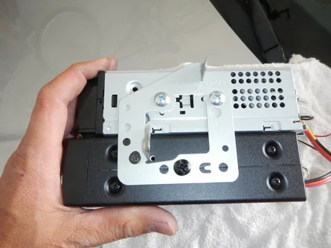

Thanks everyone... I mounted it last night. Surprisingly it was not too bad. I was concerned about mounting brackets. Fortunately the stock backed bolted up perfectly to the stereo. Then the CB fit tight and perfect in the space below the stereo.

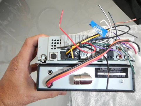

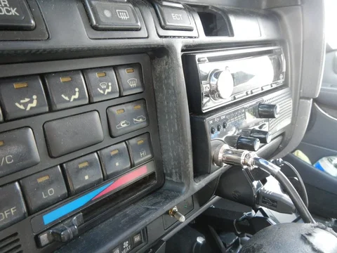

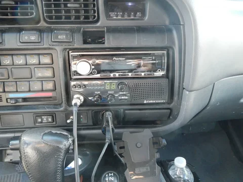

Here are some pictures of my install. I sourced power from the other radio plug. DSCN1833.webp DSCN1834.webp DSCN1738.webp DSCN1739.webp

I ran power from a fuse on the driver side. Grounded to bolt in that same area. I found a constant hot wire because I wanted to be able to use the CB when the ignition is off.

Install looks good.
