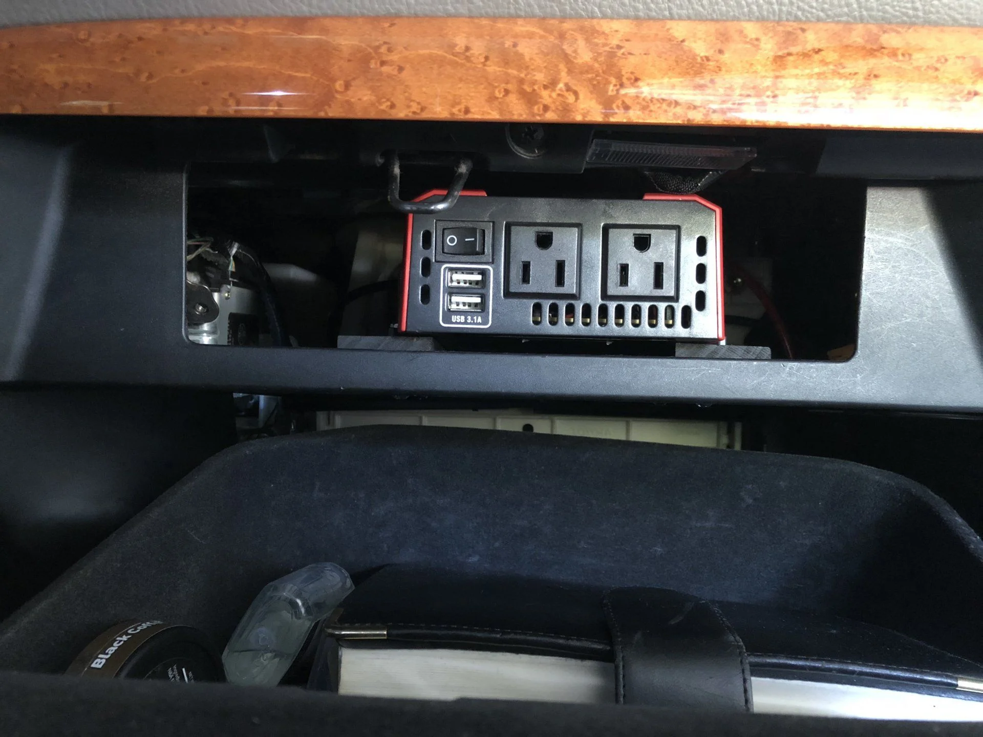

CD player has been inactive since I installed the GTA car kit (bluetooth). So I mounted and hard wired my invertor in its place. I used some 1x1s that I spray painted black to mount the invertor up off the plastic glove box housing to provide some ventilation on the underside.
Nice job! What's the spec on the inverter?
