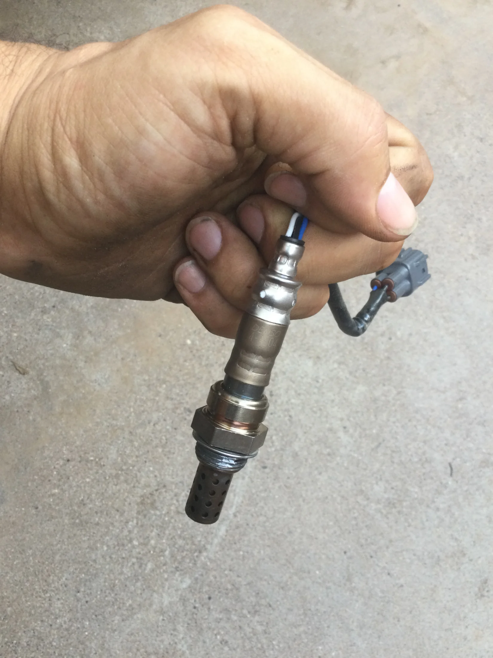

Hey folks,
I've got a 2008 with 220Kish on the clock. I've recently come into the truck. It was my sister's though, so I've actually been maintaining it for years.
It's got p0420 and p0430. I replaced the Drivers side DOWNstream o2 sensor and I noticed the o2 sensor was not a Denso (or OEM) part. Anyway, I was feeling confident. I cleared the codes. Today, both codes came back. I was hoping that only one code would come back and this would mean I just needed o2 sensors.
Here's my question. Is it worth replacing the UPstream sensors to really make the experiment fool proof? Those upstream sensors might be some kind of cheapo sensor that's throwing the whole thing out of whack. Its a long shot but its cheaper than new cats.
Thanks in advance for any thoughts, opinions, or ridicule, as appropriate.
Pics are of the new sensor and also of new and old together.
-- Beej
You can throw all 4 new sensors at it if that's your diagnosis method. If it doesn't fix it then you need to replace the cats.
Techstream and other diag software allow you to increase and decrease the fueling to check the responsiveness of all 4 O2 sensors. If they all respond in unison then there is nothing wrong with them.
At this point you would be better off trying this Amazon.com: Liqui Moly Catalytic System Clean 300 ml 7110. Cleans The Injection System and The Combustion Chamber. : Automotive - https://www.amazon.com/Liqui-Moly-Catalytic-Injection-Combustion/dp/B07Z54MBQ3?&linkCode=sl1&tag=lilevo-20&linkId=add479991a0e05fe8b6adb24df5f37ec&language=en_US&ref_=as_li_ss_tl
It could clear off some of the carbon on top of the cat that would in turn increase the efficiency of the cat and maybe be enough to not light the codes.
I gotta get TechStream. I know there are threads on it. Even if I already had it though, I wouldn't have know that. Thanks.
I'm in AZ. Truck is registered in another state. Here in AZ, you can't have any codes or you'll fail emissions and you can't register the vehicle. So, maybe the chemical solution is a good one.
I have a whole video on the testing process coming soon, it's in my youtube queue. I think that video will be out on 9/28
I'd recommend the cleaner though first based on my testing. I've had P0420 and 430 on a few trucks and the O2 sensors definitely aren't the problem. People really need to use premium gas and beat on their trucks once in awhile to keep everything cleaned out in there.
According to this video (thanks @Timujin) the cats are actually bad. The vehicle is old enough and has enough miles that it is simply time to replace.
Not a bad try by me to check the o2 sensor but, since both codes came back, I can safety assume its the cats.
Before you trash the sensors OR replace the cat lift it the GX up and listen for leak in your exhaust header! That will mess with your O2 sensor!
I had the same code! The local muffler shop found an air leak (a piece of hose in the ear and listening for leaks at the connection) at the header pipe joint. Did a light weld around the flange that you can grind off later! Problem solved!
At 220K your front O2 sensors will not be functioning as well as a new set of sensors. I always replace the upstream and downstream at the same time. Your cats could be bad too, but IMO O2 sensors are a wear item and should be replaced about ever 150K.
