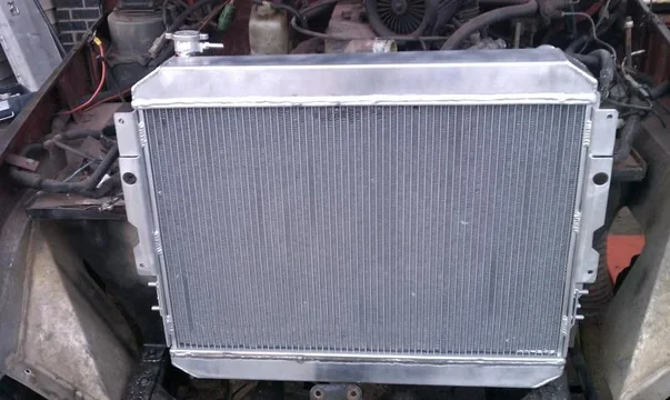

I decided to make this one work. Which really wasn't too bad took about 3 hrs total. It's now held on with six bolts to the cradle for the battery box. Here's the steps in order.

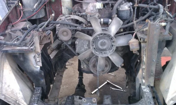

2) Took out the old radiator, shroud, and cradle

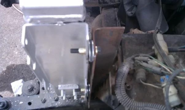

3) Drivers side I welded a piece of angle iron tappered to fit the taper the battery box mount has leaning toward the firewall.
4) Passeger side was easier as the battery box isn't tapered and I just welded a piece of flat bar to extend it to fit the top holes of the radiator
5) Welded these pieces on and painted with POR 15.
6) Mark and drill 6 holes for the radiator so the radiator is sitting of the frame about 3/8"
7) bolted it on with rubber gromets between the welded on mounts and the radiator to absorb some shock

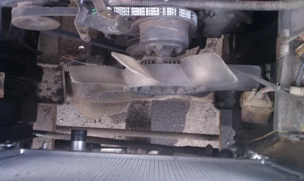

For the most part it is done. It's in there and all put back together now. I have to hook up the hoses when I get them and fill it up with fluid. But the radiator is in and mounted. The second pic was of it mounted. Here's a few more I took. As you can see my rubber groments were a little soft and got a little smashed. But it should still be ok as there wasn't much room left for the hood latch to work anyway. One thing I didn't anticipate was it looks pretty nice in there. The grille, with the emblem, and a nice aluminum radiator in the backdrop instead of a rusty old brown one with a the cradle.
