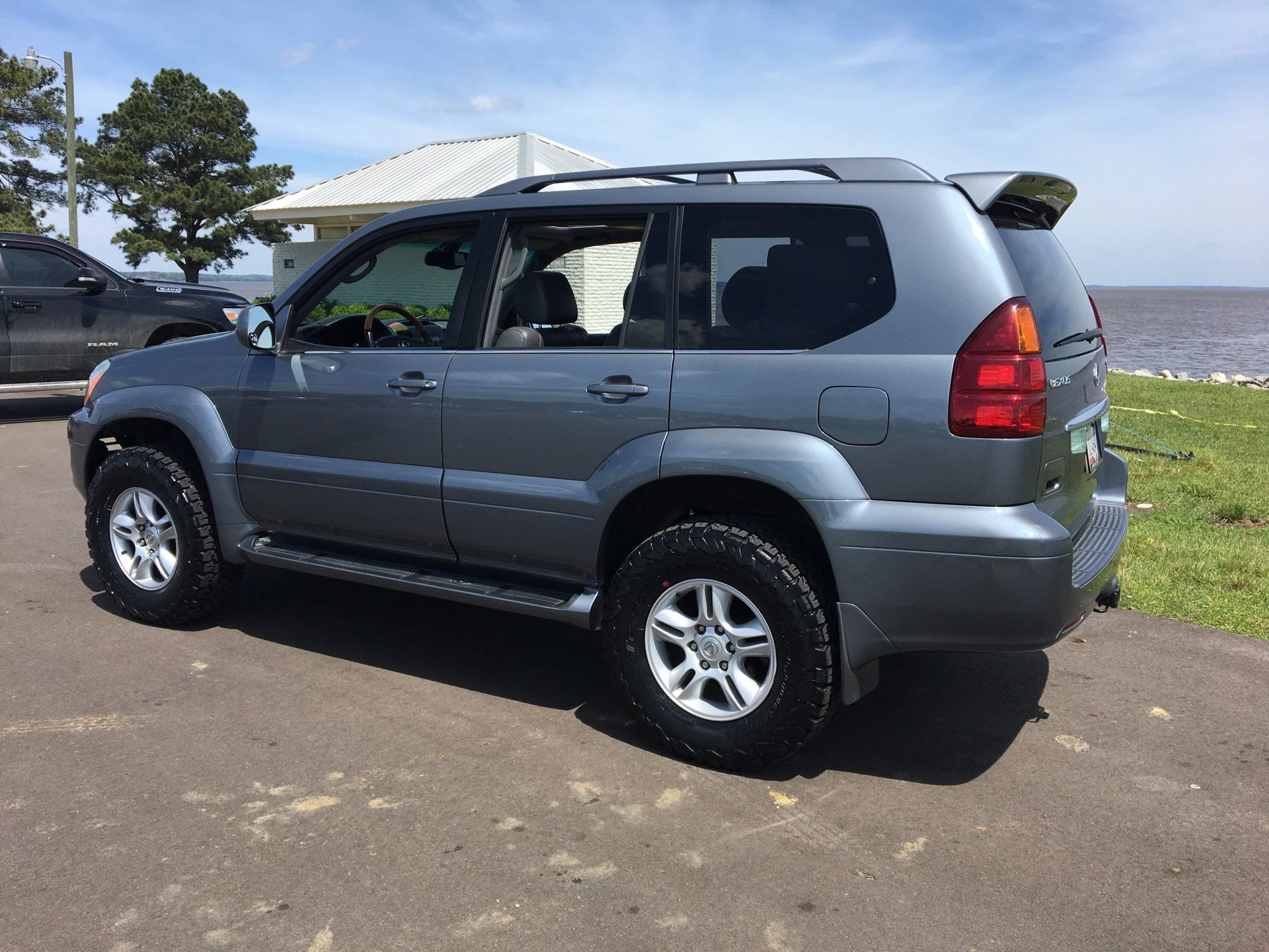

I just did 2" lift with rear airbag delete. Cheapest I could find was Old Man Emu 2" kit medium duty with Metal Tech stage 2 rear conversion for just over $1,800 installed.

NICE RIG!!! looks capable but retains the classiness!! I have the same color and am looking for a 2-2.5 lift.. but this right here is my goal!
Also added a Wilco high clearance hitchgate for a full size spare… I love it!

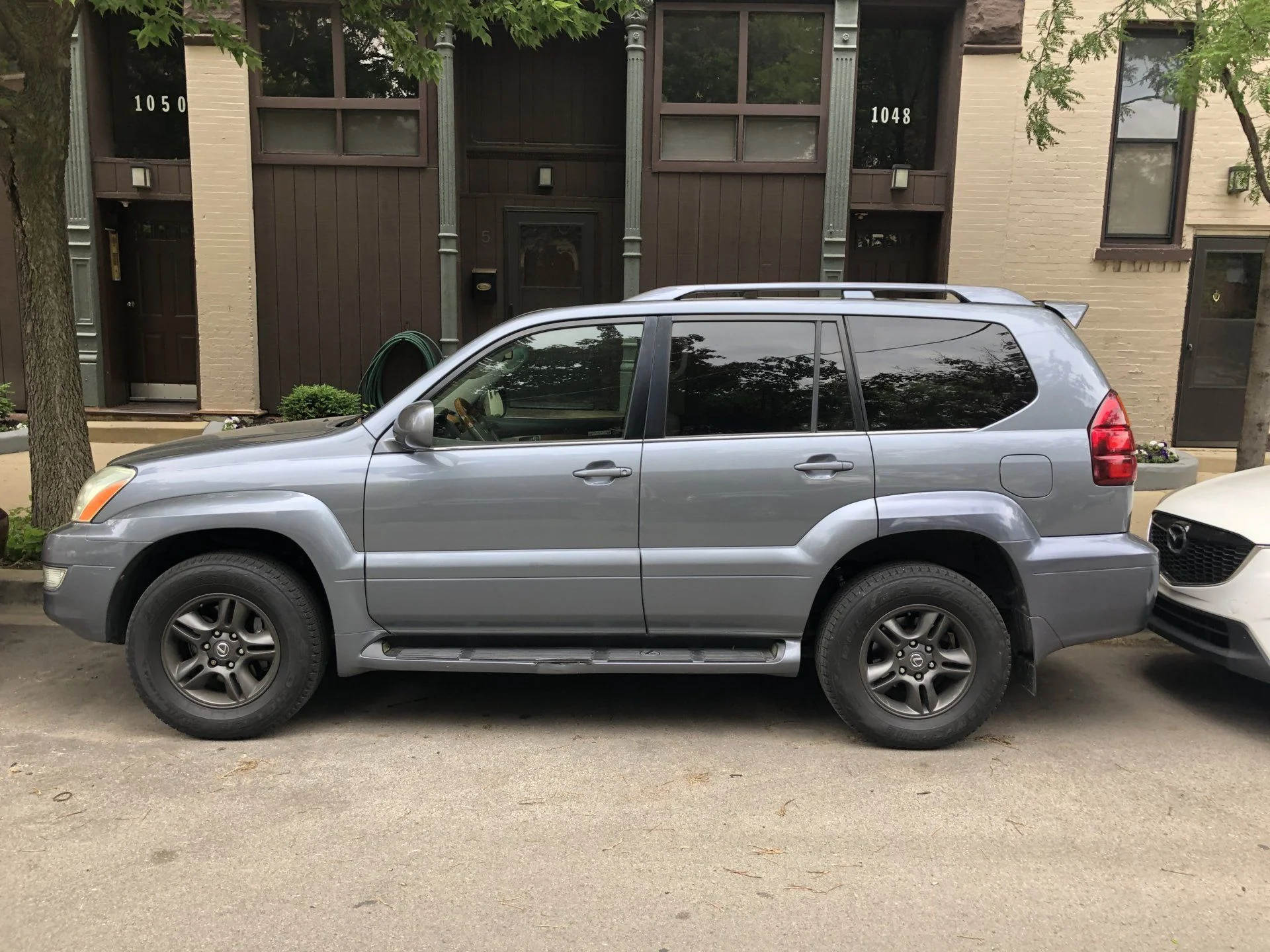

For anyone considering this in the future here is what I did for my rear air bag to coil conversion:
- Moog 81081 coils (FJ coils)
- Bilstein 5100 33-187174 shocks (4Runner shocks)
- MetalTech Stage 1 kit
- OEM coil spring insulator part #4830235040
The GX rides like a dream now - much better than before. I didn't realize how much this would improve the ride quality. All bumps feel either inexistent or incredibly smooth. Fast turning has much less body roll. I have not felt a difference in emergency braking like I had read from other users. See the pictures below, it looks like it's a bit higher in the rear than it was before, but this should level out as the new components settle. Also, it took about 2.5-3 hours to install.
