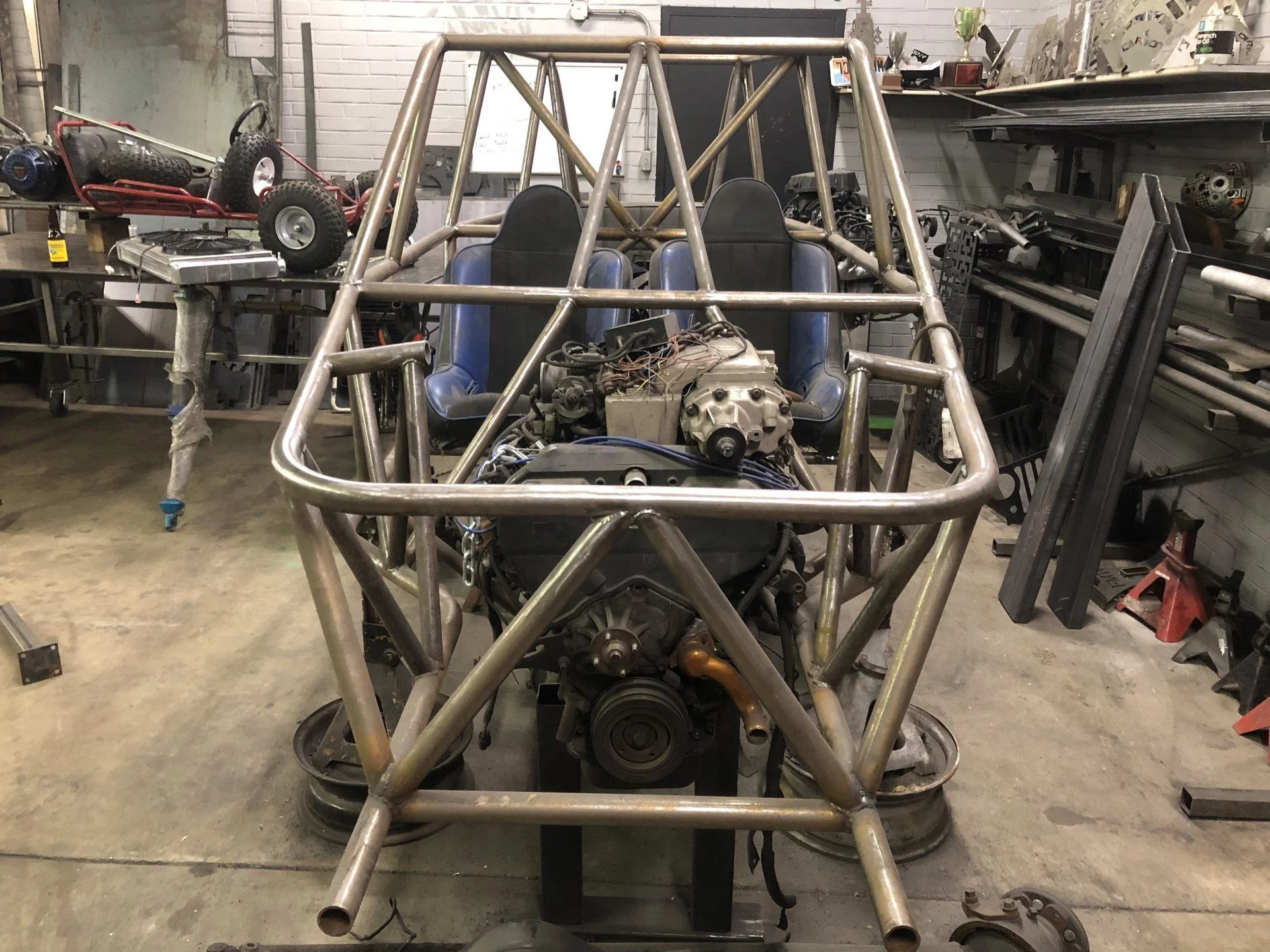

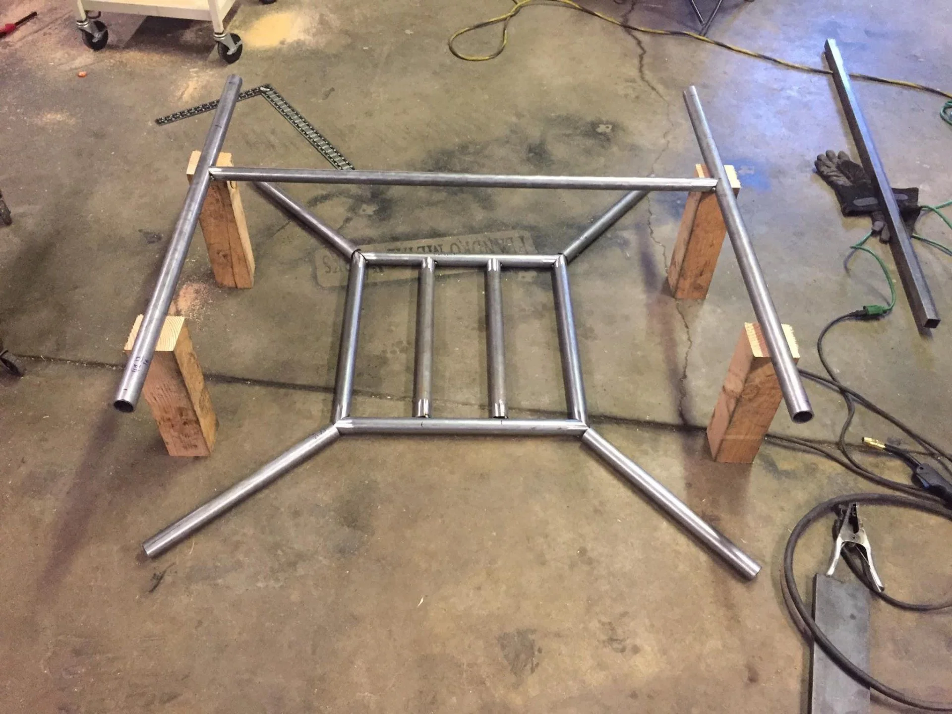

I built this chassis two years ago but I’m finally getting serious about completing the build. For those of you that don’t know me, I’ve raced Ultra4 and competed in werock for the the last 12 years or so. I recently sold my Ultra4 car and I’ve been wanting something more “bang for buck” I miss the days of wheeling my inexpensive Toyota truck that crawled insanely well but unfortunately I’ve grown accustomed to the fancy coilovers sand horse power of my race car.... I need something in between... oh and I want a back seat for my dog lol
The basic build is
Super Charged 3.4
R151 turbo trans
Toy crawl Box
Atlas 3.8
Fzj80 front axle
Fzj80 rear axle
ADS coilovers 2.5x14
40 in stickies

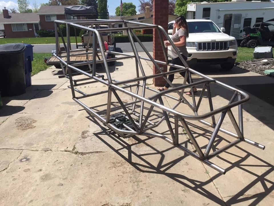

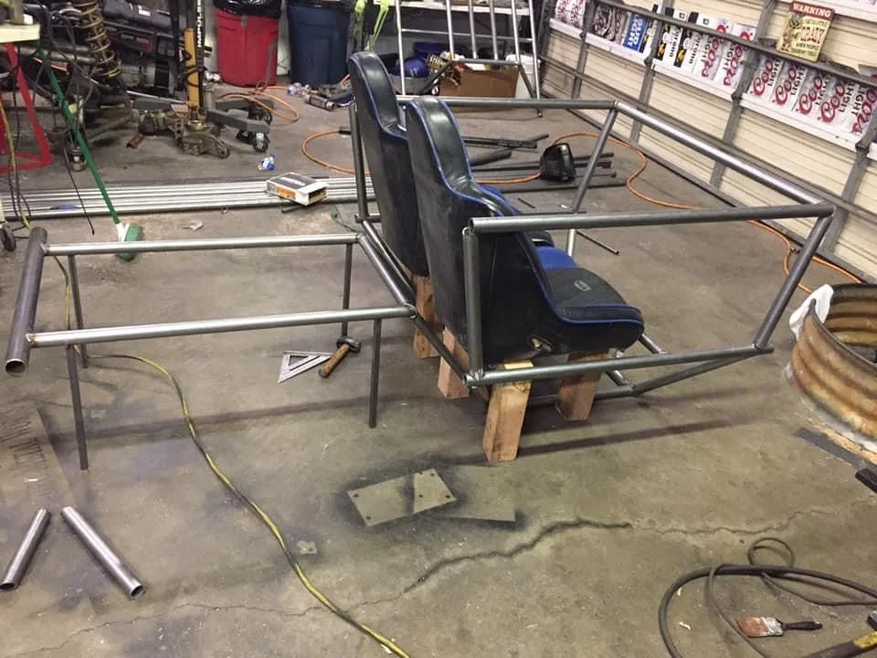

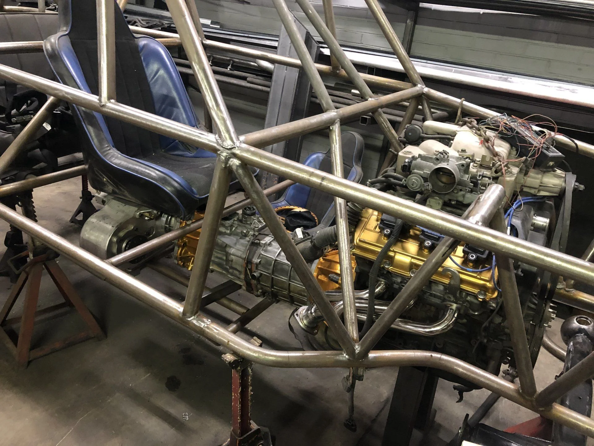

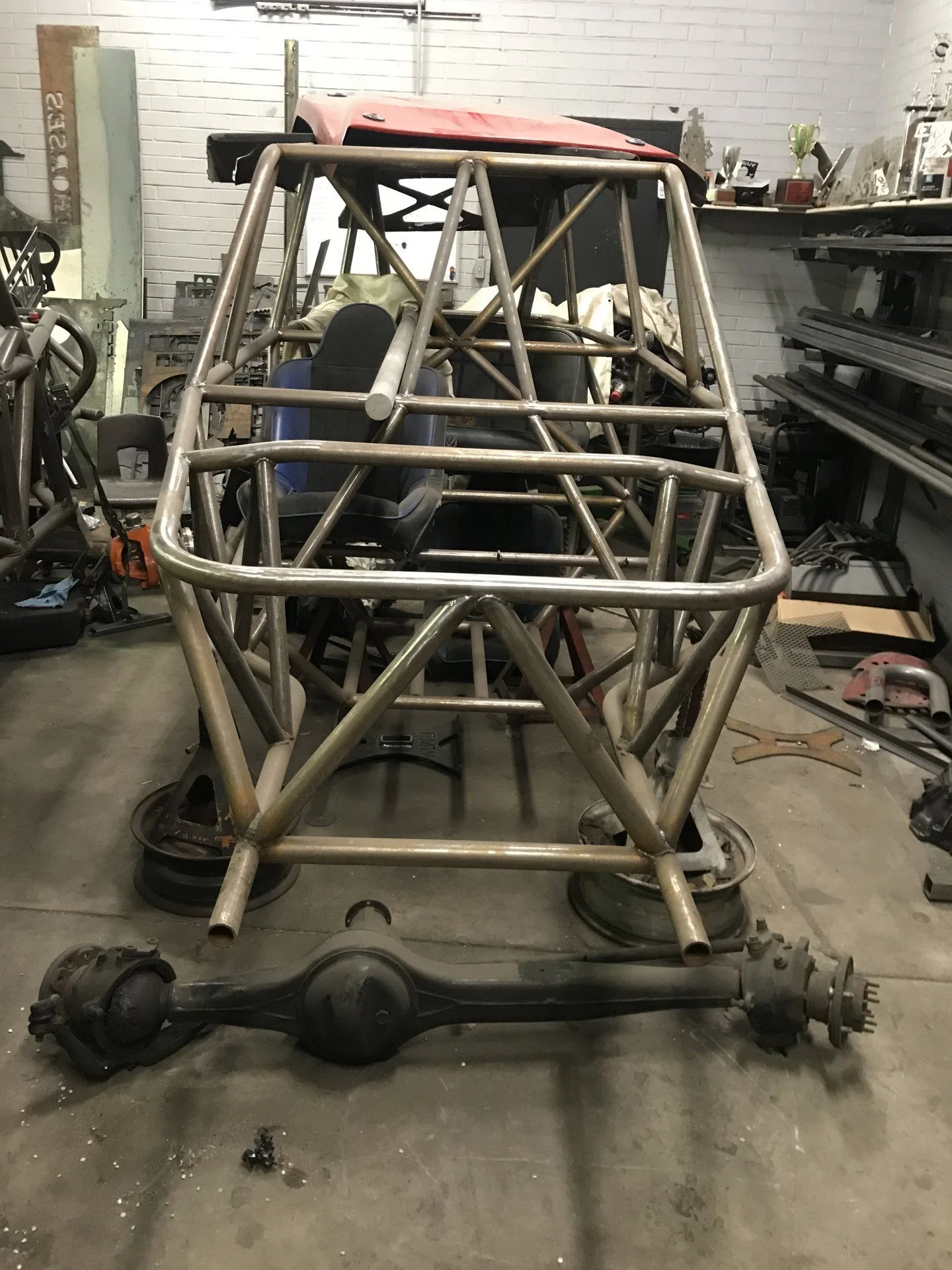

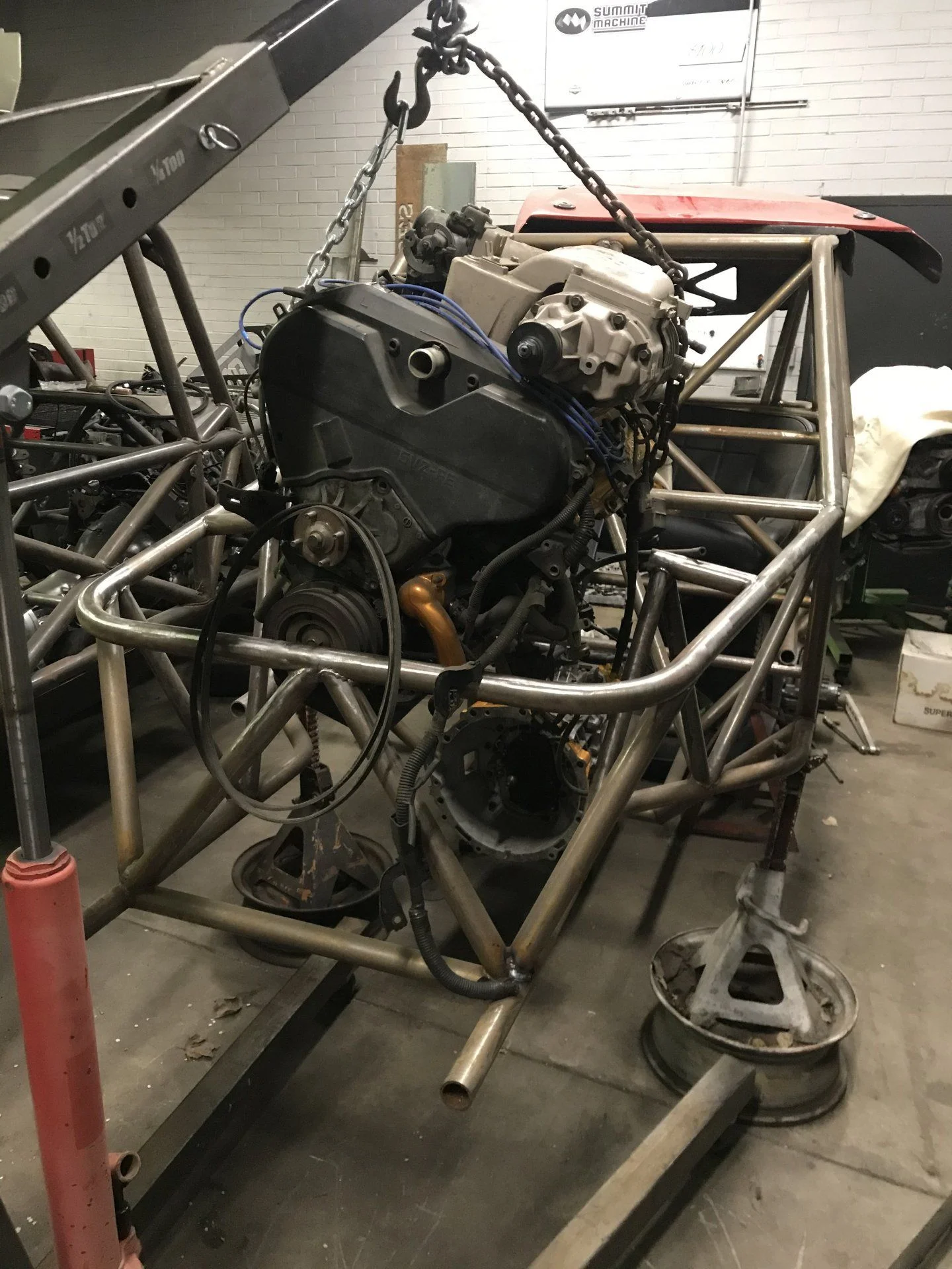

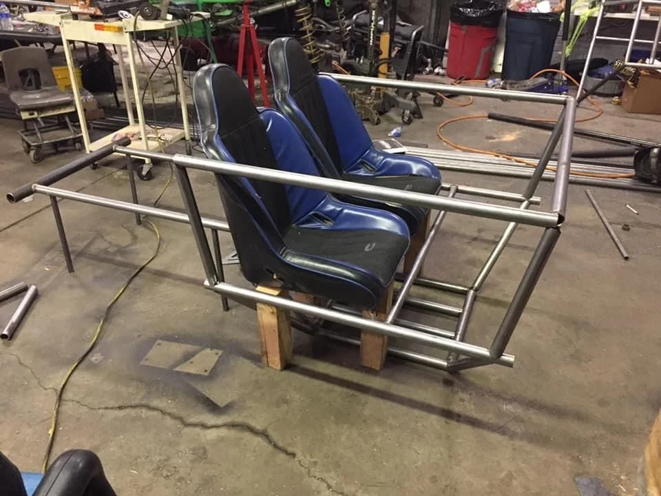

Here are a couple pics from building the chassis

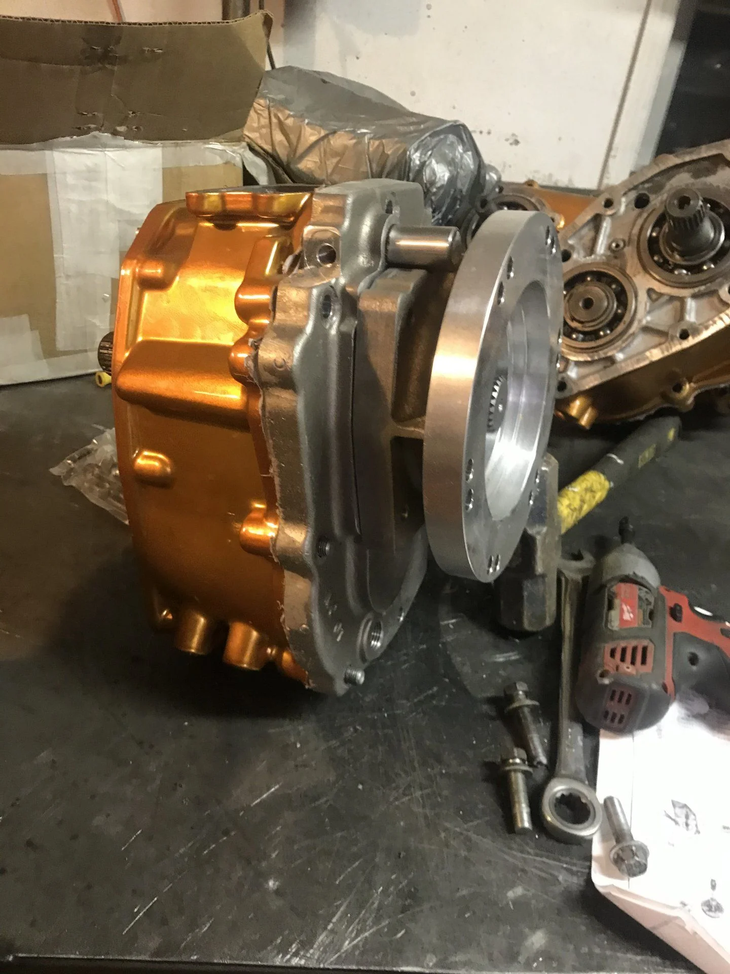

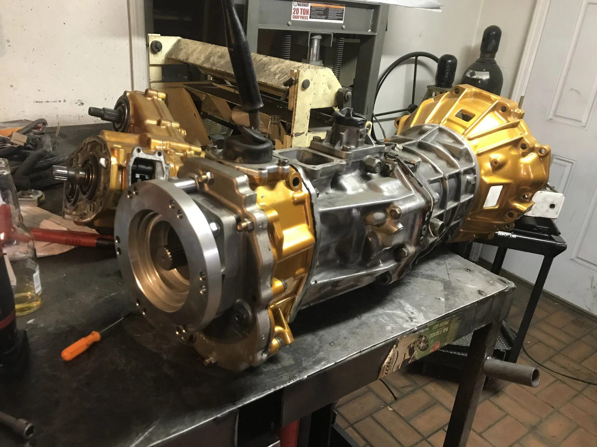

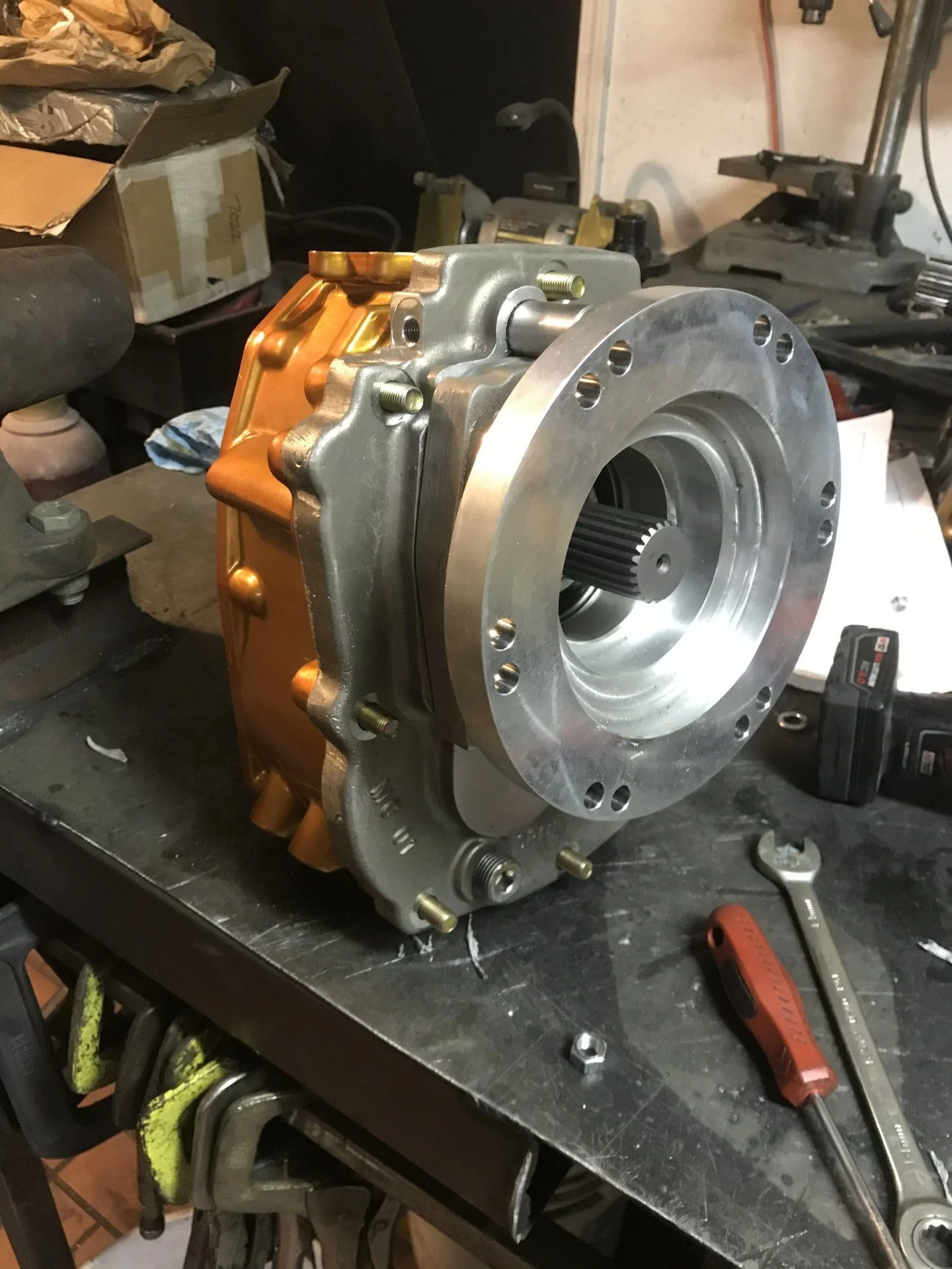

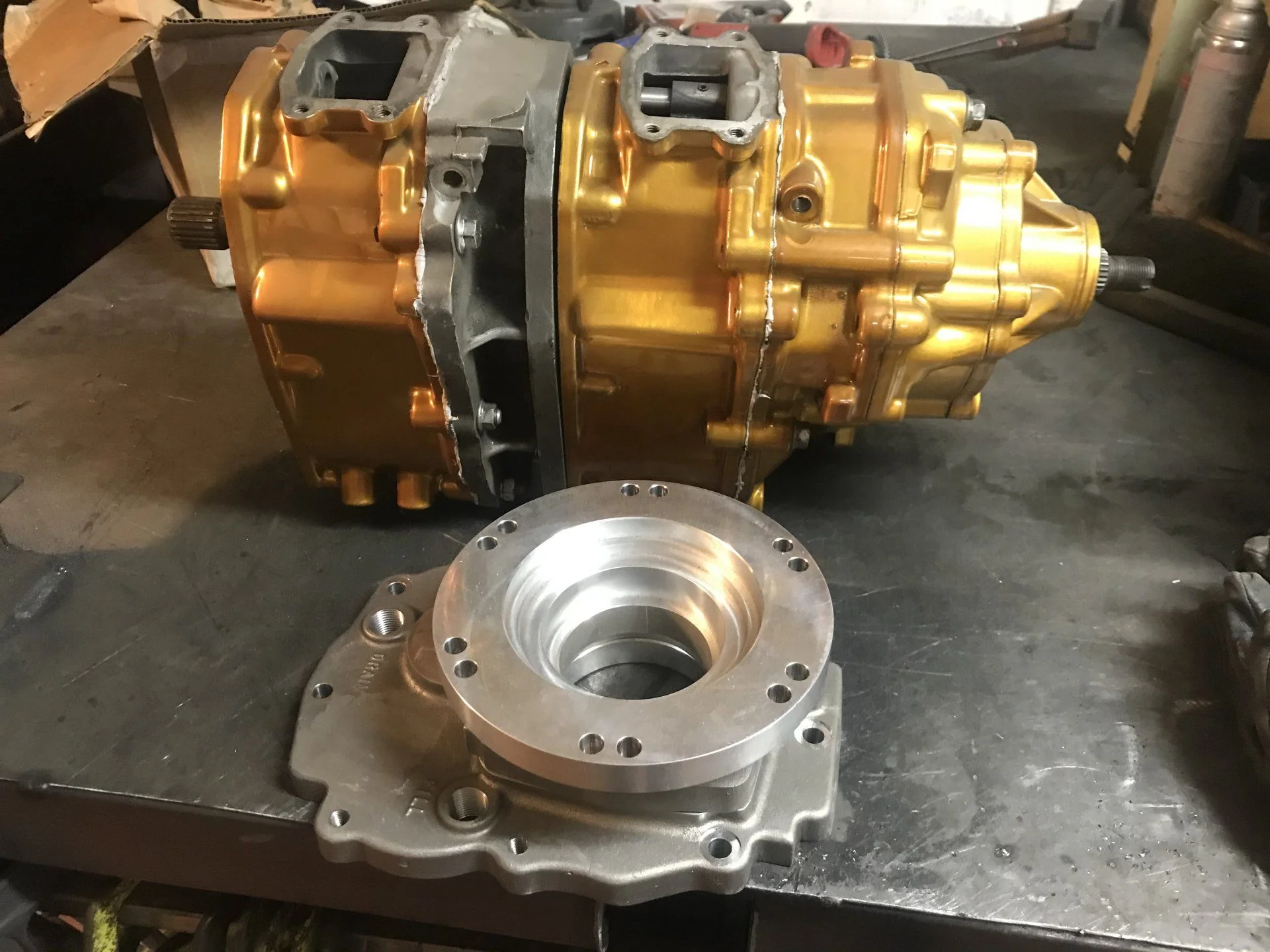

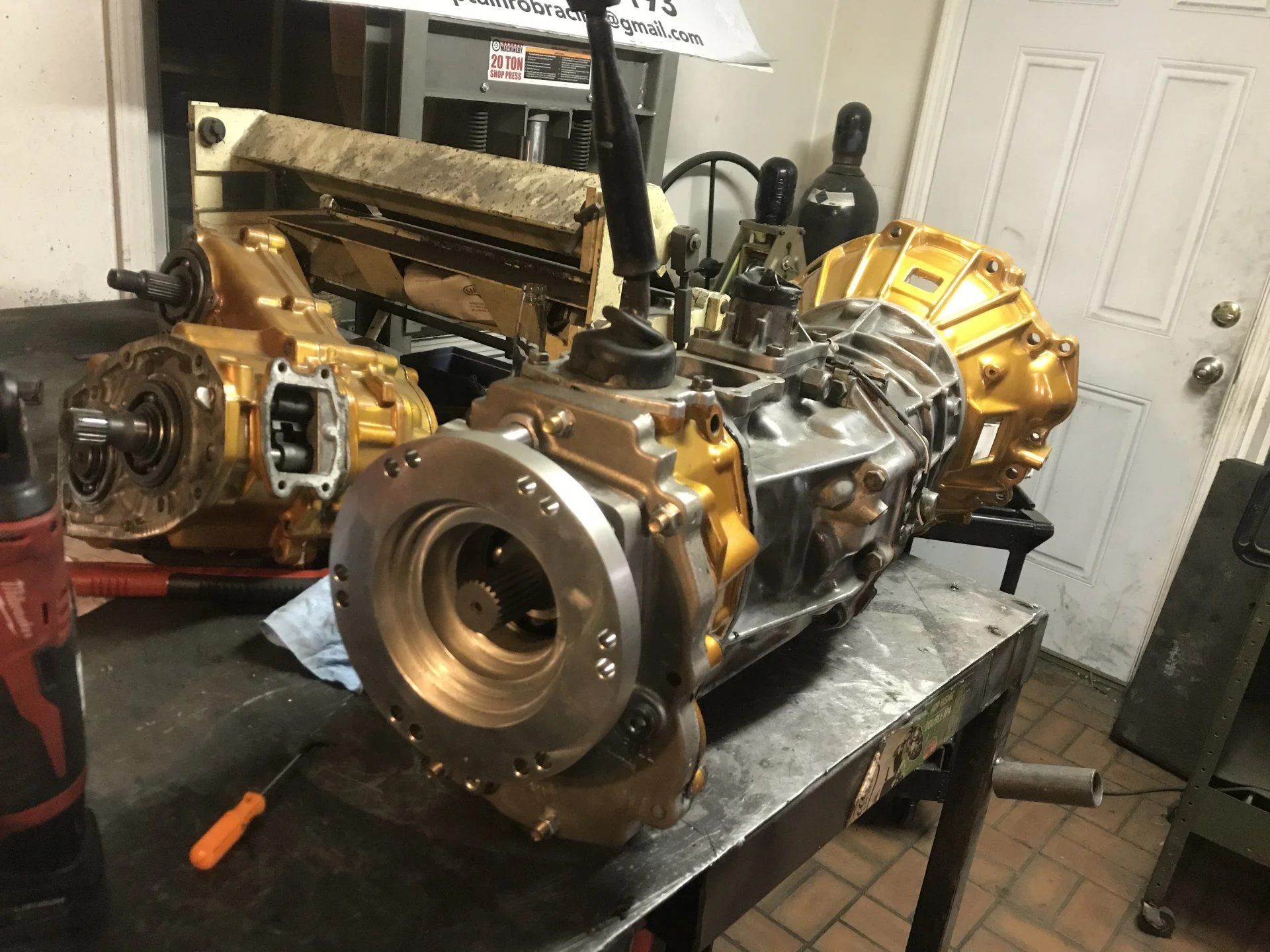

Here’s some shots of my trans and tcase build
I originally was just going to stick with regular dual cases but I really wanted front dig, my next want was a dana300 behind a crawl box but after pricing out parts to make the 300 worth while I just ordered an atlas
Did you design that chassis or is it from a shop / kit type situation?
Looks killer.
