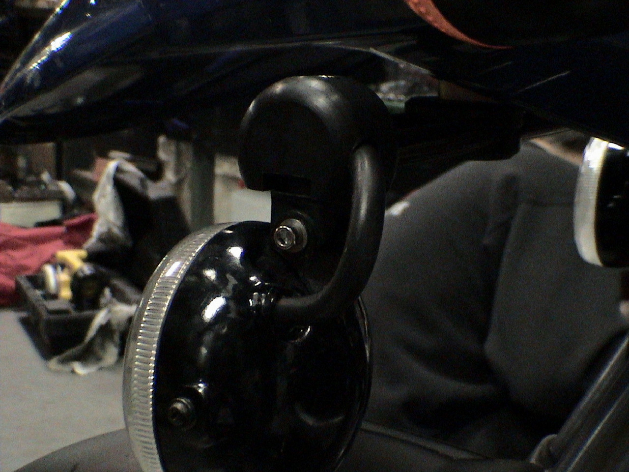

El Cheppo LED square lights "Reverse" lights, well more like "Work lights" (Key off) mounted on a 3 axis Gimble" (my first motorcycle product from 1997) at the very outside corner of the 80-20 platform.
As always to advance for the time or in other words I suck at reading the market "Needs" but I just refuse to design for the "Minimum common denominator", the coextruded carbon tubes dampen vibration and in the case of a really horrible crash they Pulverize them self..
If the fall is not so horrible, the just slide on the mounts, 6mm allen and you are back in business, never a bend front sub frame like with most of the other ones.
