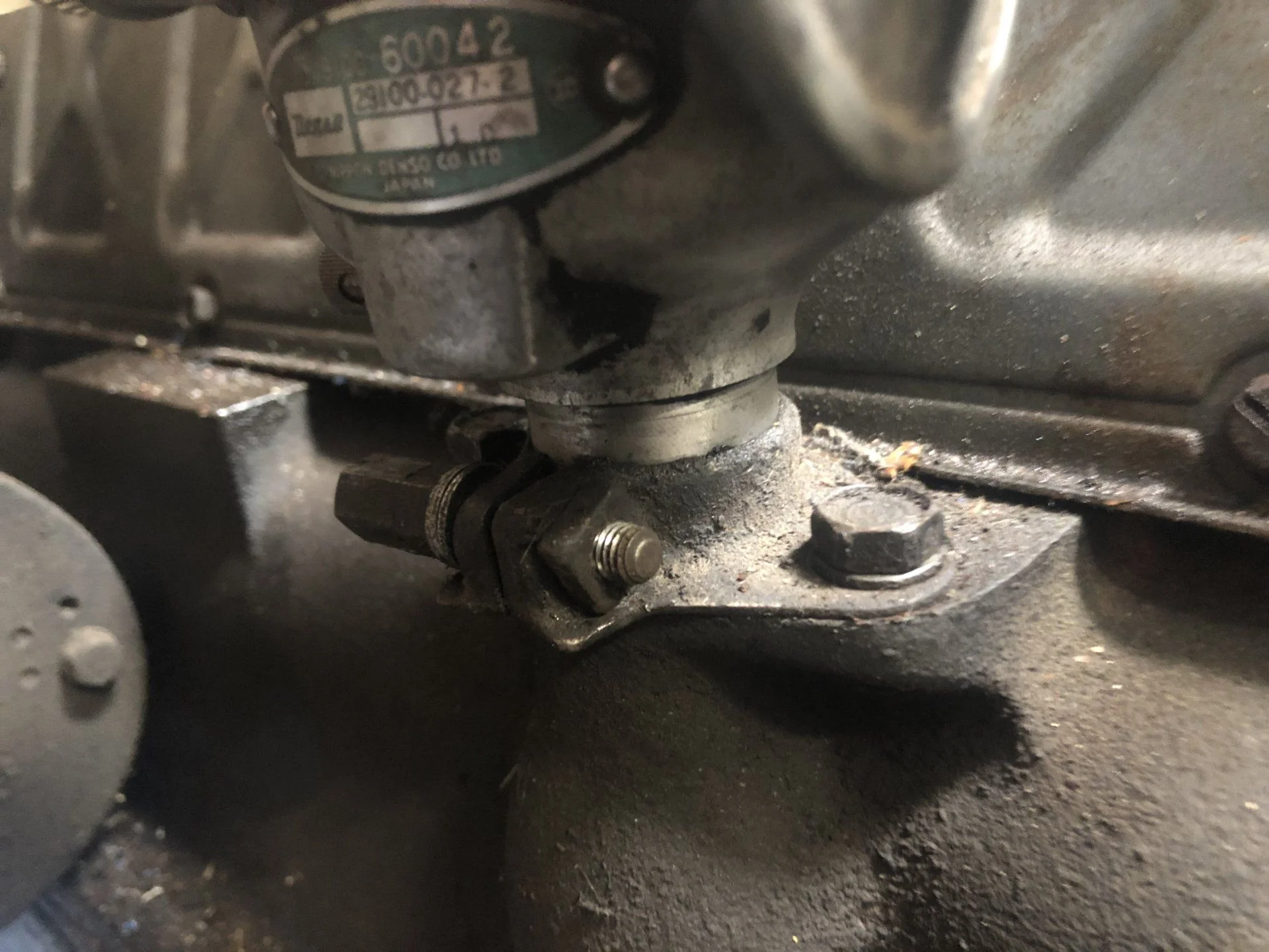

I took my 67 FJ40 to a local mechanic to help with an ignition wiring issue I couldn’t figure out. He took out the distributor to check something and then re-installed it. He started it up and the motor seized after about 5 minutes of running. When I went in to check, it looks like the distributor is not seated all the way, which means the oil pump was not engaged.
