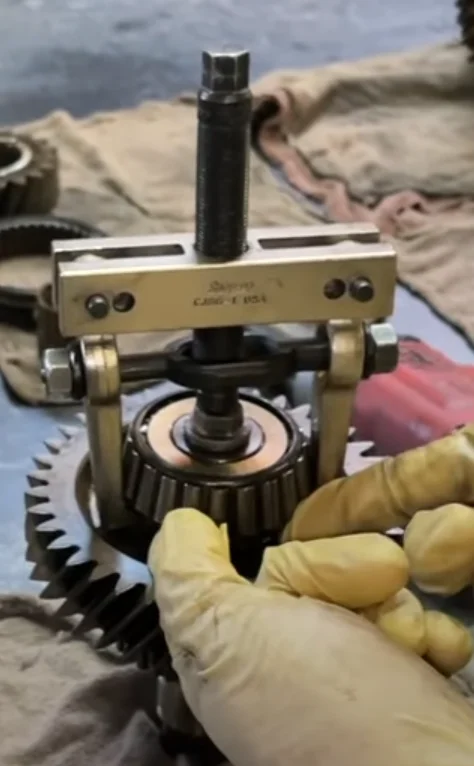

I'm looking for a recommendation for a tool to remove the large bearing from the small gearset in the transfer case. Georg at Valley Hybrids (@orangefj45) uses a Snap-On CJ86-1 two jaw gear puller at 10:52 of this video () to pull the bearing I'm referring to. I got the set of four 3-jaw pullers from Harbor Freight for the job, and broke the teeth off the smallest puller (the only one that fit here). Any suggestions for a specific gear puller that will work for this specific bearing removal? I'm stuck on this bearing.
Thanks.
I’ve tried a few pullers and that’s the only one I’ve been able to use easily & successgully.
