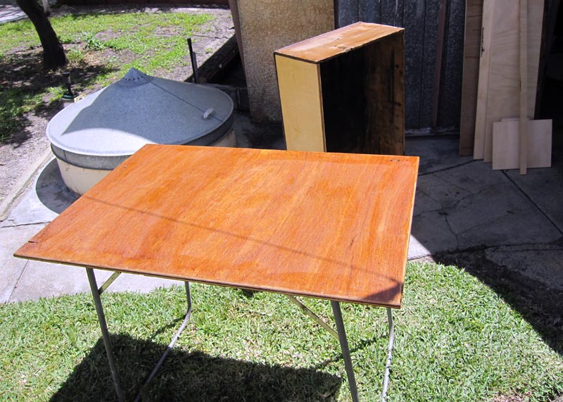

On long trips in the oz bush I load 5 cans on the roof. 4 with diesel and 1 with petrol for the minibike in the back. The main tank holds 160 litres, so total I have 240 litres and that gives me a safe 1000+ miles range.
I have a marine ply box that allows 5 cans to sit on edge with room for a wide section of 1/4" thick conveyer belt rubber between each can and also between the cans and the bottom of the box. The belt is free as scrap from a local rubber supply.
I then use a furniture strap to hold the cans down. The plywood box is captured on 3 sides by the roof rack sides and the food box on the roof. Along with the strap, nothing moves and I've used this scheme for 20+ years with no issue. Gives you some good exercise heaving the cans up and down, so having a mate on the ground to help is a BIG plus :)
I can also put 2 cans flat in the plywood box for short trips where I want one with petrol and a little safety margin in diesel. I have slots down low in the sides of the ply box, so I can run the strap through the sides and keep the two cans down and rattle free
Here's pictures of a recent 'freshening' up of the box and camp table I use. Many years use and the fuel box was showing signs of damage from many scrapes and hits from low trees and scrub. Replaced one panel with a new sheet. Also recycled the lid of the food box to make a new top for the camping table (the old chipboard top was disintegrating).
cheers,
george.
