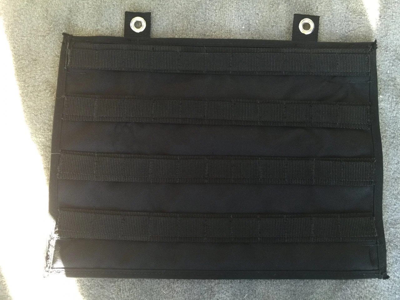

I love my troopy dearly, but as cavernous as the rear bay is, it lacks storage of any kind. I've had a box (good but unwieldy and takes up too much room) and a bag (too sloppy and not organized enough).

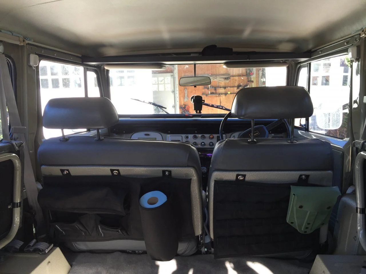

So for a while now I've had this idea of using the bolts on the backs of the seats to secure a custom-made set of storage panels. And so we arrive at the attached pictures and the nearly complete first draft of this idea.

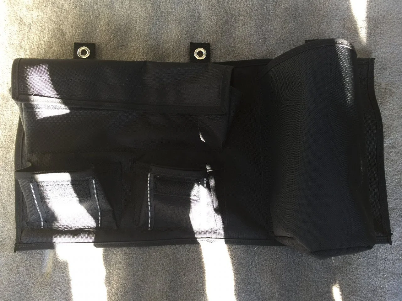

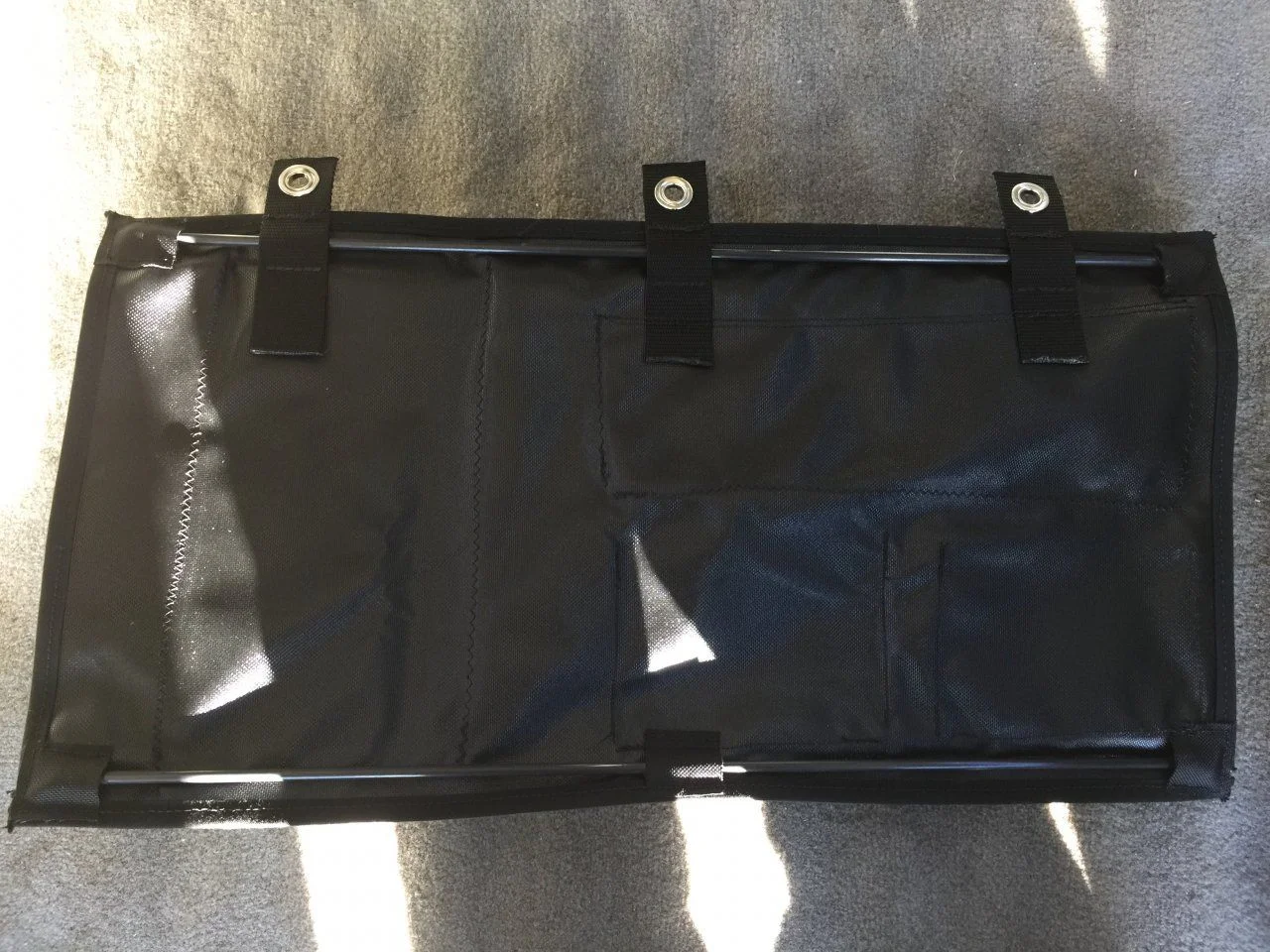

You can see that I did a molle-compatible series of straps on the back of the driver's (RHD) seat and on the longer passenger seat, a tall pouch to hold paper towels and then three additional velcro-closing pockets (one long, two smaller) for various bits and pieces. On the rear of each panel I threaded tent poles cut to size at the top and bottom to keep it rigid from left to right.
So far, so good. I have a little more sewing to do on my trusty Sail Rite Ultrafeed and then this small project will be out of my head. I already have thoughts about how to improve it and there are, of course, tons of ways in which it could be varied/adjusted to specific usage. One of the most basic adjustments is that you could have the large molle area on the left and the pockets behind the driver.
