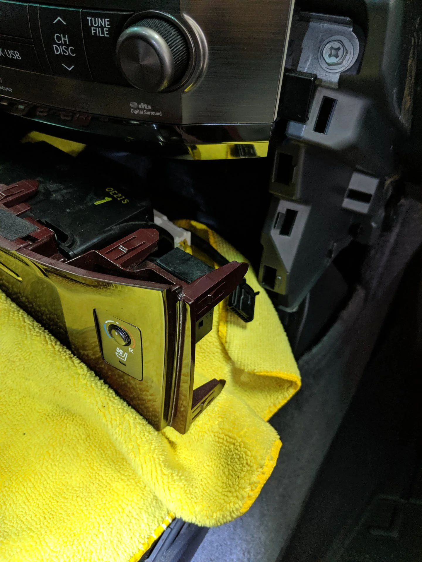

Since my passenger side seat climate control (heat/ventilation) wasn't working, I decided to swap the switch with driver side and check if the switch itself is problematic. After opening the panel I realized the passenger side switch is different than the drivers side and the harness is not compatible between the two. (note the difference in color! Drivers side is grey and passenger's is black).
Is this normal or the previous owner changed one of them?
I should also mention it is a 2010 LX.
