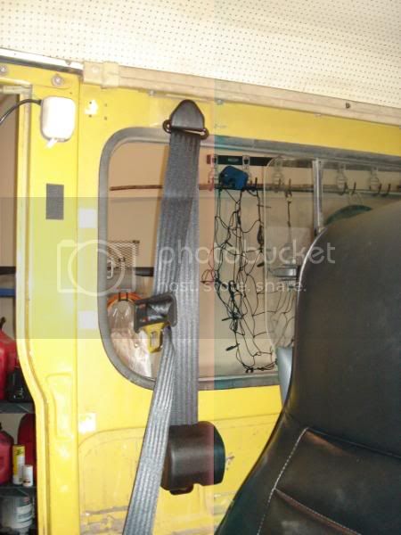

Thought I'd replace some non-working belts in the Troopy (make the wife happy for the kiddies)...
Got some seat belts from a little place in Texas:

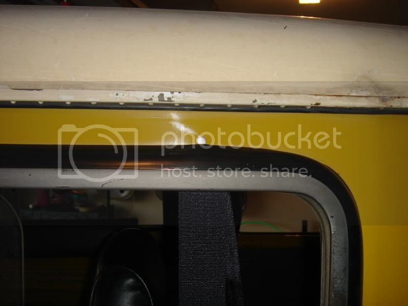

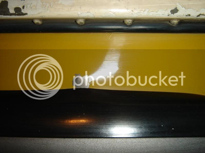

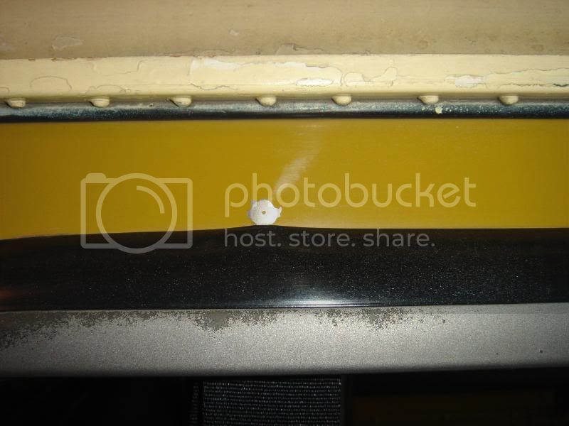

Bolts included as well as spacers (like the OEM ones) to allow the belt to pivot. Hooked em all in and tightened em all down. However, looked outside the rig and OMG! ...yep ..pushed the metal out, paint etc...
I'm a dumbass... never even thought about it. Hope it'll help someone.

Don't put yourself through the trouble on the bolt length. I have the old ones.. yep... shorter... I'm just p*ssed that I never even thought about them being too long... lol. That just sucks. Raw metal.. prolly rusting as I sit here.
