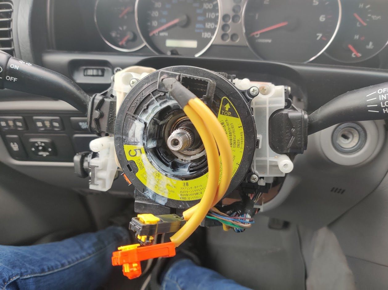

Here are some pictures of the teardown, wheel still on but airbag removed:
Wheel removed (I think the white stuff is evidence of my first failed attempt of spraying in the access port with white lithium grease):
Clam shell breakdown:
With clam shell removed:
Clock spring removed and sensor off (there is no reason to remove the sensor, I was just having a look around):
My grease application (it's a bit hard to see, it's the white lithium grease between the white plastic piece and brown spacer of the sensor ring):
I used a very thin plastic toothpick to try and put the grease only between the white plastic piece and the metal sensor ring's brown spacer. I didn't want any excess to end up in places it shouldn't be, and I especially didn't want interference with the sensor.
So far I would call it a success. The next morning was in the 40's and I think I would have heard the sound if it had not been remedied, but it has been 55+ since that morning so I can't say for sure if my noise has been cured.
