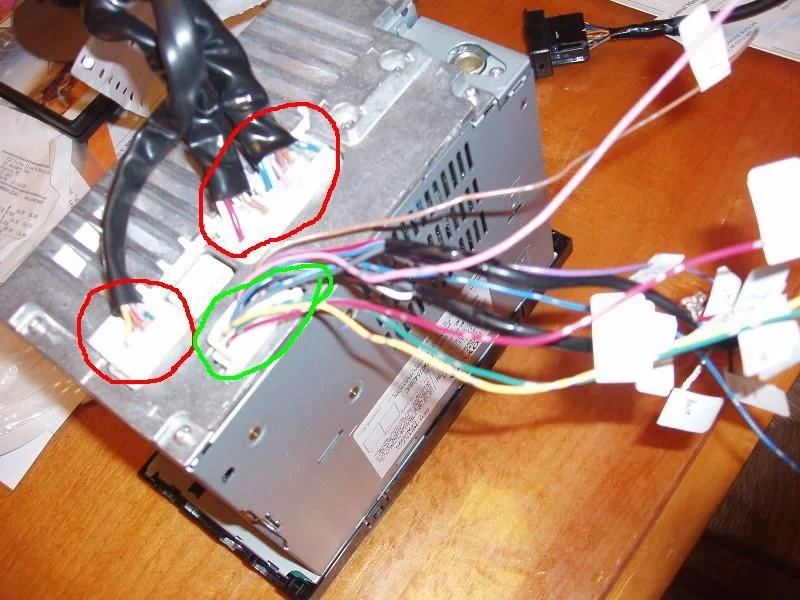

So I wanted to put a Scion head unit with ipod control in My wife's 80. This is the newer upgraded headunit. I bought one off ebay from an auto recycler. Got the unit looked good with all the harnesses in the back cut off a short distance off the radio.
Did some background and found that there is a cable off the back of HU to the ipod control that does not have a part number. So there are three cables. One out of the head unit: this links to another cable that has an Ipod port in the console, (PT546-21061), Then from this to the Ipod is a cable PT546-21062.
So I had part of the cable off the head unit that links to the cable I have, So I figure I just need a connector and can just match colors, well the colors don't match. So I match wire numbers from a scion wiring diagram and then put in individual connectors as I could get the unit from cdan or local toyota but I need to get this done today, Plus that is just the connector, not wiring or anything else.
http://img118.imageshack.us/img118/7529/radioconnkq9.gif
http://img93.imageshack.us/img93/9489/radioct5.gif
So I splice in some wire and then do connectors. This took quite some time. The wiring did look like it was patched together as reported on scionlife.com, was different than any toyota wiring I have seen before.
So then put the radio in. Usual stuff as all the scion transplants documented before. I have the picts but it is available elsewhere and pretty straight forward, unhooked the amplifier to the right of the glove box and it work right away,
Then checked and rechecked and played around with the mounting a bit, needed to trim the head unit and the surrounding plastic. this is the final result, prior to smoothing the cuts off and firmly mounting every thing back.
Take home message, I think it is totally cool to now have a headunit directly driving the ipod that looks factory. However the amount of time I spent dealing with the wiring makes me suggest you think really hard about doing this. Unless of course you get the wiring in its entirety with the head unit. I did call cdan and he sent me all the wiring available. If I did not have the cut of section I would have really been screwed.
I hope this makes sense if it doesn't let me know. Took me over 8 hours to do this, but considering I am unable to use my right hand due to recent surgery could be much shorter.
John

I think I understand your write-up but need to verify: When you refer to requiring the wiring off of the back of the donating car's head unit, does it need the donor's wires circled in red, the ipod control circled in green, or all three?

The cable you have to get with it is the bottom cable. The one circled in green. You can see in my last picture before install the splicing required. The other upper cables are the generic toyota inputs so they are all the same hence the reason we can switch these scions in the toyotas so easily.
If you get the bottom cable with the radio I think you will see that it might have been an afterthought as it had some wiring that did not look factory but was. That bottom cable was the only one you can't buy from toyota, though I don't know if that has changed since I did the install.
So you need the cable from the bottom back of the radio, this should meet at a connector with the ipod port that goes in the dash. Then there is a wire from the port to the ipod. The ipod port and cable are available.
Looking at the auction listed, I am not certain but think the cable you see there is from the ipod to the plug only. Not the difficult to find wire. Though You might want to see if that cable is available now.
There are 3 cables in chain from that bottom port. 1st The wire I couldn't find and made my own, second the connector to ipod plug (the one spliced in in my pictures marked ipod), 3rd the ipod plug to ipod cable.
Hope this helps if it doesn't let me know.
