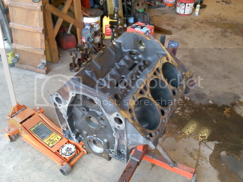

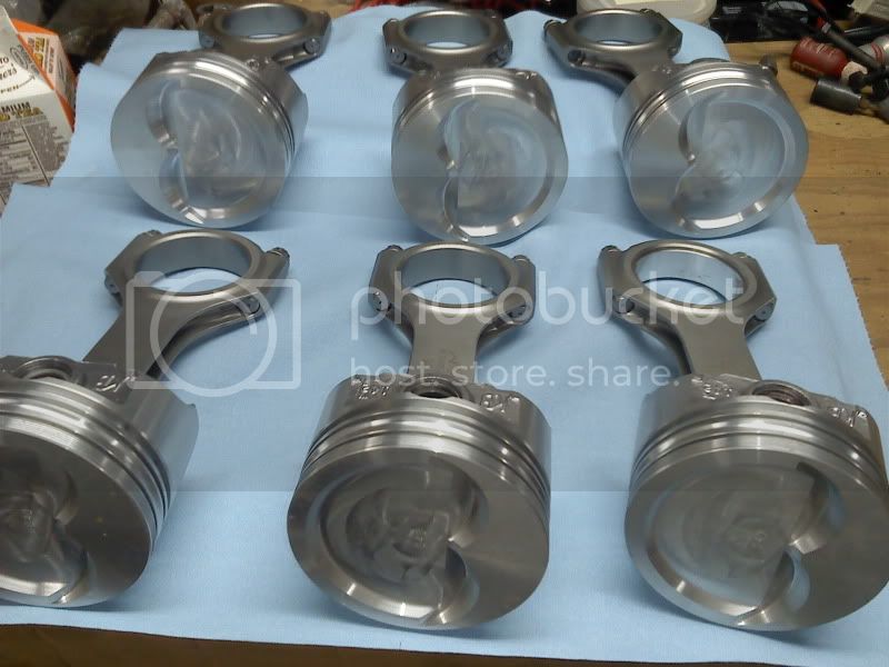

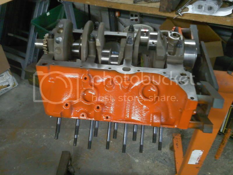

I was going over my options for a power plant i think i have my answer to not having just another SBC

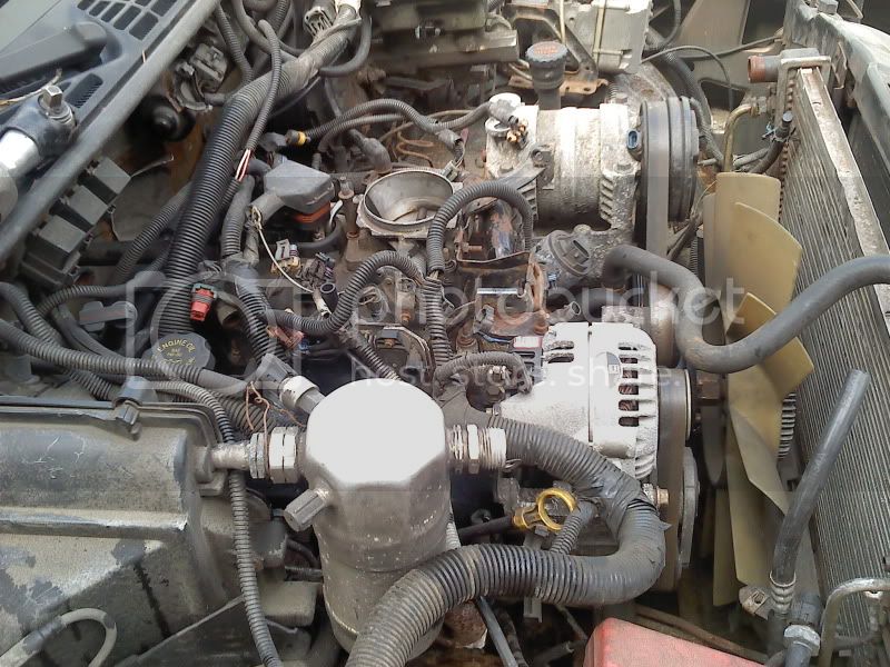

Its a 4.3 out of a 96 blazer
so i got it home and cleaned it up
then i started to spend the money

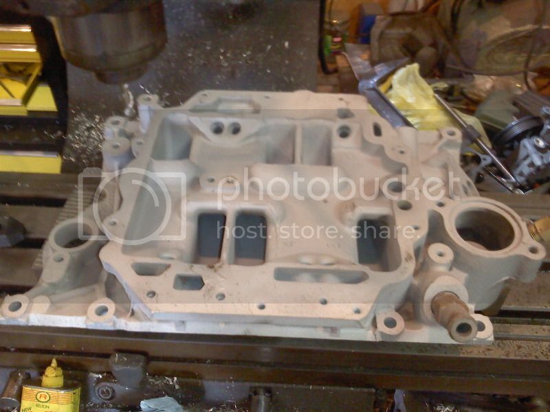

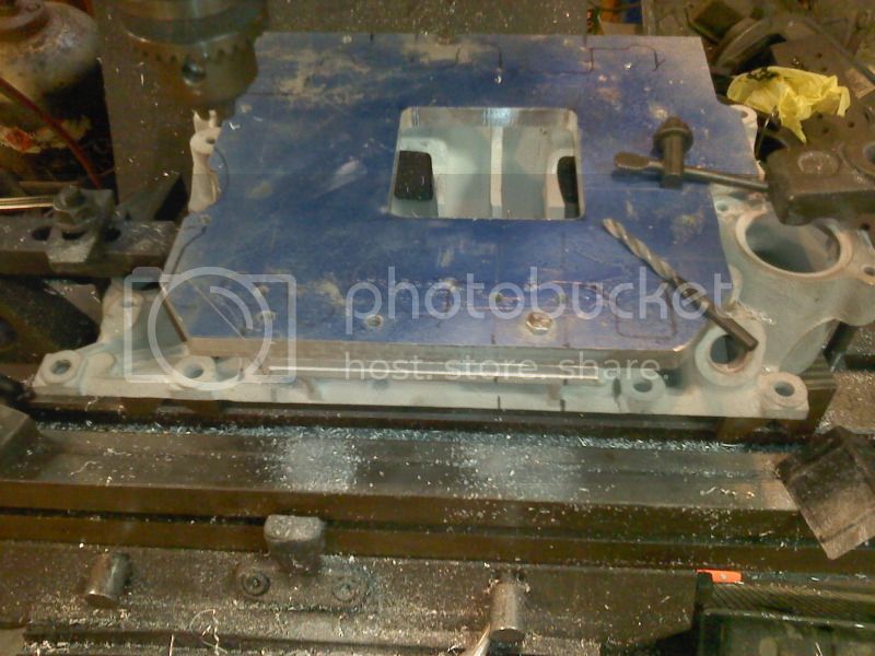

took the intake and cleaned it

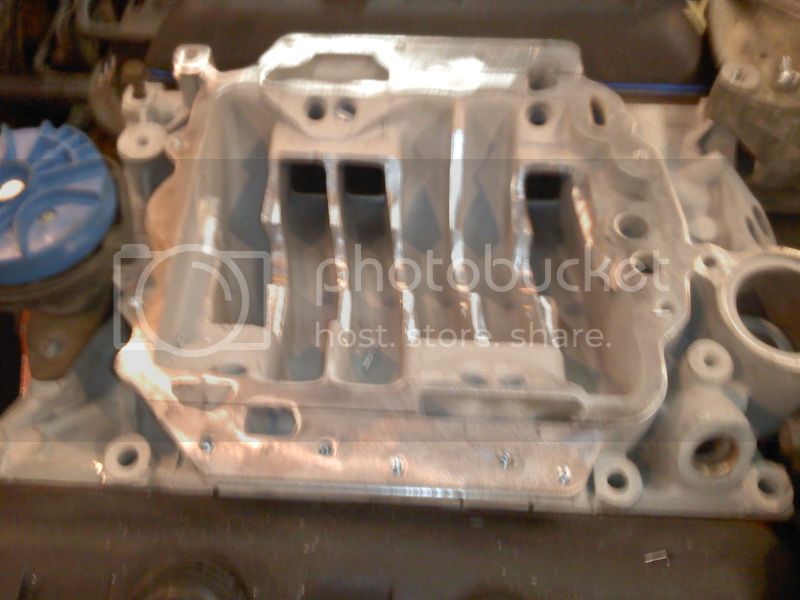

then milled it out

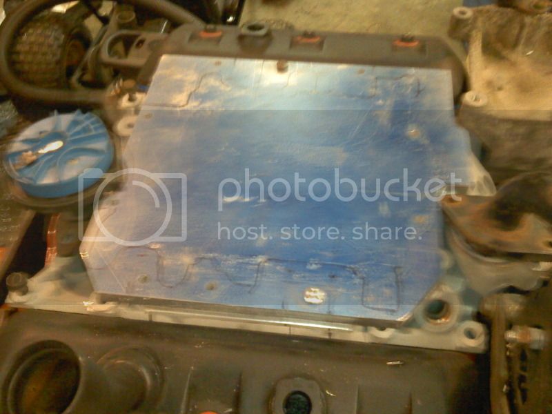

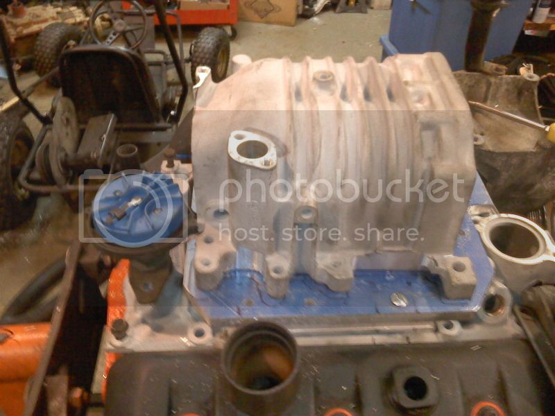

Got the adapter plate fit and machined

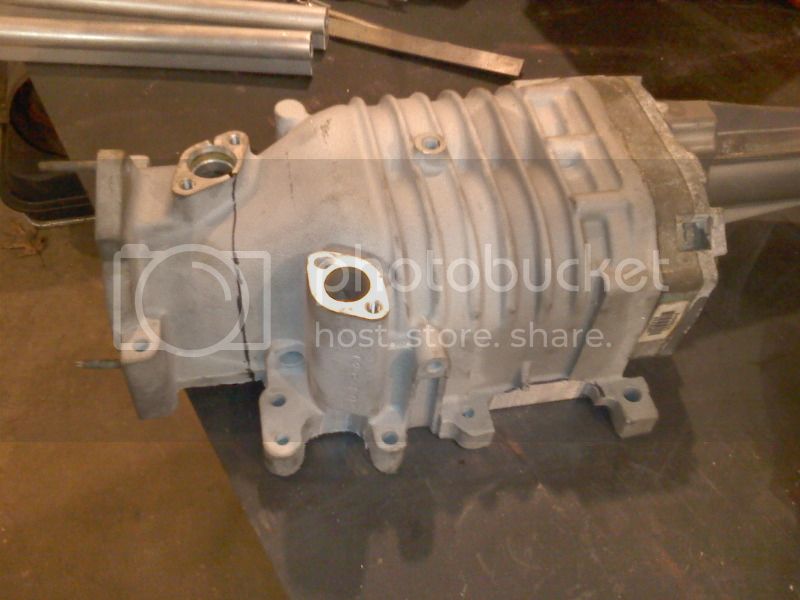

then I started to cut up a PERFECTLY GOOD BLOWER

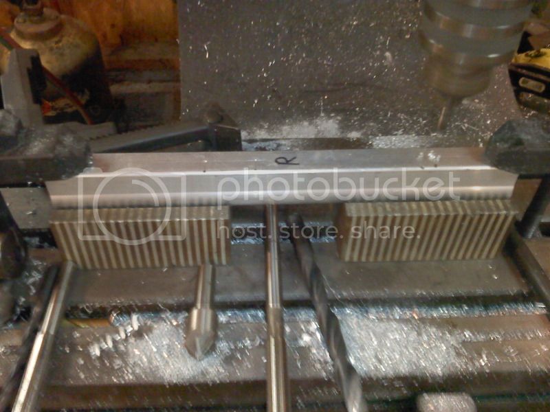

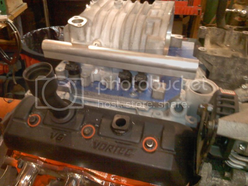

The real tricky part was making the fuel rails and drilling there injector ports
and here it is so far there are allot of little things to do yet and allot of parts to get but this is where it stands as of today

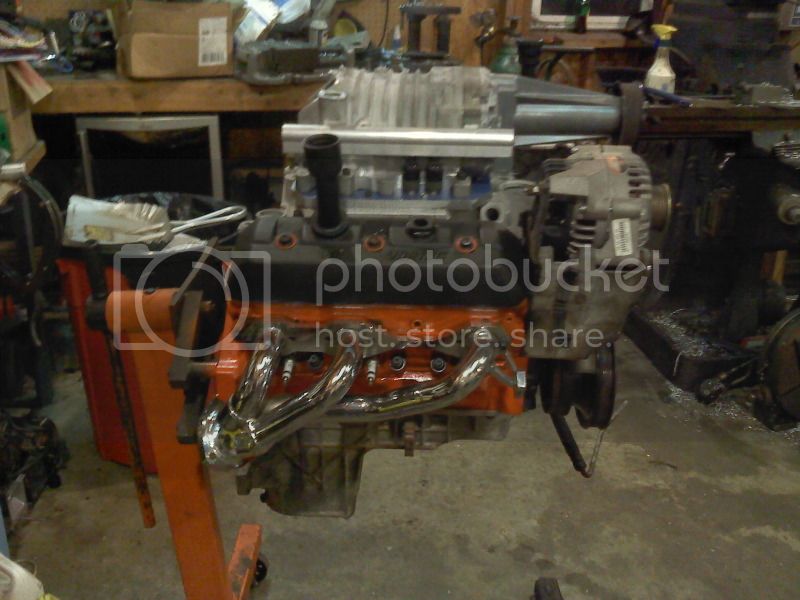

HERE ARE FINALLY THE PICS

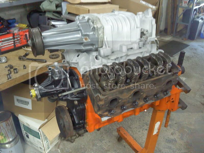

And here it is together
