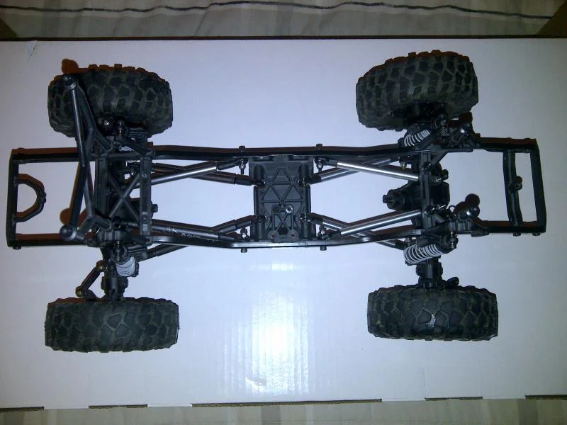

Here is the truck right now
It now has an scx10 frame and a 4 link in the front and rear. 70mm links in the rear and 68mm links in the back(for those of you interested in making your scx10 and fj40...need to get a pair of lexan scissors next time:D
Also decided that I will make extended shock mounts in the rear so that I can run longer shocks
100mm shocks in the front should be fine with 120mm in the rear...I don't think 120mm shocks in the front would be adviseable since the tire is already tucked all the way to the fender when flexing. I want to keep the scale look so I will see once I decide on tires. I am thinking a 4.5" tire. Option 2 would be to just have the 120mm shocks mounted to stock shocktowers all the way around and take advantage of added "lift"(not sure how this would look though)

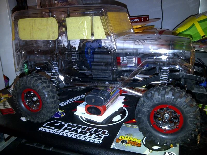

I decided that I want this thing to be the ultimate backyard basher! I got rid of the axial crossmember and tranny mount and decided use a 2 speed transmission from a first gen traxxas e-maxx! Dual motors and shift on the fly is the goal here. I was going to mount the tranny on the axial x-member but wanted a lower COG and better driveline angles
Also picked up another FJ40 body since the first one was basically screwed! Can't wait for the emaxx tranny mounts to dry:D Since I cant use a skidplate, I will eventually get a metal case for the tranny, when it breaks
Here is the mocked up emaxx transmission.
Nice progression. Did you keep the original crawler or is it all gone? Emaxx trans, I like your thinking, though if you are gonna really haul *** you are really gonna have to develop your driver skills. I find myself flopping my honcho with a 45T in turns pretty regularly.
Lol the original crawler is all gone! I know what you mean about the driving skills! Lets see pics of your honcho:D I'm thinking dual 35t motors in the emaxx tranny:hhmm:
