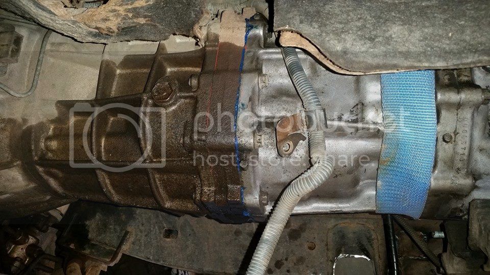

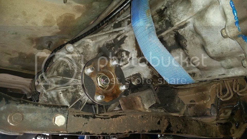

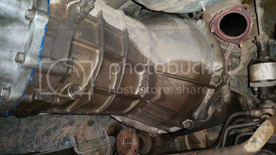

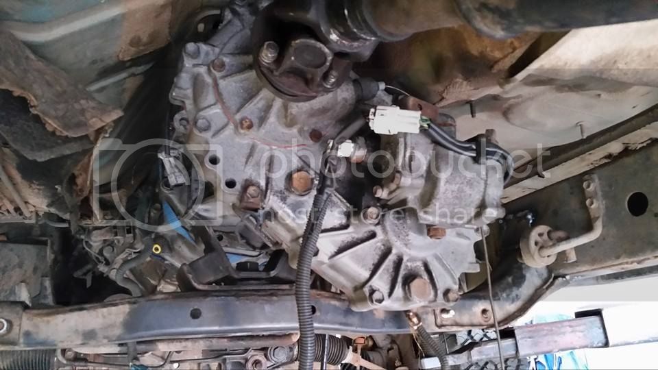

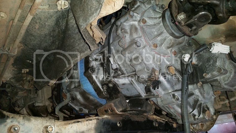

Well 80 series transfer case was a no goer. There was far too much to alter and adjust to make it feesable to use so I went for a surf one. Now when people tell you that they just bolt on DO NOT believe them. First things first you will need a 40mm minimum body lift. Our transmission tunnel is shaped to the passenger side to allow the transfer box to fit so coming down the other side the isn't room. Thankfully I have the lift. Next there is the final bearing on the output shaft of the gearbox which needs to be swapped over for the one from the surf box. Then there is the fact that the selector fork in the adaptor box in much thicker on the surf and has to be ground down to fit. Both the gear leaver and transfer lever are much further forward so centre console will need to be rethunked.
But all that aside it's in. This does mean that I loose full time 4wd but that's not a massive issue. might even help out the fuel economy. lol. So is the rear axle. Ride height is a little higher than I had hoped. I can't remember what everyone else was measuring but from the top of the rim to the bottom of the fairing it is 53cms.

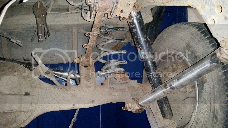

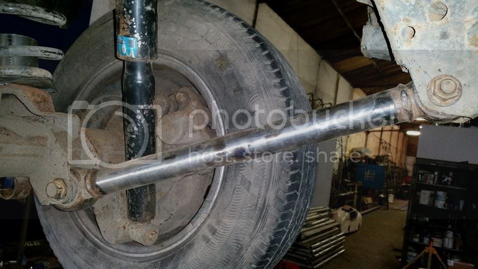

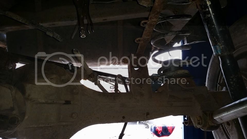

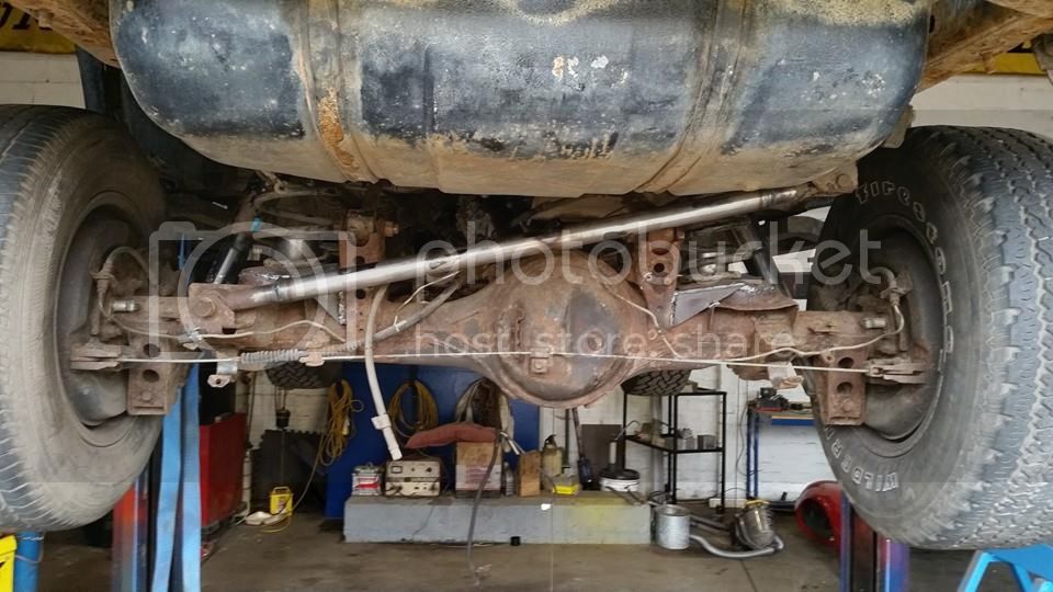

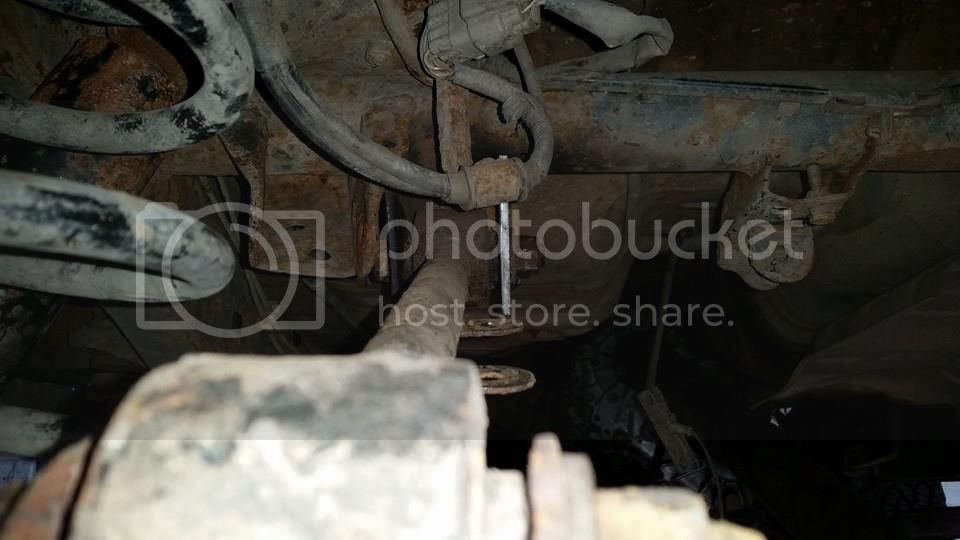

Fitting the rear was relatively straight forward ish. Lower control arms needed to be shortened 150mm, rather than shortening the upper by the 100mm they needed I made new brackets for them on the chassis. Panard rod is a bit of a cobble at the moment. It needed to be shorter than the 80 but longer than the 90 and the 80 one won't fit into the chassis end so I went half and half but will rose joint it and make it adjustable at some point. Shocks were fine and a straight swap over but springs have been an issue.
The 80 rear springs are far to wide to fit in the top spring cups and the front 80 ones I have been using on the back of my 90 are too narrow at the bottom to fit the cups on the 80 axle. Solution was to make some new cups for the axle.

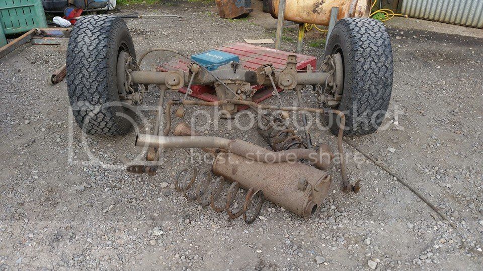

All that came off

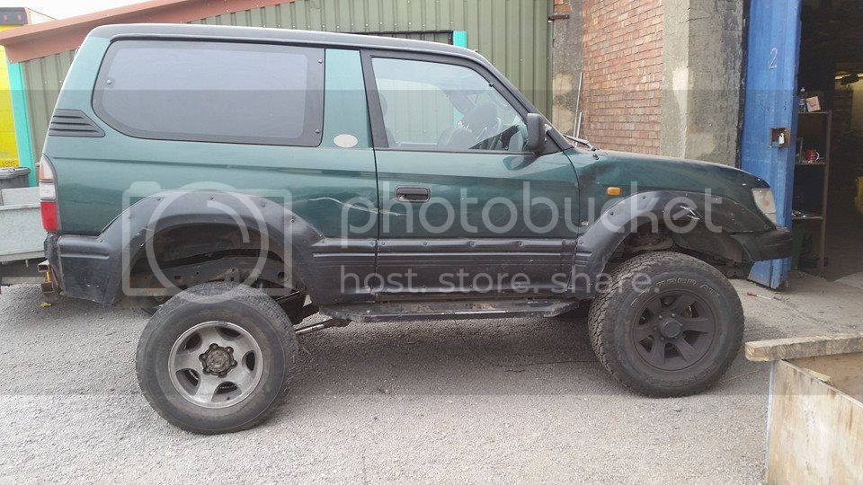

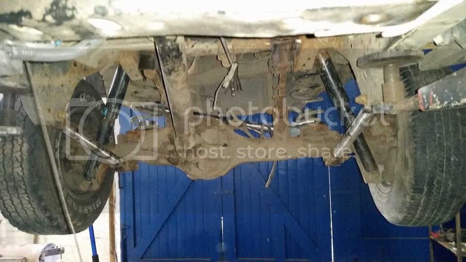

How she sits at the moment
and how she should look after the front is on. (Please excuse the tiny tyre)

Drive shaft angle is fine. I had a similar question on another forum regards the panard. Please bear in mind that the pics have been taken with the truck 5 foot up in the air on the lift so the back axle is sat at full droop.
The 90 is mine and is a manual with the 1KZ-TE. It did used to be full time 4wd but having to swap out the transfer box for a Hilux surf one to get the front prop down the drivers side has ment I will loose that.I actually have the full 80 that the axles came off sat in my yard and you would no believe how hard I tried to get the 4.2 lump under my bonnet but it just would not go. so if anyone has any ideas of which V6 or even V8 I might get squeezed in there I may look at an engine swap in the near future but it would have to have the pretty bomb proof reliability of the 1KZ and 4l plus.
