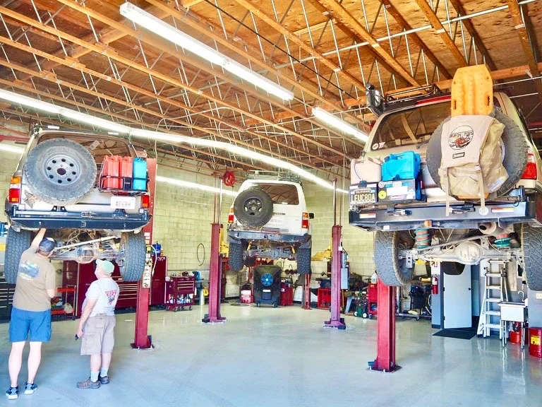

Thanks again Gus for the awesome shop time on Saturday for safety inspections. Lots of stuff learned in the process.

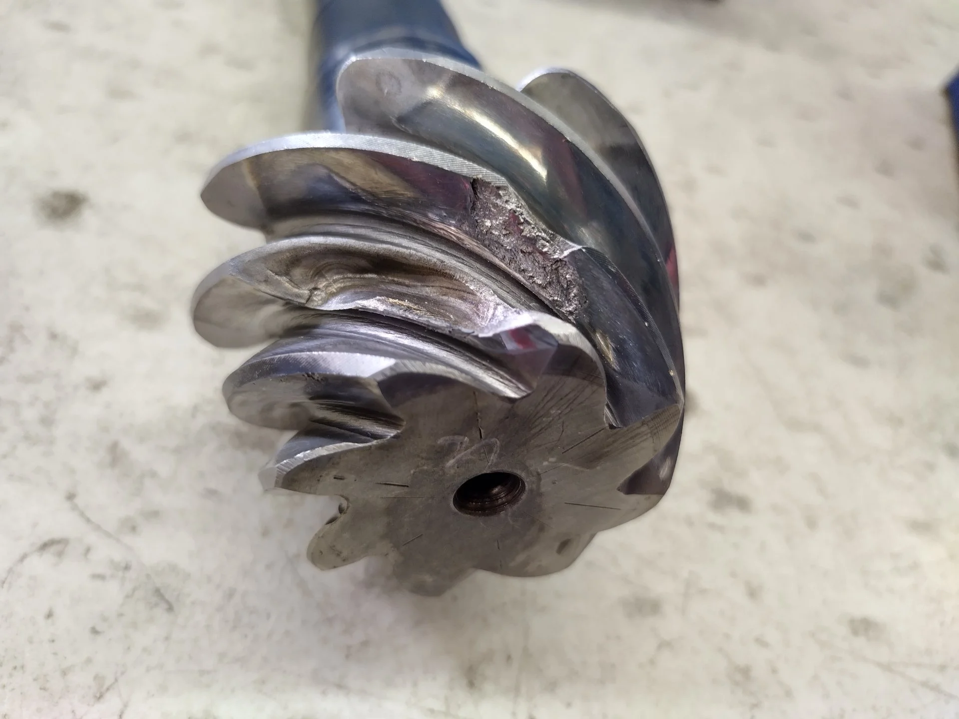

Well I needed rear wheel bearings and a pinion bearing, and when they pulled my 3rd member this came out. It wasnt making any noise (very minimal anyway), but had a tooth completely broken off, which probably caused the chip on the other tooth. So needless to say I had to get another gear set. Fortunately Pro Gear in KM replaced it at no charge and will go after Nitro to cover it under warranty, even though its not technically under warranty. I'm just thankful they were able to source a gear set during these times.
That's why we do safety inspections and have a guys like Gus to help us out.
