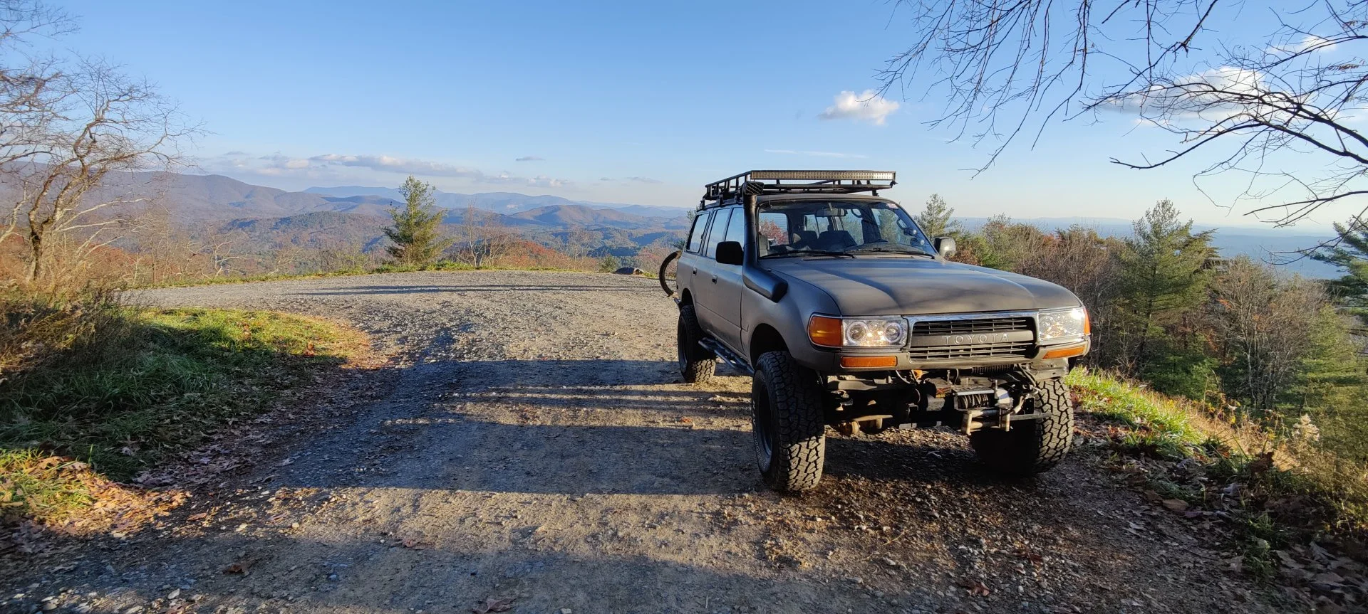

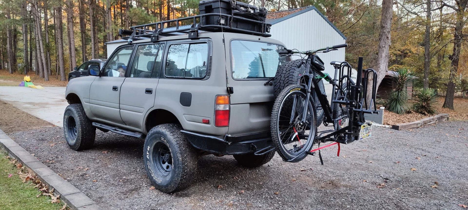

I went on a mountain bike trip to Mulberry Gap in November and drove the 80. It's about 4.5 hours each way. It was a pleasure to drive and scoots through the mountains without any complaints. It is a pleasure to drive on the road and has plenty of reserve to pass cars when needed. I prefer to keep it on the back roads. I've taken it up to 90 mph on the interstate, but it just feels uncomfortable to me at those speeds. I love it at 75 and under. I get 16 mpg running quick trips locally and I can get just north of 20 mpg running 55-60mph back roads longer distances.
Here's a couple of pictures from November with the bike I ended up destroying at Mulberry. I went out and bought an Intense after the 1st day doing Windy Gap. I broke my shifter and the front brake caliper, then I smoked the rear brake.
