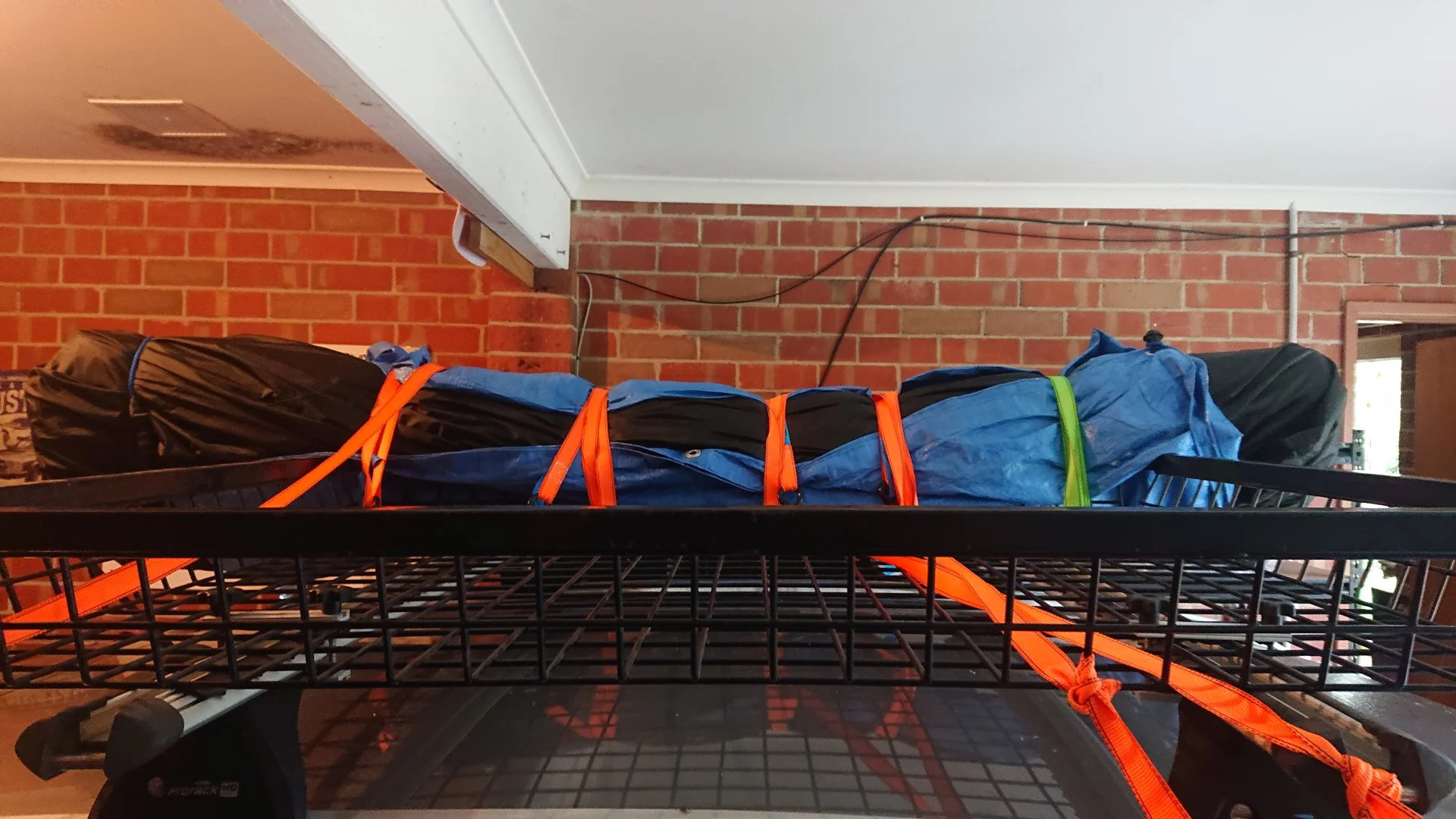

We don't own a 4x4 but we just purchased an rv5 plus and putting it on roof racks of the Suzuki suv.
I've got it strapped into the basket but no bottom support.
Will this be ok or does it need support underneath? It's an 8hr drive on highway.

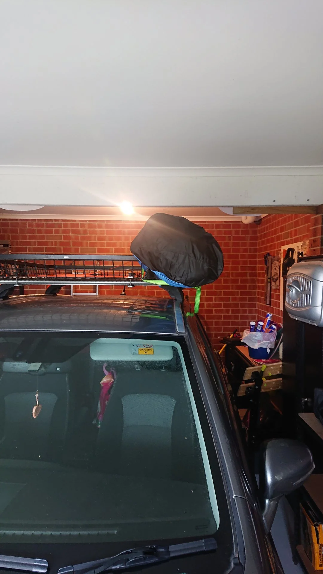

Hey thanks for reply. It was secure as all hell it was the bow in the middle. Roof racks are newish and barely used. It was it had no support under it.
I even added support but it still bowed.

Turn it 90 degrees with the front/leading edge resting on the bottom of the cargo carrier/rack and the rear resting on the vertical portion. Support the suspended section if necessary. Don’t strap down the unsupported portion.
Edit:
And being familiar with the extruded aluminum frame of the Oztent, no, you don’t want to bend it.
+1 on not bending it like that. The reason the OZ Tent is as long as it is in packed form is because that's the length of the metal frame inside. By strapping it down as shown in your photos, you are bending that frame, which will likely damage it.
If you have to transport it on top of that roof basket, I would only strap it down in the two spots where the tent rests on the edges of the basket, and not strap it down in the middle.
A few 2x4s could be easily used to build a rectangular structure that would give you the necessary support in the middle of the basket, under the tent. Or you could use longer 2x4s to provide a flat, level surface between your basket and the tent (which would sit on top of the 2x4s); wouldn't be pretty, but it would work.
