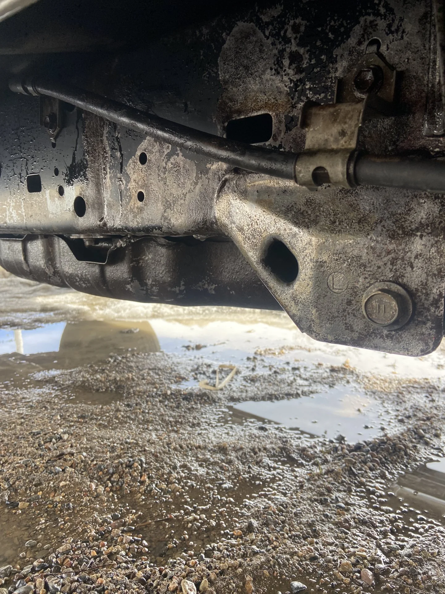

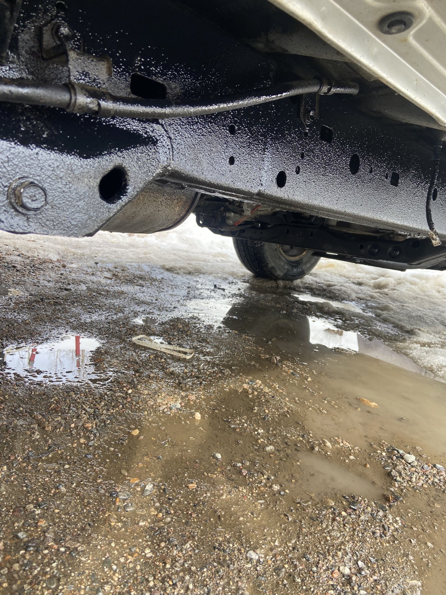

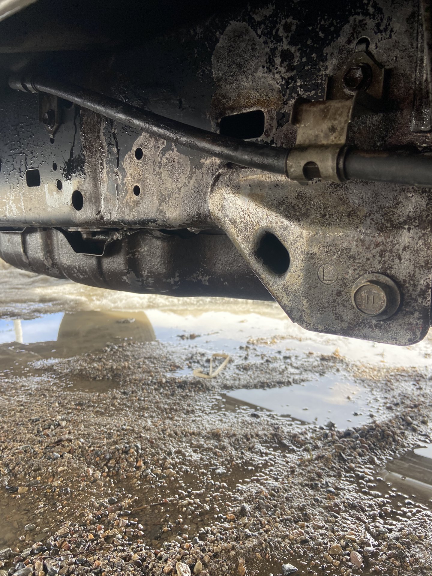

I recently un fortunately purchased a gx470 with quite a bit of rust I didn’t catch. (Purchased in colorado). Went after it with needle scaler, die grinder and some rust remover. Hit it with wool wax black after. Hopefully it holds up for 5 years or so would be ideal. They certainly seem to rust out quicker. Love the vehicle though. Rides amazing. 142k 2003. Putting some sliders and suspension upgrade in soon
View attachment 2942444I recently un fortunately purchased a gx470 with quite a bit of rust I didn’t catch. (Purchased in colorado). Went after it with needle scaler, die grinder and some rust remover. Hit it with wool wax black after. Hopefully it holds up for 5 years or so would be ideal. They certainly seem to rust out quicker. Love the vehicle though. Rides amazing. 142k 2003. Putting some sliders and suspension upgrade in soon
Looks like it was all just surface rust, unless this wasn't the bad areas
Seems like lots of it was surface but at a certain point definitely pitting going on and inside frame had some decent chunks. The front door body mounts were probably the worst but no holes etc. I’ll definitely say needle scalers are awesome for scaling rust etc. not a big mess like grinding, I think I paid 60 for it. Rear axle assembly had decent rust on top tie link connections etc but I got it pretty cleaned up and all that metal seems very think in general.

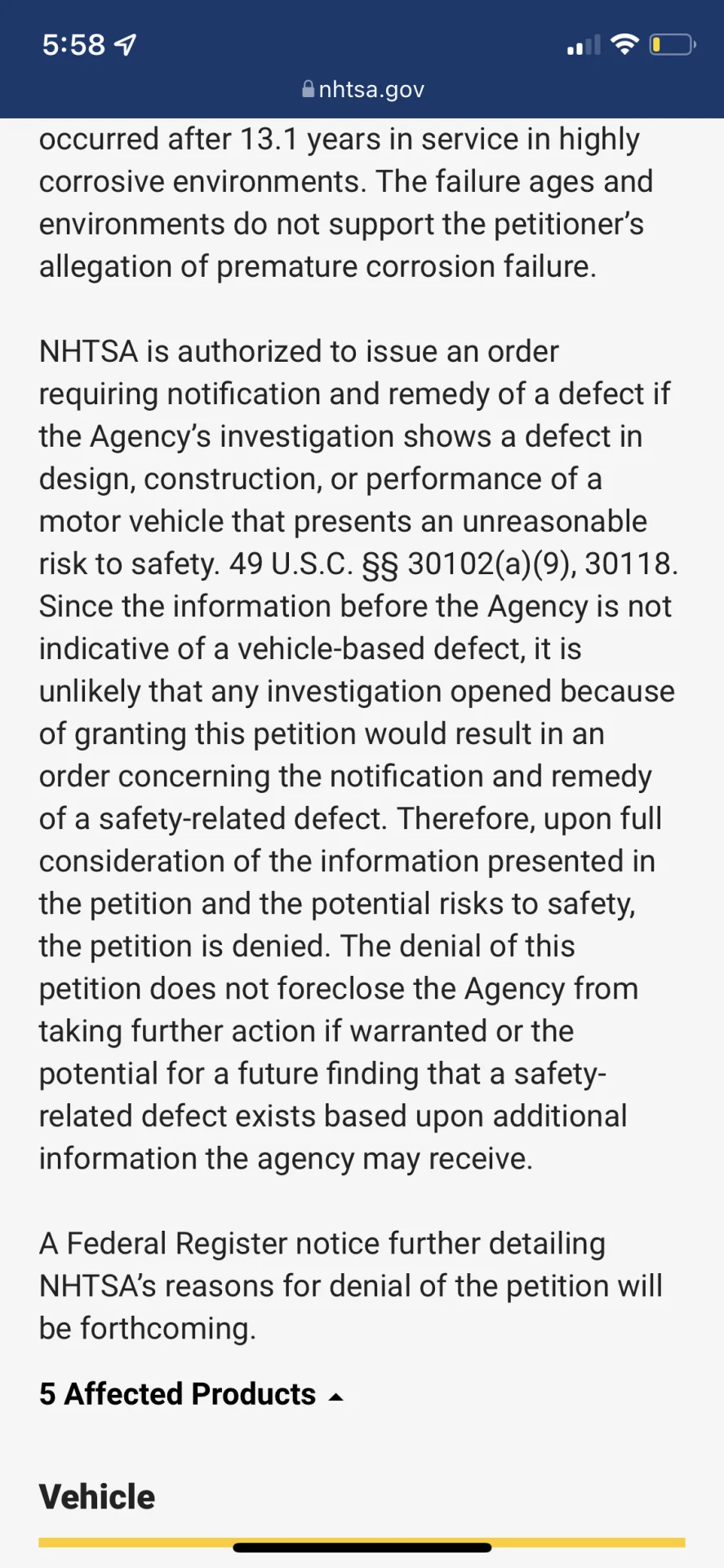

For anyone interested the NHTSA wiped their hands clean after their ~3+ year investigation citing their identified cases of catastrophic failures involved vehicles near ocean front. Which again doesn’t surprise me. I saw in a recent court document dump that the NHTSA denial was presented for the case so that probably doesn’t bode well for anyone crossing their fingers.
I’m not sure if the actual court proceedings are wrapping up but there have been continued updates.
