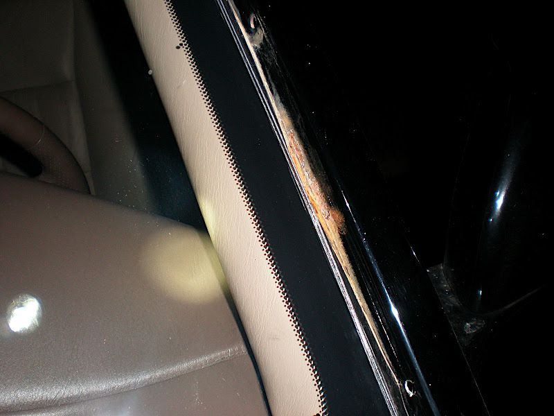

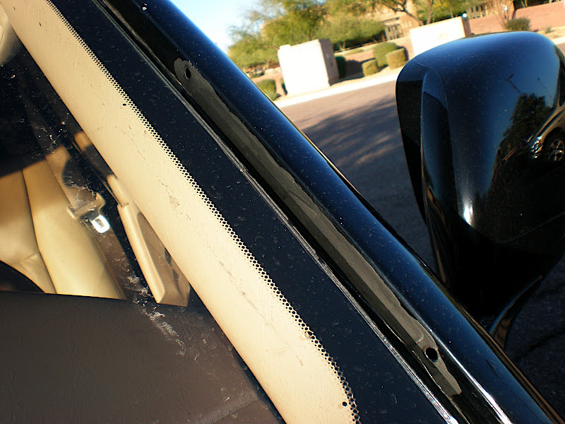

As some of you may know, I recently got the front windshield replaced along with all the trim to get rid of the super pitted glass and crazy-stupid-jokerific install of the previous windshield. Once the glass techs pulled the glass and trim I found a nasty little rash hidden under the trim. Lucky for me the glass company ordered the wrong trim pieces and had to come back a few days later to install the correct pieces. Thus this gave me a few days to take care of the rust on the a-pillar. The scary part about this whole scenario is that this 100 has been in AZ all its life. Specifically here in Phoenix and a few years in Tucson. I am not sure what this would have looked like if it had been a Colorado truck or from another area where rust is a problem. I have concluded that the poor install of the previous windshield contributed to the problem since the trim was not tight and even rattling a little. Here are the pics of the the rust and my fix:
Pics of the rust on the drivers side a-pillar behind the trim:

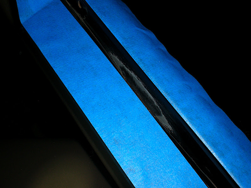

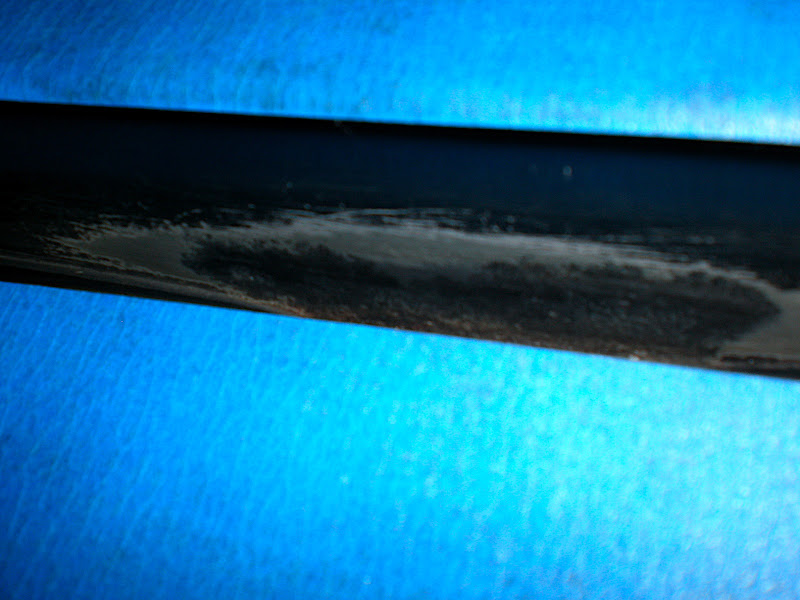

I taped off the glass and painted area I didn't want to mess up. Then used a small wire brush to get rid of the rust down to the bare metal. I then used some mineral spirits with some Q-Tips to clean and prep the area for paint:
I then panted the area with a small artist paint brush I got at the store for about $1.50. I painted with some semi-gloss Rustoleum that I had sitting around. This is completely hidden by the windshield trim pieces when installed so color matching was not a concern of mine. I got 3 good coats on there and allowed them to dry for 2 days before the trim was installed. No more rust!! :cool:
