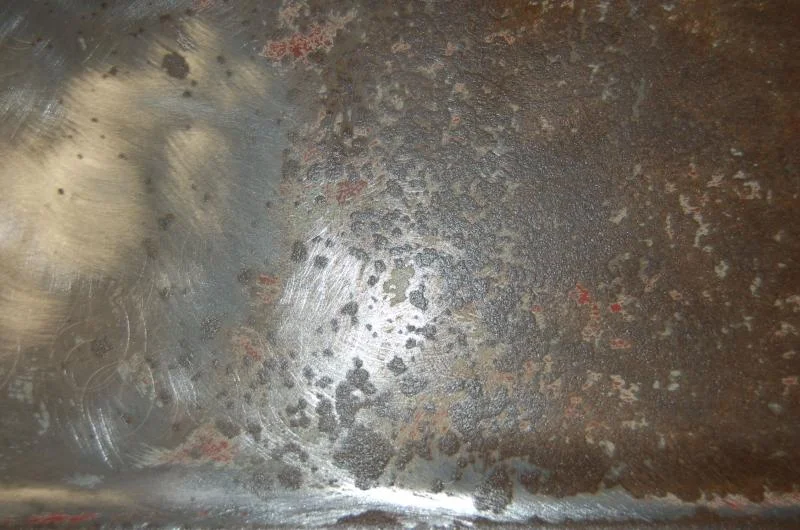

I just started the restoration of my FJ40. The hood is the worst part. It has surface rust. I attached a round wire brush to the end of my drill and have removed the surface rust, now i have 3 conditions...bare shiny metal where paint was removed, paint that has no rust to begin with and a black scale where the rust was removed. What do a do next? Do I have to remove the black scale? or can a built up primer used over the existing surface and sanded? I planned on using Ospho prior to the next step. I want the job to come out good so I am not looking to cut corners. I am afraid to sandblast since the metal panels are thin to begin with. It has the original paint.
Can you post a pic of what you are talking about? I went to google "black scale" and came up empty handed. I have been working on my 40 for the past year and have found that many of the rust inhibitor sites are a wealth of information. Any type of rust you may have on your rig you need to get rid of, whether cutting it out or treating it with a rust inhibitor chemical.
Picture added
Here is a picture of the condition, does the brown scale need to be removed? Or can it be built up around it?
That's just rust, it'll have to come off. Use a DA sander with 80 grit disc, you've done all you can with a wire brush.
