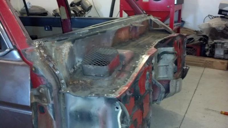

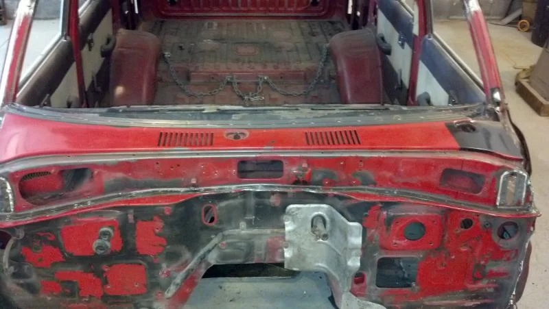

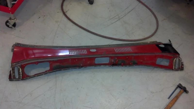

There are a lot of spot welds to drill out on the two side panels. Then there is a ton of them to drill out on the cowl its self. It can be done with a little time and hard work. Good thing that I had a spare body with a good cowl to replace the old one with cancer.
Body Work
Finally decided to take off a week and get some work done on the cruiser. Started some body work, decided to take the cowl off of the red body and replace it with the brown one. This is due to a lot of rust in the a-pillar on the red one. The cowling came off pretty good and hopefully the other one will go back on just as easy.
attachment.php
attachment.php
attachment.php
